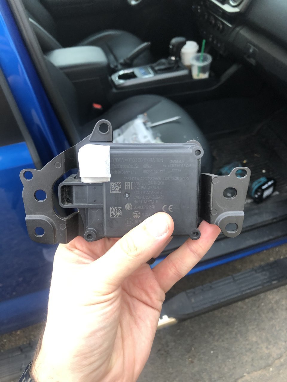

    would you know how they are installed differently? i can honestly say it looks exactly how it did when i handed my truck over to them.
    and how do i know if i have the new style sensor? i purchased my truck back in november 2018, but it's a 2019 trd sport dclb. thank you in advanced!
    edit: after going back out and looking around for a bit, i noticed there was a foam pad installed between the sensor and the grille. if i were standing in the front of my truck looking straight down, i can only see/feel it from the left, but there's nothing on the right side. also, i rechecked my vin to see if the recall was still there, and it is. any idea of if it should be removed from my truck's history immediately, or if it takes a bit to go away?

    The non-pro grilles get a different “fix”, you won’t really be able to see the “seal” for the sensor on the pro grille (from what I’ve heard)

    appreciate the response. i went out and took a photo and it looks like i got the foam buffer pad installed on the left side. i also referred to post #206 and #207 (repair B) and it's exactly what they did to mine. now i'm just wondering when the recall will be removed from my truck's recall history.
    picture of mine for reference. don't mind the sliver of double sided tape on that washer. the screw wasn't long enough to thread into the hole with the washer there, so i just wedged the washer between and put the tape there to secure it. :)
