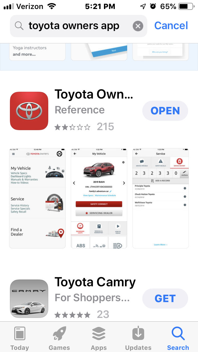

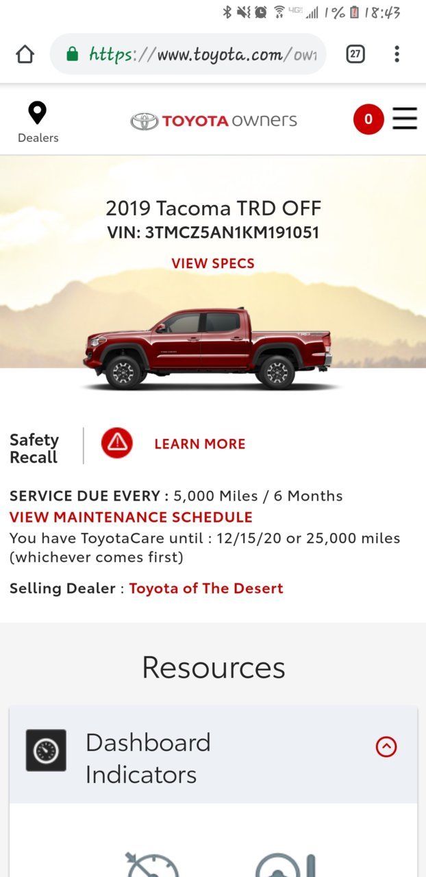

    What toyota owners app are you guys using? Every time I check for recalls on mine it says not able to process at this time. Its been saying that for 3 months now.

    https://www.toyota.com/owners/my-vehicle

    Yes. This will also work. Not all like the POS app.
