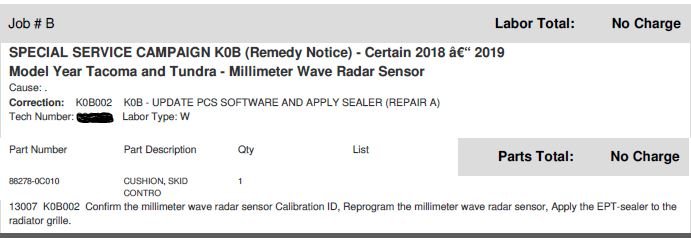

    Just got back from the dealership. I was hoping they would replace the radar unit since I had been having issues with it when and a day or two after heavy rain. The service writer called to tell me the recall had been completed and they HAD changed out the radar unit for a new one. I asked him to show me on the paperwork where it indicated that the unit had been changed out. He pointed at the Job B section and said, "Right there". I left with my truck and inspected it afterward. Turns out he lied about the unit being replaced. Can't say I'm surprised, they have a history of lying about things they say they did. But that's a whole other topic...
    Ultimately I'll be happy when it rains again and the PCS doesn't act up. If it does, I'm going to return and demand they replace the unit - hopefully by then, the so called updated designed unit will be out. In the mean time, I wait for the next rain.
    Here are pictures. By the looks of it, they added a cushion on the top half of the radar unit. Hopefully that solves the problem :fingerscrossed:

    Interesting "fix" & thanks for the info!
    Probably will do the trick. It's kinda like an awning for your sensor! :rofl:

    Yes, it is. Funny thing is, when I was still getting the faults after the initial radar unit swap, I thought about making a cover for the back side on my own that would have basically done this exact same thing o_O
