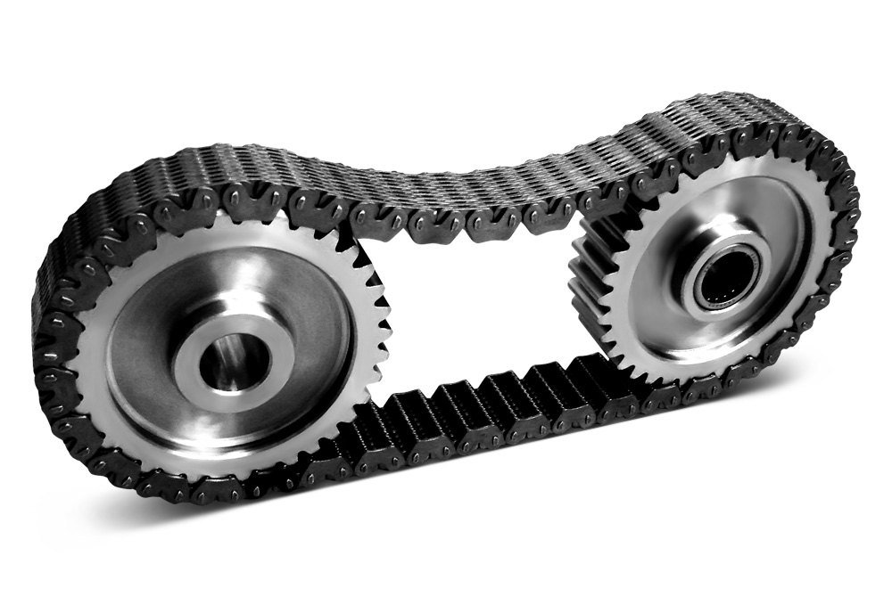

    For no more than you drove it you'll be fine. Most everyone who has a 4X4 has forgotten to switch back to 4X2 when they get back to pavement and drive a short distance engaged. But I don't recommend doing so by design. The damage is cumulative. You get a few miles before the damage starts showing up and it is often the next owner who ends up paying for the damage.
    Technically, if driven in a straight line, or even gentle curves it won't cause damage. The danger is getting distracted and forgetting you're in 4X4 and then making hard turns into a business or driveway. Even then it would be rare for a catastrophic failure at that moment, but as stated earlier you are causing excessive wear that will show up somewhere down the road.
    In rare cases you can break U-Joints or front axles when they bind. But most often you stretch the drive chain inside the transfer case. Once it stretches to a certain point it will start slipping on the gears when your truck is under load. This takes some time and a lot of guys don't have any idea they are damaging components until the chain starts slipping.
    The reward of driving on pavement in 4X4 isn't worth the risk. It ain't that hard to find a road with gravel or loose dirt to get in a few miles of driving each month in 4X4. And wet pavement isn't much better than dry pavement.
