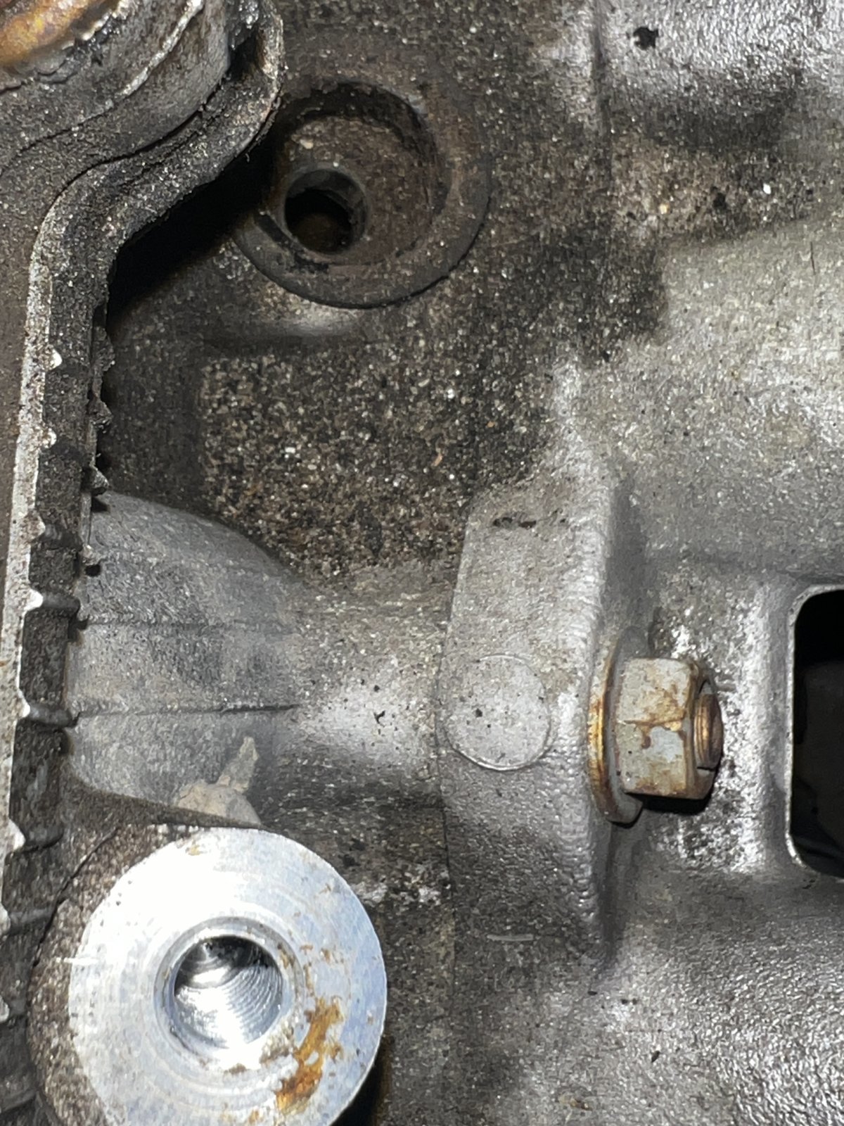

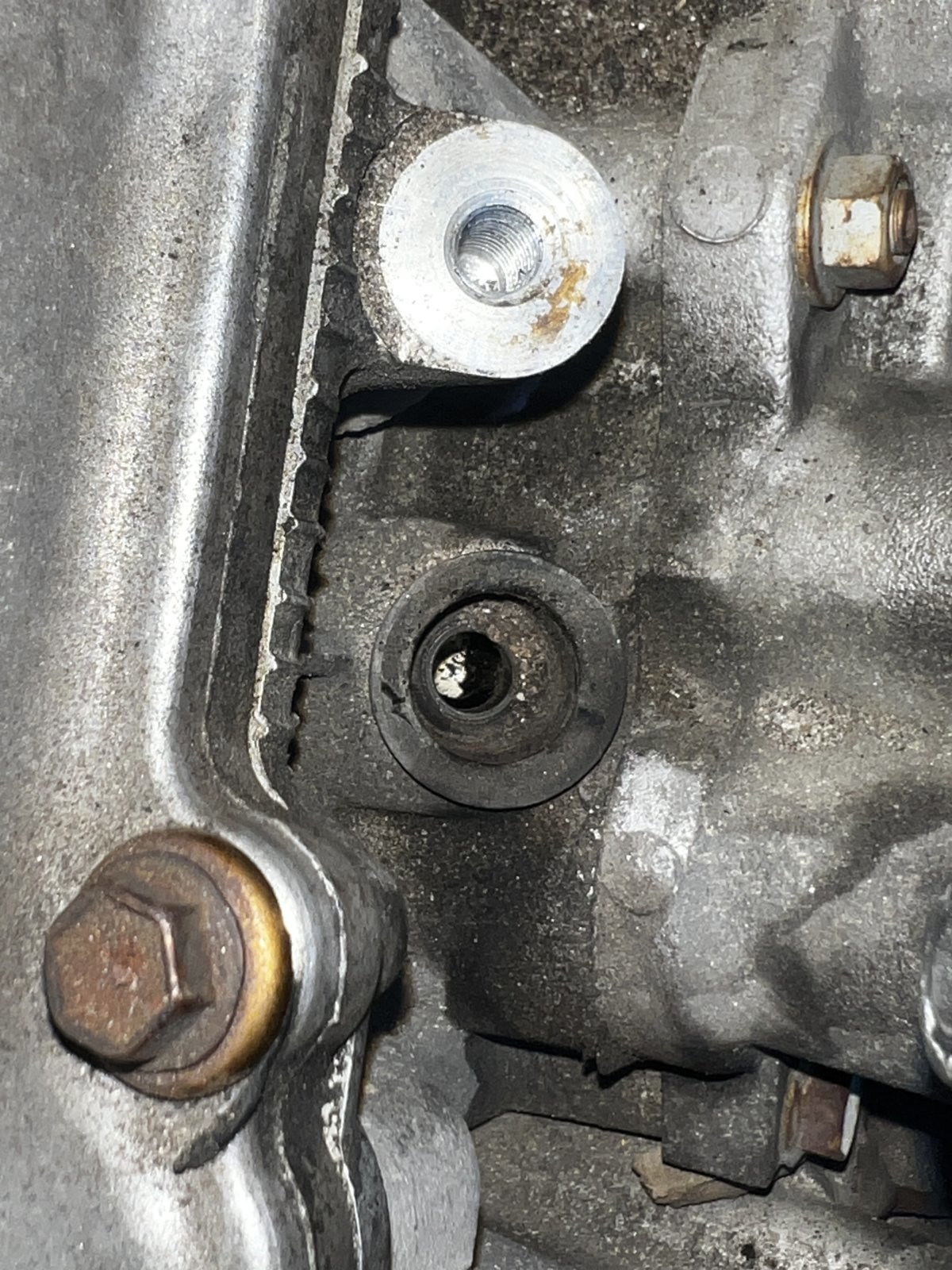

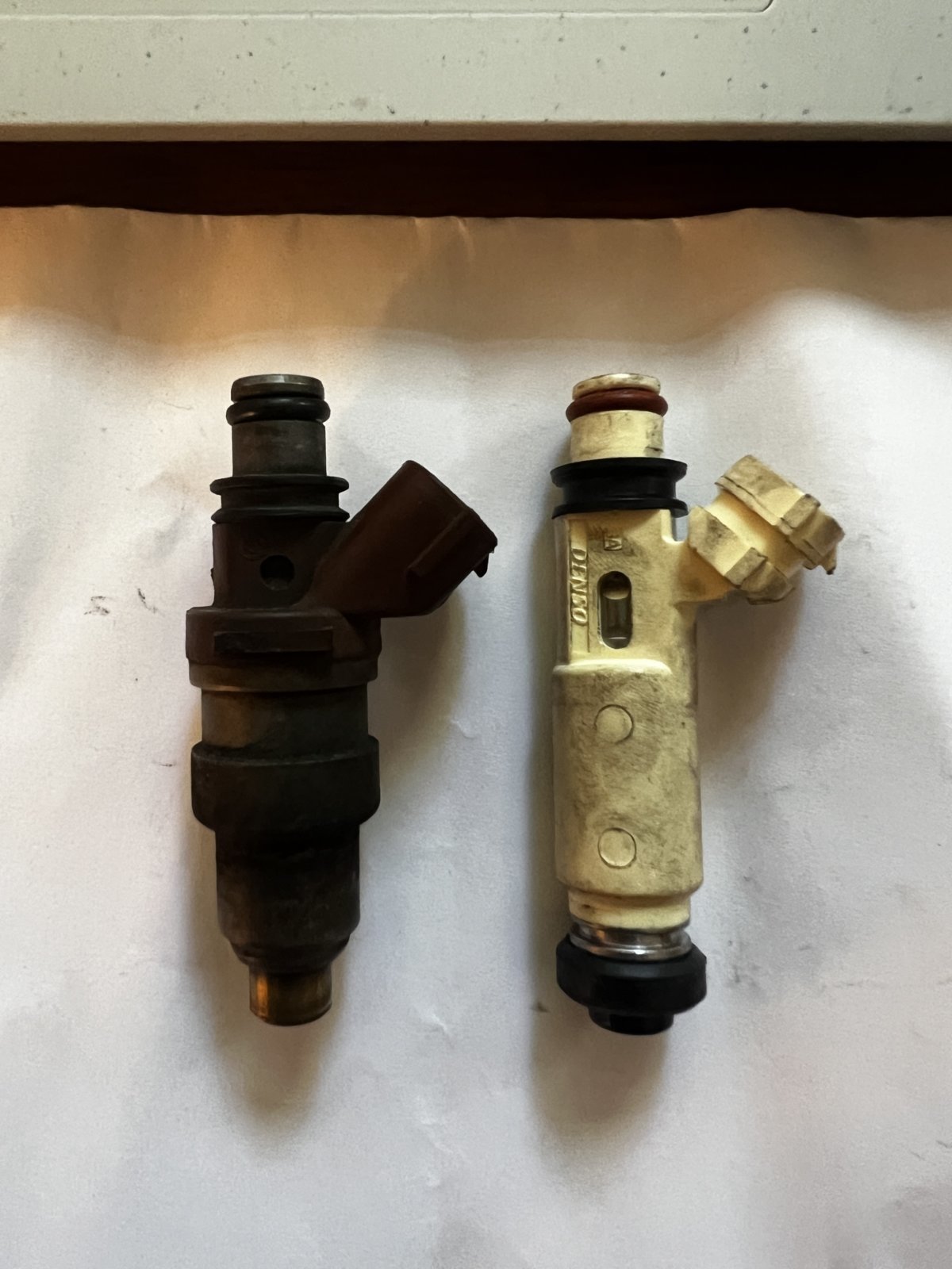

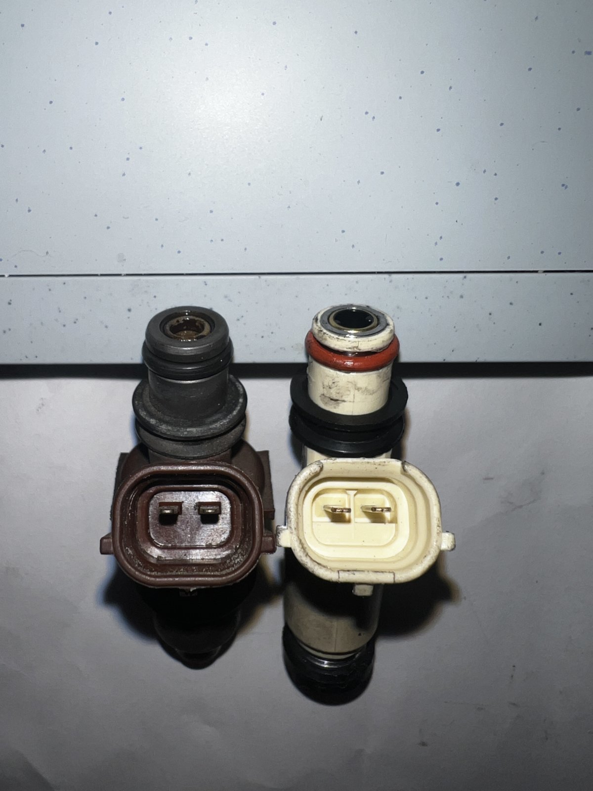

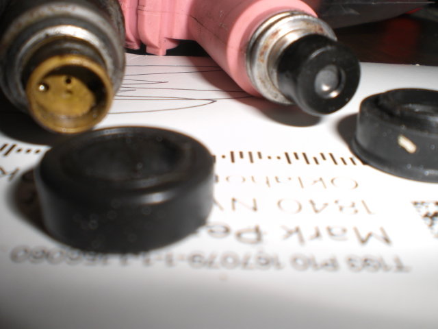

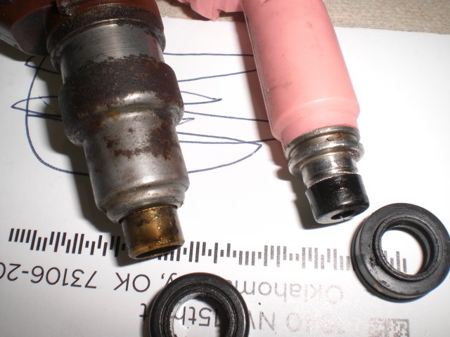

    So I have hit a slight road block....
    I have the fuel rail out (pain in the ass). and I pulled the old injectors. They appear to be a different type. Generally they are the same, but the new ones have a different taper and are slightly taller.
    I'm hoping someone here can give me some insight. Am I supposed to pull the old gaskets out of the ports and just pop these new ones in? I'm thinking this is the case because the old ones don't have an O-ring on the bottom, but the new ones do:
    This is the old and new side-by-side comparison:
    These are the "cup" gaskets still in the intake port:
    The new injectors connect will with the wiring harness. But don't seem to seat properly with the new bottom o-rings trying to mate into the "cups"
    Appreciate any insight.
    In a holding pattern until I figure out if i bought the right injectors or not...HA!
    Also, any experienced input on making this easier will be helpful.
    Ended up not removing the intake or throttle body, but had to do a lot of fenagling to wiggle the fuel rail out.
    Happy saturday!

    After looking at them...It looks like the old grommets are stuck down in the insulator cups...i guess theres only one way to find out.
  15. Jun 8, 2024 at 9:07 PM
    ControlCar
    ControlCar My Moto: Help & Learn…period.
    Jul 22, 2023
    #429578
    3,431
    Steven
    Sugar Land TX
    1996 Taco 2.4L 2wd Automatic
    Clock Volt meter/LSPV Delete/Hyundai 16’s/FP gauge/after 9months of wrenching ZERO oil leaks
    Just like old silver told me…..
    you need new cups!
    $24 from LCE
  16. Jun 8, 2024 at 9:11 PM
    #16
    ControlCar
    Jul 22, 2023
    #429578
    3,431
    Steven
    Sugar Land TX
    https://www.lceperformance.com/Prod...MI15-16dLNhgMVhG5_AB3y5gCmEAQYASABEgJFpfD_BwE
    I was 50/50 on changing mine
    OS told me about a member that was fighting a vacuum leak CE lite
    He discovered that the brittle cups were cracked, sucking in unmonitored air
    That sold me
    there is a thread of mine with pix and a homemade tool to extract those cups
    GL
    I sent my old crusty injectors to MotorWest…..$125 including a core charge (bc one of mine was so bad)
    No issues
    THatt likes this.
  17. Jun 9, 2024 at 1:15 PM
    #17
    O'Silver_Taco
    O'Silver_Taco Well-Known Member
    Aug 26, 2021
    #375390
    4,183
    MD
    98 Dlx Sr5 ext AT Rwd
    3rz to 2Rz bebuilt block and new heads
    No you dont have to have new cups...thats crazy...
    only if they're old and cracked....or compromised from gasket leaking around it...
    those are of an ethyl plastic.....super hard.....more likely to crack from over heating or something ........but not likely just from over time.....
    Usually what happens is dump ass move like me....leave one of those old gaskets in by mistake and see what happens.....
    that one will seal great........the others will others will to proceed to wash the side on your engine...

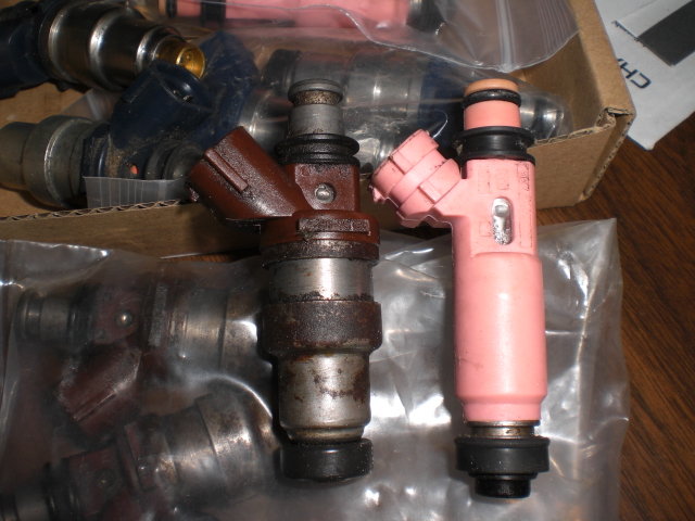

    Boy if you want to talk injectors.....have I got injectors...
    at least all the oem ones after 97
  19. Jun 9, 2024 at 1:35 PM
    #19
    O'Silver_Taco
    Aug 26, 2021
    #375390
    4,183
    MD
    The brown '2-sprayers' came on 98 2rz's...matsushita's
    The pinky's are 2000 3rz 'micro sprays' .....denso's
    Only real rule would be they all need to be same year and height so the rail mounts even and level...

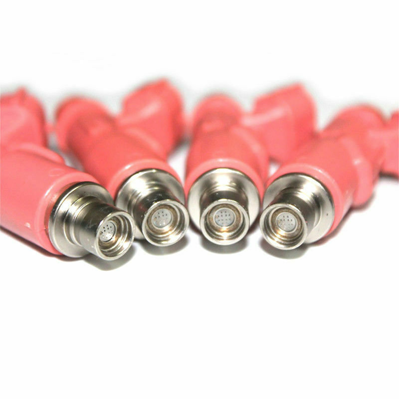

  20. Jun 9, 2024 at 1:41 PM
    #20
    O'Silver_Taco
    Aug 26, 2021
    #375390
    4,183
    MD
    Notice the tiny holes in the 3rz's........
    which means they will clog.....eventually
    not run forever like the older ones....
    That's what they call progress .......for an extra 1/10 mile a gallon.....
    but only these can be made watertight for TRD applications
