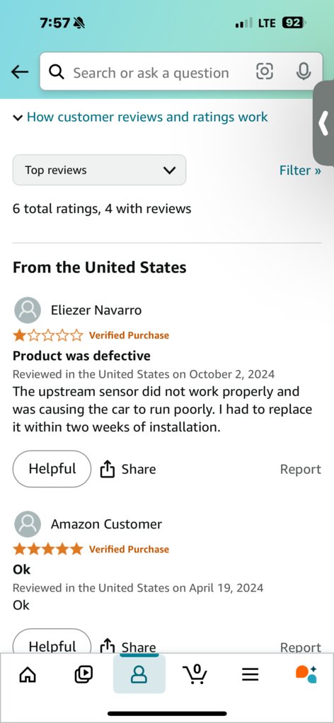

    * note for anyone chasing an acceleration stumble and erratic idle without a CEL check engine light. I had previously bought front & rear combo oxygen sensors from Amazon. The truck drove horrendous with the symptoms listed above. Felt like an EGR stumble from back in the 90s. Finally took to a shop and they unplugged the front 02 sensor and symptoms went away. Went back together with a Denso sensor. Truck purrs like a fat cat now.

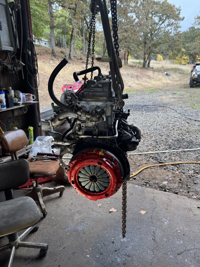

    New rebuild with LC street pistons, Spool rods, Stg 1 cams, balance shaft delete, +1mm valves & ported head, LC 35lb flywheel & clutch, all reciprocating bottom end balanced to 1 gram, previously goodies reinstalled Thorley Tri-Y header, LC bored throttle body, LC underdrive 3 belt pulley, billet crank gear for the timing chain. Now the Osidetiger 18 hole injectors.
    While truck was apart we dumped the Volant dust/hot air intake and plumbed in a stock 3rz air filter box to the elbow in the fender then sealed all the connections so engine is fed air from the snorkel I had previously installed during body work and a paint job. Stock style Bosch paper air filter.
    The older I get the less I like cold air intakes and K&N style filters. I want zero chance for dust to enter this engine.
    We also installed the Total Chaos lower ball joint conversion and new Moog greasable tie rod ends which were flipped to top mount during the conversion.
    For comparison the old worn out 3rz came up our hill @ 25mph and now after engine with 700 miles and mostly broke in come up the hill @ 50mph.
