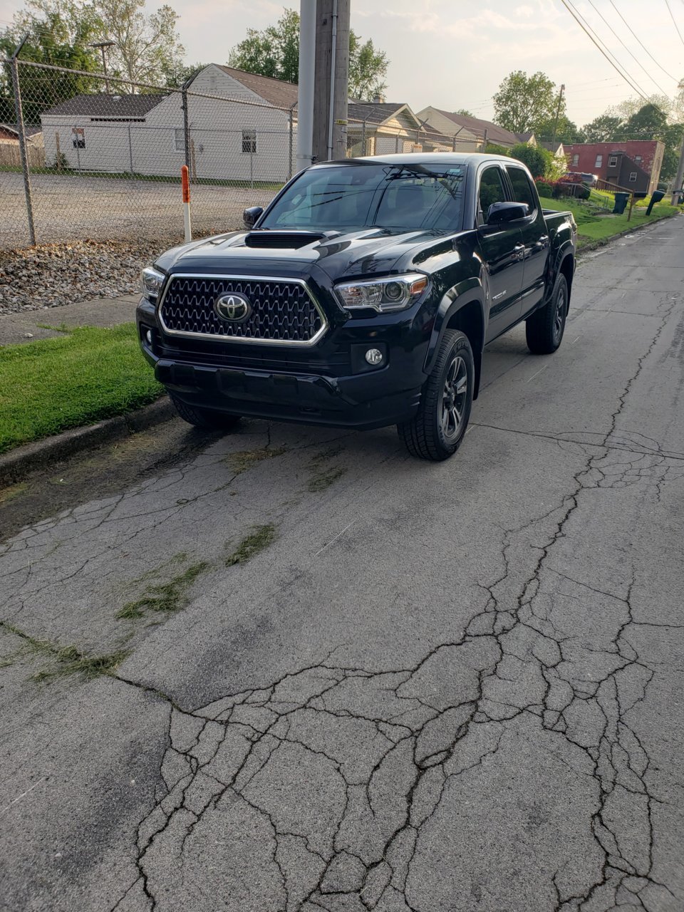

    I just bought my first new vehicle. 2019 Tacoma trd sport 6 spd manual. Traded in a 16 tundra lifted 4 inches on 35s. I'm wondering about lifts, how big is too big for the Tacoma? I'm thinking 4 inch suspension and 33" tires anyone else do this? Can I go bigger?
    Fyi, I am in central Indiana.

    Welcome aboard:hattip:. Lookin good:thumbsup:. Here's one to ya:cheers:

    Welcome to TW... If you want to lift over 3 inches you’ll need to do a drop bracket lift, which means you need to cut a section out of your cross member. If you do it right you shouldn’t have any problems,I’ve had a 4 inch D/B lift for almost 2 years now and have had no issues.

    Most here will say go with a more functional setup for a lift, coilovers, but limits you on the height, though you can still run 33's. I agree with going the 3'' route, but everyone's taste is different, a 4'' lift would require a drop bracket, I know BDS makes a decent kit, welcome and congrats.
