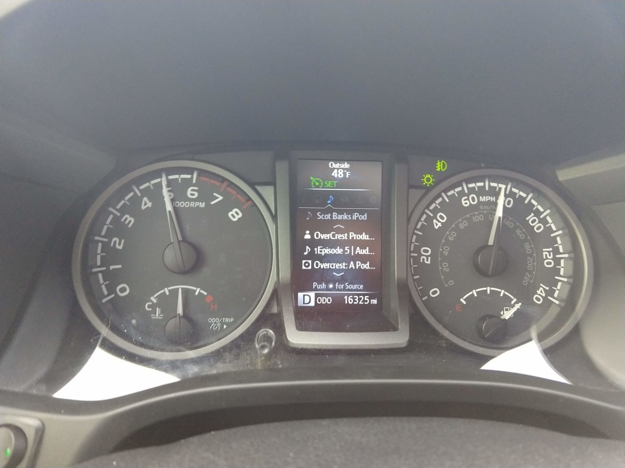

    Got to bring the rpms up to the fun zone. Do not low rpm lug these V6 engines. If you do lug the truck, it learns your driving style and it will always be shifting.
