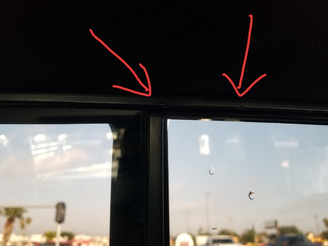

    Finally bought my TRD offroad I've wanted. New to me 2016. Day 3 owned and I get smacked with the passenger floorboard leak. Cleared AC drain line but it was fine before. Third brake light I'm not sure about. No water in back, headliner is fine. Just water pooling after rain in Passenger front. Chasing this leak is driving me nuts!

    Pulled cabin filter too. It's bone dry. All components under are dry as well. I check ac vent, roof drain (appears fine), only think I can't check is brake light.

    No moon roof. After getting into the back window I found what looks like a spray sealant overspray in an attempt at a cheap fix. I'm thinking it's the back window seals. I'll dig tomorrow. I called dealer and they want me to bring it in and try and make it right for me

    Update:
    Well after crawling around the truck I noticed what looks like flex seal overspray beneath the back window. The previous owner may have tried to do a quick fix situation. I called the dealer and they are going to look at it for me. The back window now leaking would make sense seeing that evidence there. Hopefully they will test it and fix it for me

    That's it! I found it today. It's the 3rd brake light seal. Part is $148 and labor is $120. I'll prob just do it myself.
