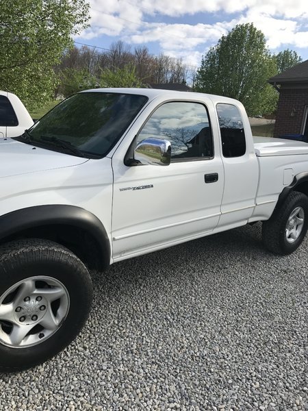

    IMG_0124.jpg Yes I have a gut feeling Toyota is not going to help. Understandingly so. My dilemma is whether or not to fix it, sell. Really like this truck, my first Toyota truck, but not first Toyota. I'll post my decisions as I decide, great discussions here. Will give dealer a shot though, can't hurt
