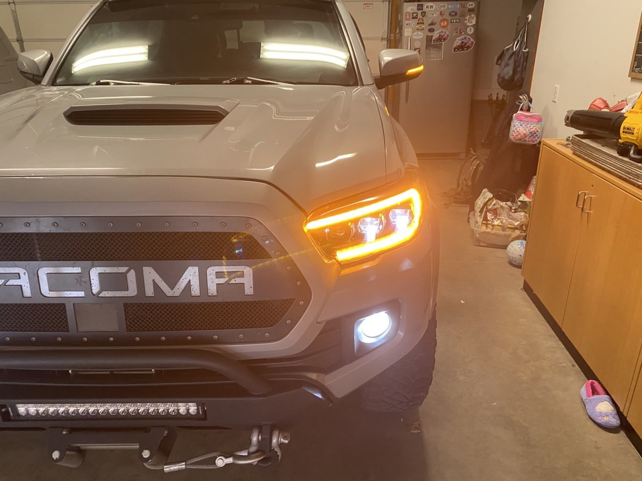

    Newly purchased 2018 Tacoma TRD sport. It already has new headlights. I believe morimoto based off my research. The driver headlight has amber blinker lead but passenger doesn’t. It appears the previous owner didn’t finish installing the cabling. The connector on the passenger is missing the attached pig tail connector. I moved the cable to passenger side and then all worked as it should for passenger side but of course driver side stopped working. Any idea where I can get the pig tail? Thanks !

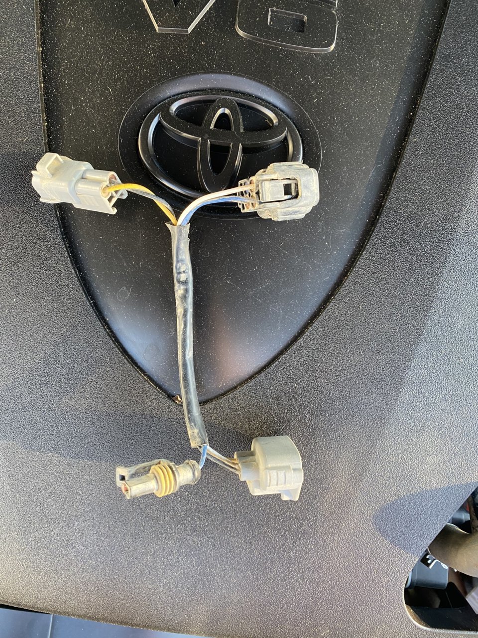

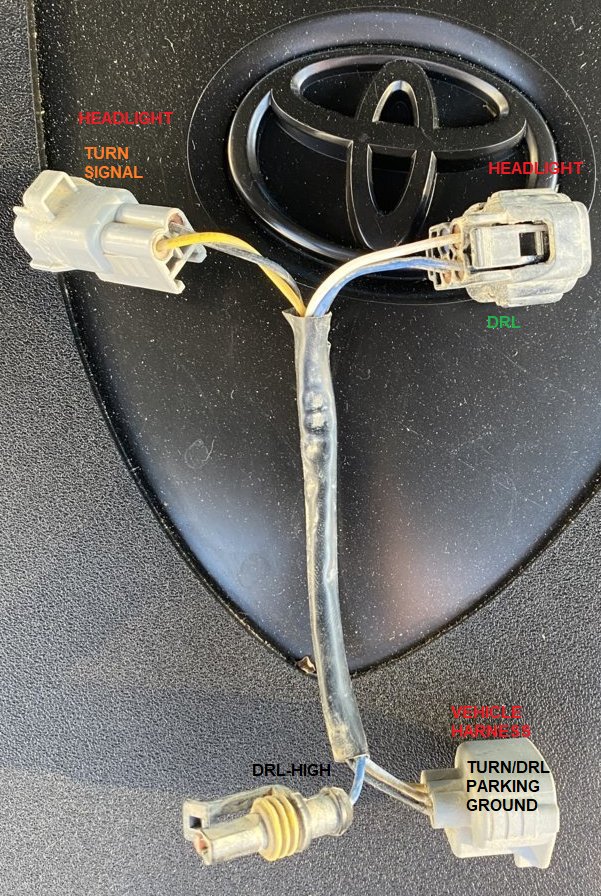

    My guesstimate on the harness:

    I believe you are correct on your guesstimate. Any idea where I can find a cable like this? I need it for the side that is missing it.

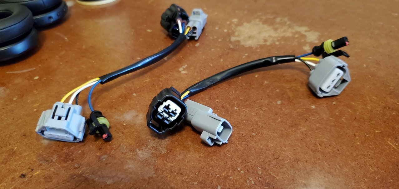

    They look like Morimoto xbs. This is the harness they gave me with mine

    Ok great! That’s the one I need. I’ll see if I can get in touch with them and order that part. Thanks!
