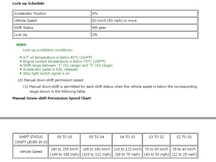

    Thanks Brad. I live in a hilly area and the trans needs to shift a lot . I think I will be using the S mode more often from now on . Everything I have read is if the trans shifts a lot , it is not good . What I am concerned about is if the trans torque convertor cannot lock up in S mode, this may cause more heat than the extra shifting in D .
    Do you think the trans would run cooler in 4th with higher RPM's than a lot of shifting between 4th and 5th ? There really should be more info from Toyota on this .

    Lock-up is prohibited from S1-S3.
