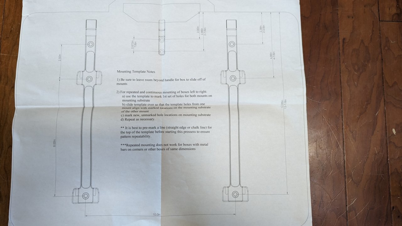

    Unfortunately, the spacing on the ribs is off by about a half inch to allow the spacing to work. The packout mounts come with a template that states the screws need to be 10" on center. I imagine Toyota used metric to lay out the floor ribs.

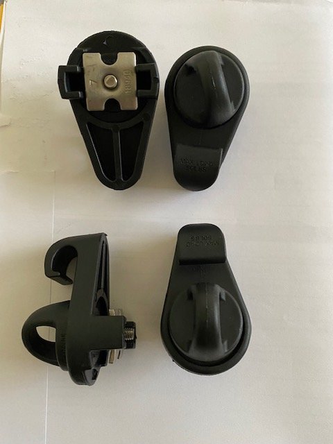

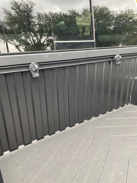

    Jay
    2023 Offroad
    I like those rail cleats. What are they?
  10. Apr 26, 2023 at 5:58 PM
    RIX TUX
    RIX TUX no ducks given
    Nov 16, 2021
    #382343
    5,560
    2022 TRD OR DCSB 4WD..66 MUSTANG V8
    toyota 2nd gen style
    metal back is square and not rounded like 3rd gen so looks like its stronger and has to be slid on from the end.

    The packouts will remain stock. They have cleats molded on the bottom that slide into tabs on molded on the lid of the packout they stack onto. Because there's such a robust mod and after market community for the packout, you can find mounting plates or mounting rails like in that Etsy link. These aluminum rails will be mounted to the bed mat (or bed floor, but that seems impractical). I have the mounting rails. I'll go a mock up some pictures to give you the idea later tonight.

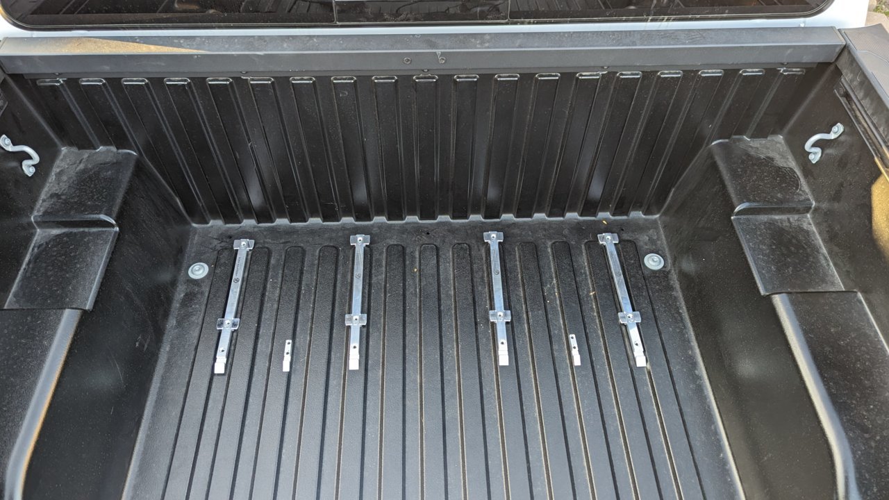

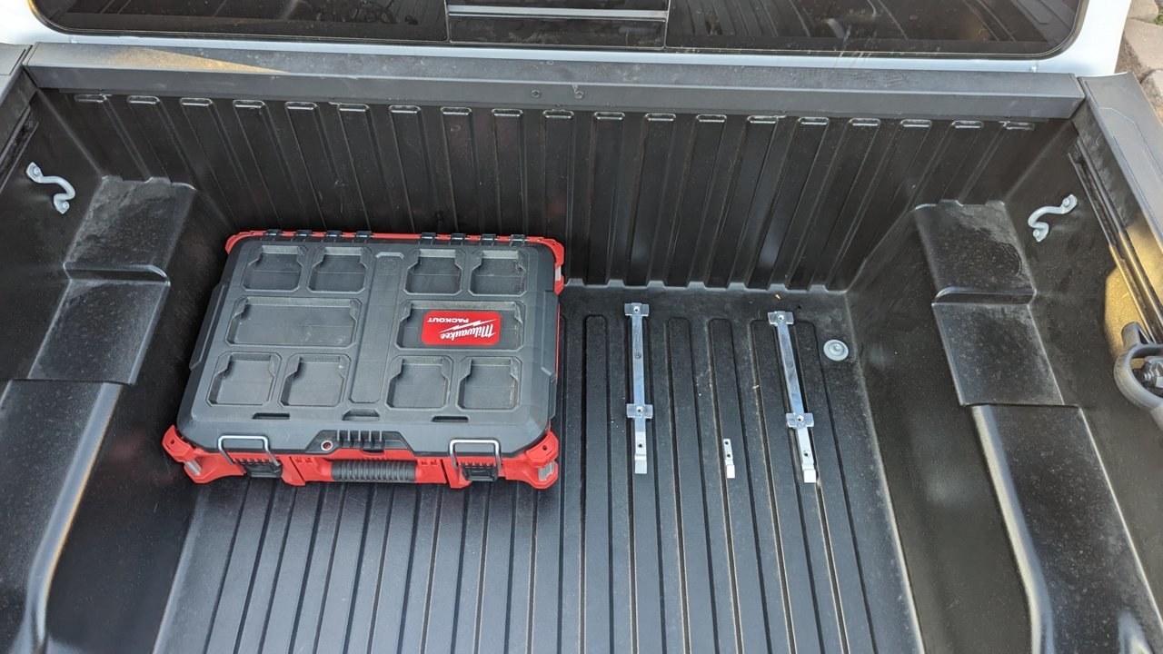

    This is a rough mock-up with a small toolbox I had handy to give you guys an idea.PXL_20230427_011238276.jpg PXL_20230427_011310427.jpg

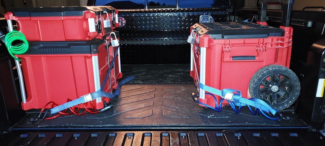

    Here's how I 'mount and secure mine'...

    Doing the mockup makes me wonder if I shouldn't put some XL tool boxes and go with a roll-up cover like the BAK revolver
