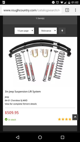

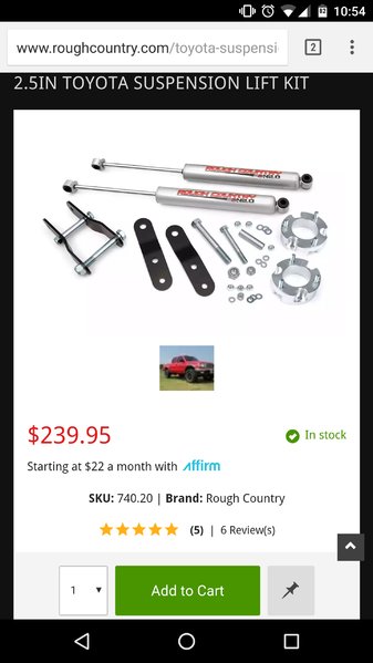

    On my Jeep I had a 3 inch suspension lift kit from rough country. It completely replaced the back leaf springs (not add a leaf) and front coil springs. The only kit that Rough country has for my model Tacoma seems like it doesn't do anything to the suspension but put a block in the front and a d different attachment point (shackle?) For the back leaf springs. While this will raise my Tacoma it won't provide any sort of suspension upgrade like the lift for my Jeep did.

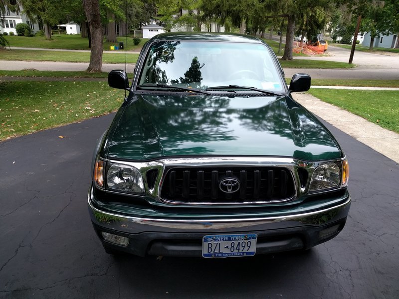

    ------at least that's the way I see it. I've attached pictures of the two kits (and a picture of my truck) can you all tell me if my thinking is correct or flawed?

    Welcome to the site. Do you have a budget in mind? I'd skip the Rough Country and go with these.

    I haven't heard many good things about the Rough Country kits, if youre looking for a quality budget lift I'd go with Bilstein 5100s or OME struts with OME coils, and AALs or new Dakars in the rear. If money is no object then look into King, Icon or Fox setups. Welcome!

    $500 is a tight budget for a good suspension lift. May just have to go with 5100s all around and a single AAL in the rear. Hopefully have enough left over for a set of OME coils, 883s maybe. I think that may put you at closer to $700 though. That's assuming you can install it yourself, having a shop do it will run you at least another $300.
    The stock TRD suspension on the first gens is adequate but you can do much better. Keep in mind, 5100s are essentially the same setup as the stock TRD suspension only you can adjust them for lift.

    That's why I liked the rough country kit for my Jeep, complete suspension upgrade at about $500

    If budget is tight, I'd just do a complete Bilstein 5100 set up with an add a leaf in the back light someone has recommended. Though replacing the front coils as well is a good idea but not required but pre-loading the front coils with the 5100's can resort to a stiffer ride. BUT if you're just looking to level the front end, the 5100's can be set to the middle setting (1") and add a leaf will not be needed. Total for a set would be about $350ish. Get better tires (265/75r16). This set up will not only ride better than stock but also looks good.
    If I was doing it, I would go OME 881 coils (about 2" lift), add a leaf, Bilstein 5100's. This would be about $600ish. If you want to do the labor yourself, I recommend getting the assembly which is just an additional $100 and put you at $700ish. Not hard to do at all with the coils assembled.

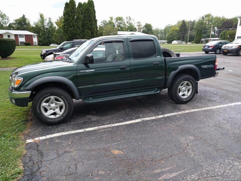

    Level the front end? It looks pretty level right now.

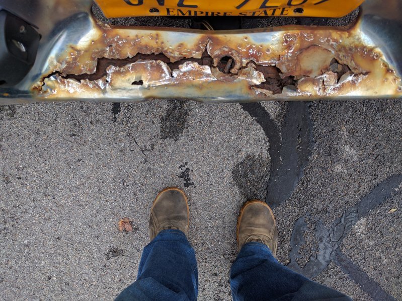

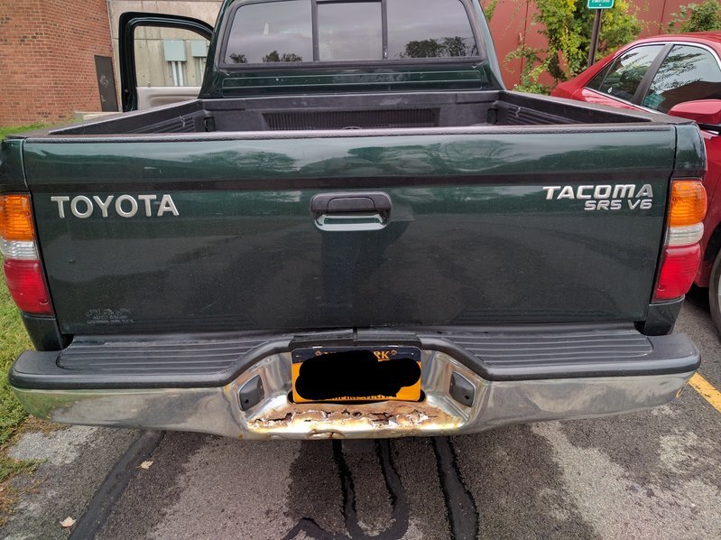

    Looks and actual measurements can be deceiving. Looking at your rear bumper with that rust, I think you can have bigger problems. Did you check your frame for rust?
