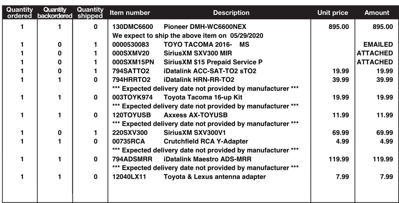

    I ordered mine from crutchfield. They gave me ZERO installation stuff. No wire crimps, Nothing!

    If you buy all of the necessary maestro parts it is minimal wiring. Maestro site is very user friendly for downloading the firmware to the maestro rr. You will need a handful of red butt connectors, strippers and crimps. If you buy the 6600 you can even use the pictures of the side to set up your brackets. Will need a drill and drill bits

    None of it was free, they just told me everything I needed and gave me the option to select it and order it at the same time. The only 2 things that were not included in what they offered was the sxm tuner and the gps/satellite adapter but a quick call and they had me hooked up with the correct adapter. I already knew about the sxm tuner, it was one of the offered accessories.

    You will need all of the idatalink maestro parts. If you put your truck info into their website and select all options correctly. It will show you all the parts you need!
    Maestrorr or rr2
    Maestro T02 harness
    Radio antenna adapter
    Oem gps adapter
    Usb to oem USB adapter - if u want to retain the one in your dash
    And ( some kind of bypass for the video)
    If u want to be able to watch while driving. I am still looking into this. There is one advertised on eBay and I am waiting for the seller response. I tried the one from my last unit which was still a (NEX) series but it did not work
    you can also write down all of the part #’s and search for them from Amazon, eBay, etc...
