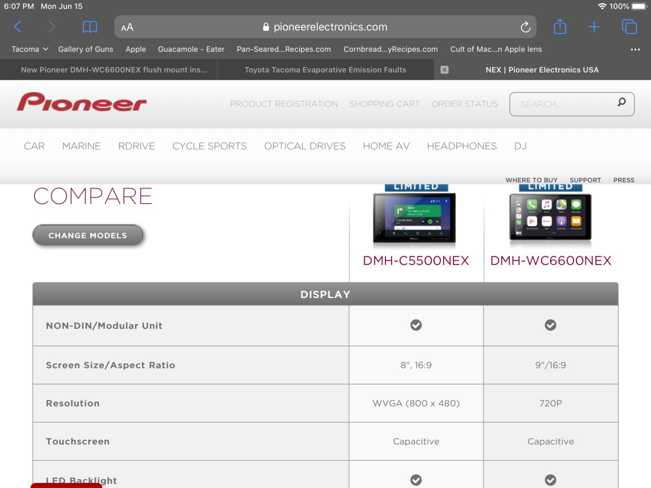

    It’s on Pioneer’s website.

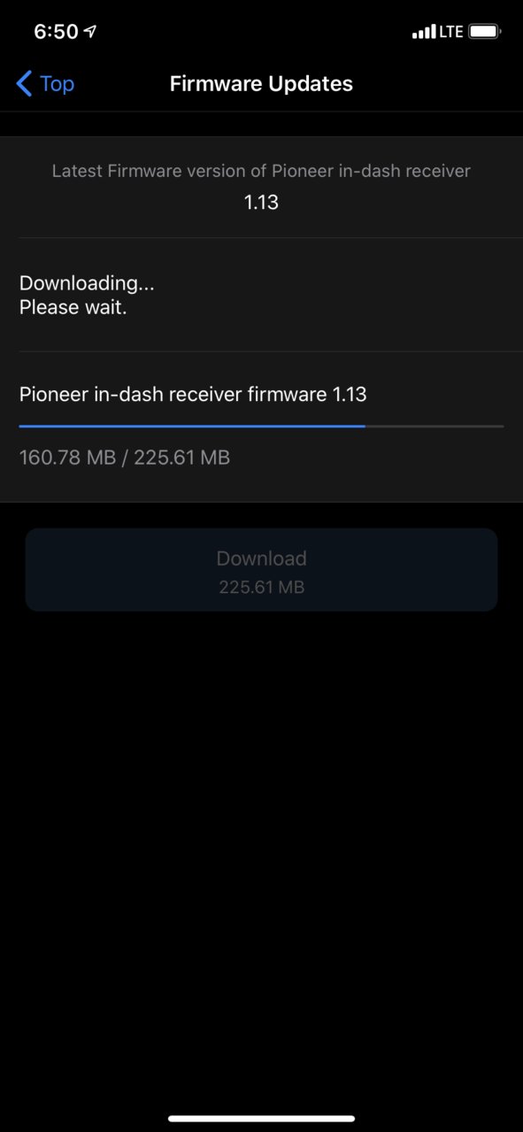

    It’s not a big update. You’ll need to connect the CarAVAssist app, download the update then tether your phone to install it. If you’re not tethered you won’t get the option to transfer.

    So I just installed the update via caravassist. The process isn't super clear. Tether the HU to your phone. Then open caravassit on your phone. Select firmware update. On the HU go to settings then, system, then system information. Press firmware update then select caravassist as the method. The press the button on your phone.
