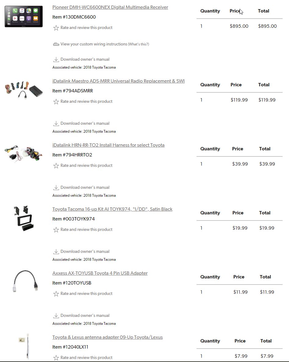

    Where is this kit? Crutchfirld keeps saying it won’t fit my truck

    The website used to build it out for you but it apparently does not do so anymore:
    This is the list by Crutchfield part numbers:
    You can re use your factory brackets, but you are going to have to modify them. If you decide to do that, don't order the dash kit.

    Its all listed in the post you quoted.

    Thanks, that’s what I needed. Got it all in my cart. Last question, I’m guessing the install is pretty straight forward? All really plug and play?

    The wiring diagram that comes with the MaestroRR unit is perfect.
    The hardest part of the install is fitting your factory brackets to the radio. If you look in this thread, I discuss a template method which is easy and straight forward and puts you in the ball park first pass. Then you can adjust the holes in the brackets to tweak it in exactly as you want it. Once you have the brackets attached and adjusted, harness build is 15-30 mins, 15 minutes and a beer to plug up the harnesses and program the maestroRR. Fit it first, then build your harness and install.

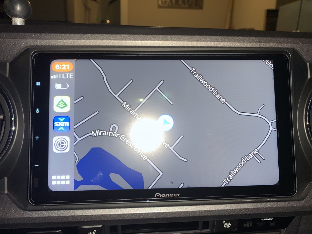

    How hard was it to get that image on? Did you use wifi tether or USB?
  20. Jun 22, 2020 at 5:49 PM
    #340
    PreRunnerSeth
    PreRunnerSeth [OP] Well-Known Member
    Aug 12, 2009
    #21110
    4,457
    Apex, NC
    16 Super White Limited 4x4
    Its done with the caravassist app.
