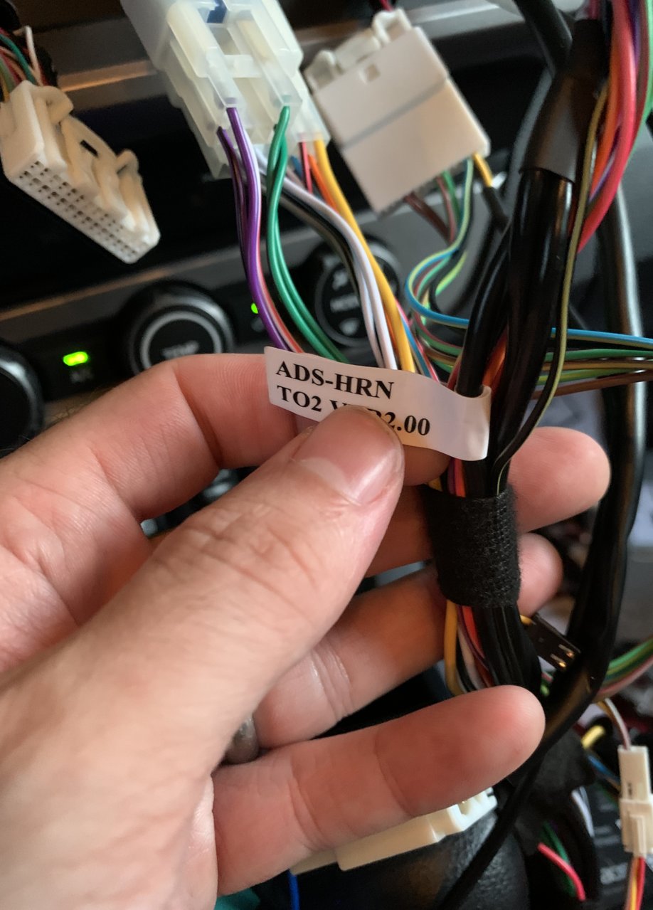

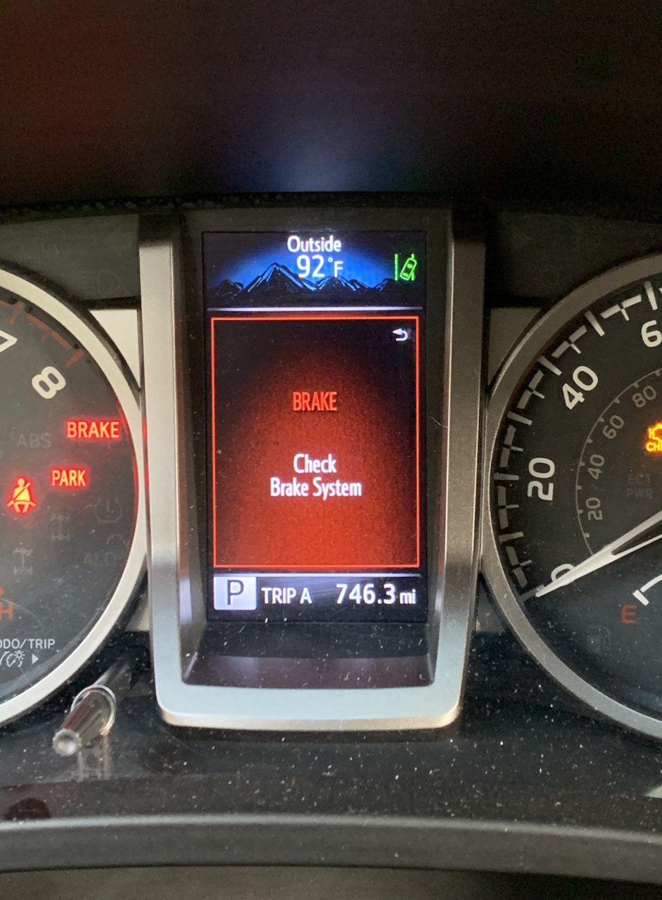

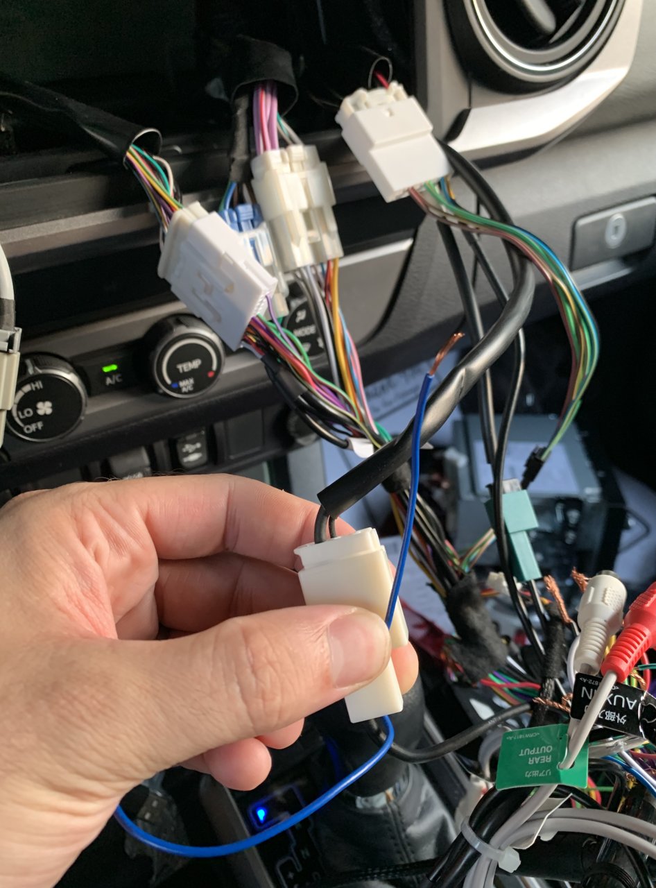

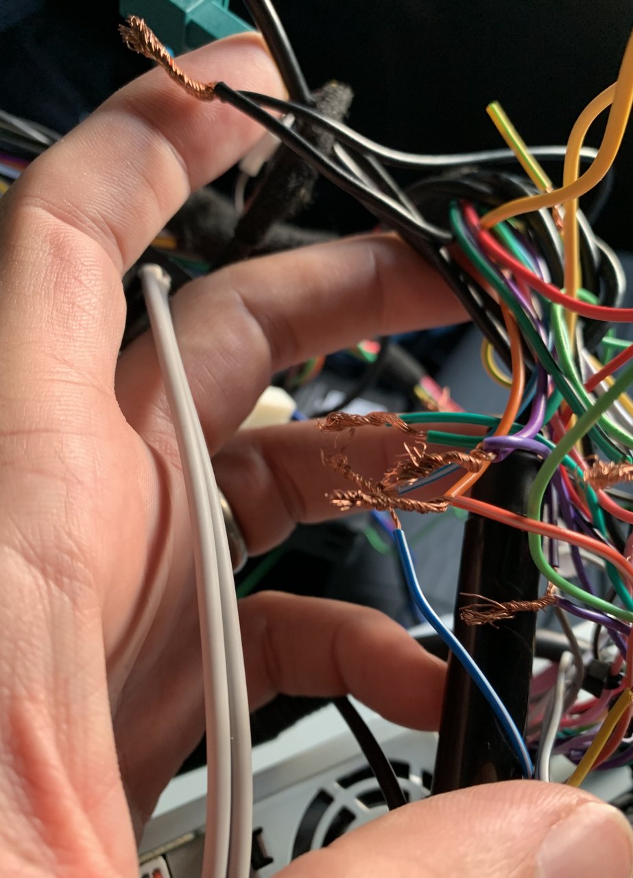

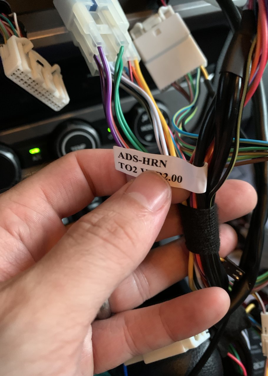

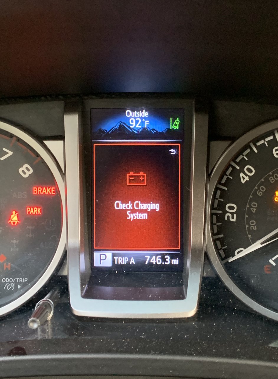

    I wanted to follow up on my issues from earlier this week getting the Maestro to work on a 2019 SR5 non-JBL.
    I'd be grateful for any thoughts or directions at this point! My wife did come out in the garage tonight and remind me that "I did this to myself!" - she's not wrong... hahaha! I'm glad to have going some time in working on this - but it's def. time to wrap this project up!
    Let me back up and explain the issue(s) I'm currently having, in case this turns out to help someone moving forward.
    I got everything wired up, got the Maestro RR flashed w/ my exact care, went out to install it - go the red double blinking light, which means one of two things:
    1. The SN is entered incorrectly... or
    2. The data cable isn't connected to the stereo.
    In my case, the data cable was connected, and I checked the SN a dozen times - even made my wife read it to me incase I was having some sort of moment. So I started to think I had a bad data cable - I replaced that. Same issue. Then, I thought the Maestro must be bad, so I ordered a new one (overnight, ugh) and checked that - same results. Maestro is fine. Cable is fine. SN is 100% correct.
    However, the issues I'm having are that the Maestro throws errors to the headunit every 10 seconds, making it unusable - basically saying that the Maestro is disconnected and the features aren't usable. Additionally, and not suprisingly, the back up camera does not work when I disconnect the data cable from the maestro in order to get a working head unit.
    So then I started to think it must be some sort of Maestro RR flashing issue - which, I haven't ruled out, but it seems highly unlikely at this point. I've tried dozens of combos, turning off features, default, every combination of Tacomas from 2015 to 2020, etc. I immediately thought, "No one else is having this issue in the forums. It can't be a profile issue!"
    So, I immediately started over - checking the harness, all the wiring - undoing it all and repeating the process from start to finish. I removed the wire nuts just to check and take some picture as well (it won't live like this, I was just double/triple checking that there were solid connections)
    Nada. In fact, I started to notice that my HUD was giving me random errors too - about checking the charging and checking the brake.
    So, here is where I am. All the evidence points to the idea that I have a bad harness - Maestro not working / Car throwing errors. I truly can't think of what else it could be at this point!
    Just to make sure I'm not doing anything just plain stupid, I thought I would include some pictures and see if someone would be kind enough to double check my work!
    All the best, friends! Hope everyone as an awesome weekend.
    -B

    I don't want to be critical, but you have bare power and signal connectors all over the place. Match color for color between the TOY02 harness and the pioneer harness. At least electrical tape your connections to prevent shorting while testing. Your blue power antenna wire goes to the blue and white wire on the pioneer harness (you will actually have three blue wires together). I am not saying your harness is not bad, but I would sooner bet you have connections touching where they should not.

    The check charging system error is expected if the truck is in accessory mode and items are drawing power from the battery. If your engine is on and you're still seeing this, that's something to be concerned about. If it's only in accessory mode and goes away after turning on the engine, it's functioning as expected.
    I'd also agree and say that you should def cap those wires.

    i only uncapped them for this picture as I assumed someone would say to make sure they’re connected :)

    good to know. Does indeed go away on start. Thanks for that!!

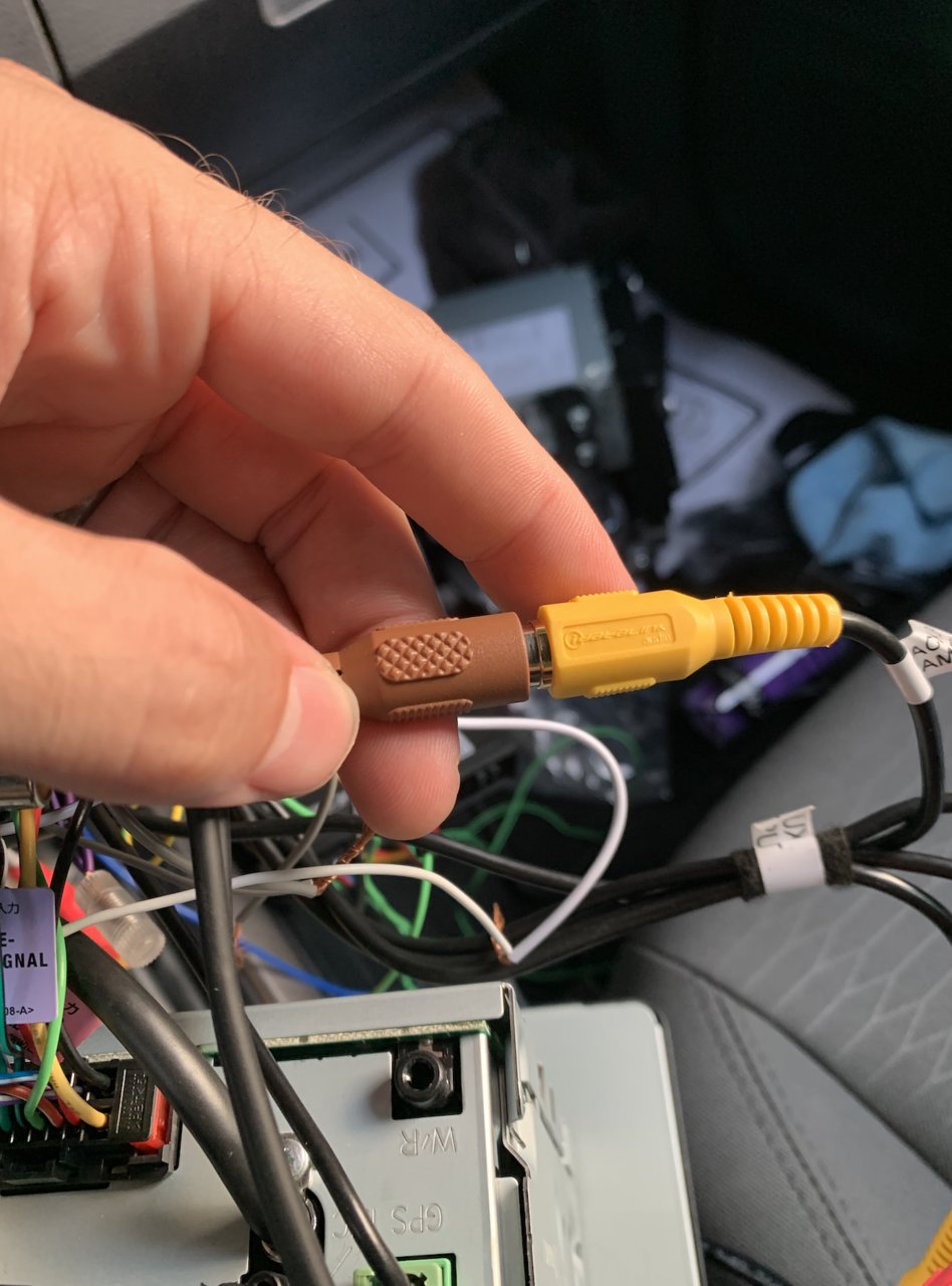

    Nonetheless, the back up camera ALSO does not work, so if I could solve that, I would just no-maestro it until I got the itch to fix it all again.

    • Am I right in assuming that yellow back up camera RCA goes into the brown female from the Pioneer harness?
