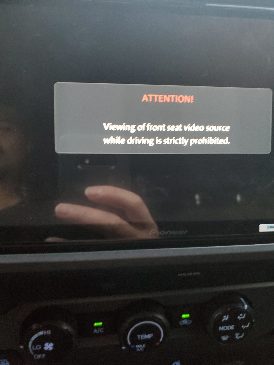

    I am updating the members. I don't know if someone on here confirmed it or not but I will give my experience so far. With a bypass installed and GPS connection disconnected on the back of the headunit but still have the pink VSS wire still hooked up, I am able to only hear YouTube videos but the video is not displayed. Once I come to a complete stop then the video plays again. The video goes away after I start driving again. My next step is to disconnect the pink VSS wire and try again in the next few days. The attached picture is what displayed on the screen when driving and hearing YouTube video but not ablecto watch.

    With both GPS antenna and pink VSS wire connected and bypass installed, this is how it acts for me. So the big test is No VSS or gps antenna with bypass installed. Keep us posted. I’m not pulling mine back out until there is some good history and known screen display errors or not. Thanks
