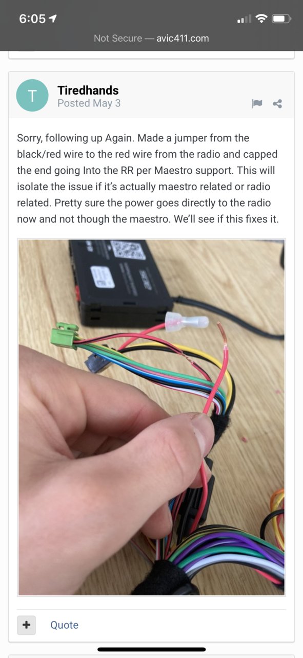

    @Markdizle Thanks again for this info! I went ahead and just ran the red acc wire from the pioneer straight to the red/black wire coming off of the maestro harness where it meets the oem harness. So doing it this way the red wire to the maestro stays in tact. Don't know if it needs to be but just bypassed the maestro completely. Ill let everyone know if it decides to restart on me anytime soon. Thanks again bro. Hopefully the maestro guys know what they're talking about. LOL

    Are you running the update from last week or whenever it was? Yeah i get it for a second or so. I do not get the moving screen alert like u do though. This stuff is weird. I don't understand why we all see different results? Even @Arisian with the red light flash. I don't understand. Maybe theres some small difference in wiring from an entune to jbl that throws things off? I want to see everyone get the most out of these $1K stereos! This is the most $ I have ever spent on a deck! These things should be Perfect for the amount that they cost!

    should the head unit turn on if the maestro is 100% removed from the harness?
  17. Jul 2, 2020 at 12:22 PM
    #537
    dwillhere1
    dwillhere1 Well-Known Member
    Feb 22, 2019
    #284029
    429
    Dan
    Surprise, AZ
    2017 TRD OFFROAD
    I don't believe so because the ACC/Red wire is run through the maestro.
