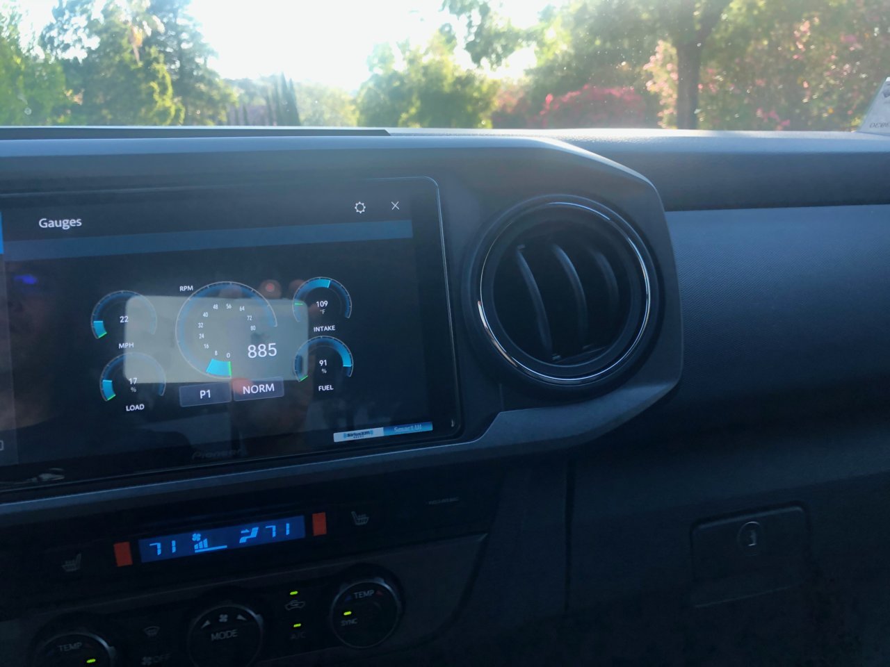

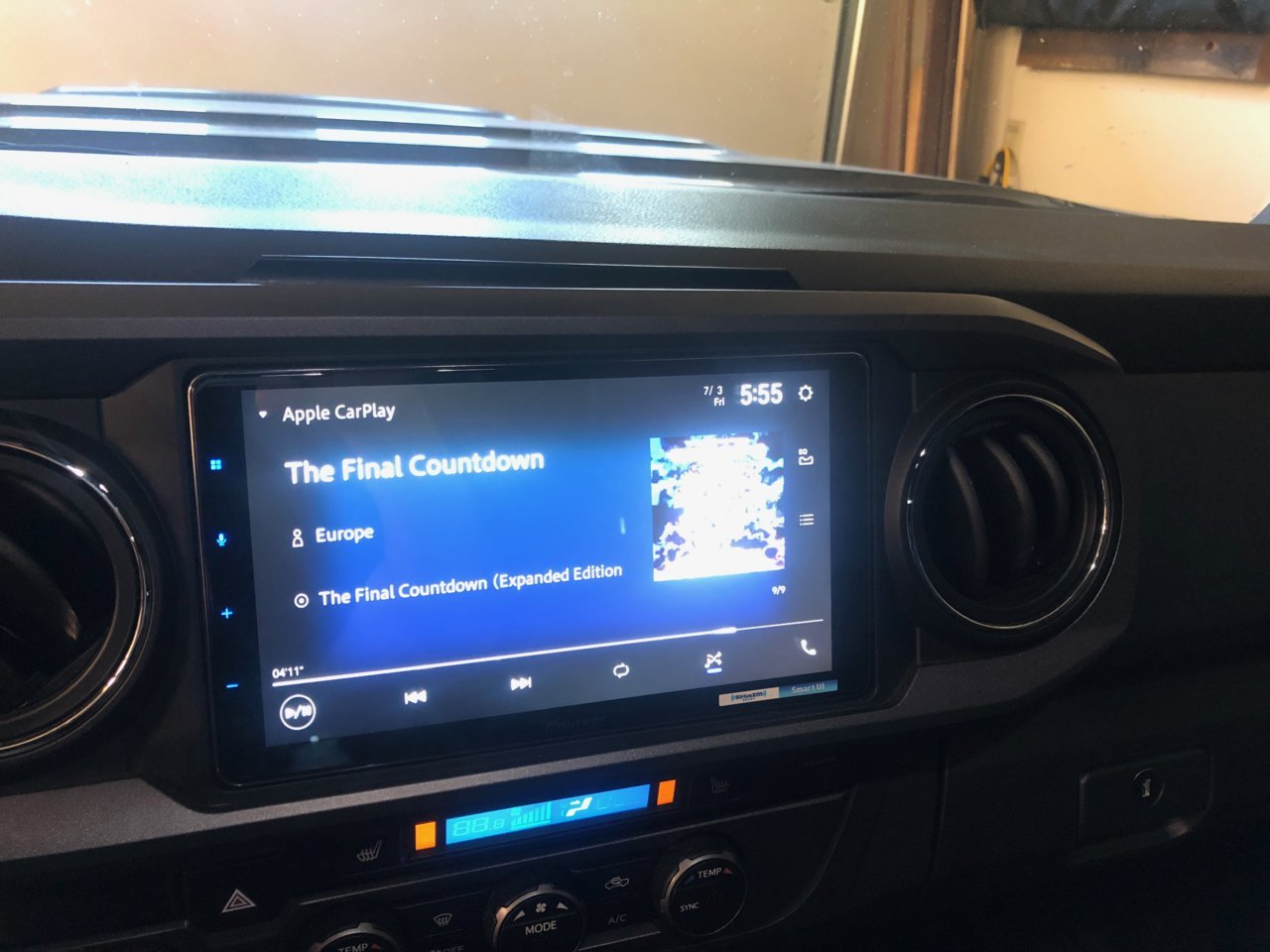

    So the DMH-WC6600NEX was sold out for the past few weeks at Crutchfield, and since I finally have a few days off, I decided to just pull the trigger and get the DMH-WT7600NEX instead.
    Everything works, except for the error message stating that the VSS wire is not connected. I don't understand, as it is connected, and I measured continuity on the wire, to the Maestro RR. When I'm driving, the Vehicle screen with ODBII gauges, is able to show the actual car speed. If anyone has any suggestions as to what may be causing this error, please let me know.
    I also used my original Anytime Camera Mod. I have a physical switch in the cubby next to the steering wheel, and I find it easier to engage than to go through the radio menu. This is especially handy when switching to the front facing camera.
    I love this unit. If you are more patient then I am, I would go for the DMH-WC6600NEX. That one is probably a lot easier to fit the car.
    I used the brackets from the "American International TOYK974 Dash Kit". I mounted the head unit in the top position, modified the screw holes only slightly, and I got the whole thing to fit in the original bezel.
    I forgot to order the GPS antenna adapter, so I re-used the factory one. Easy to do, with a small screw driver, you can pop the plastic of the cable. Do the same for the Pioneer plug, and re-assemble. Plugs-in just fine!
    Initially I forgot to also connect the blue wire on the antenna plug.... really bad reception. Once I connected that to the blue wire in in the Pioneer wire-loom (also to power the amp), it works like a champ.
    Oh, and the parking brake bypass works :)
