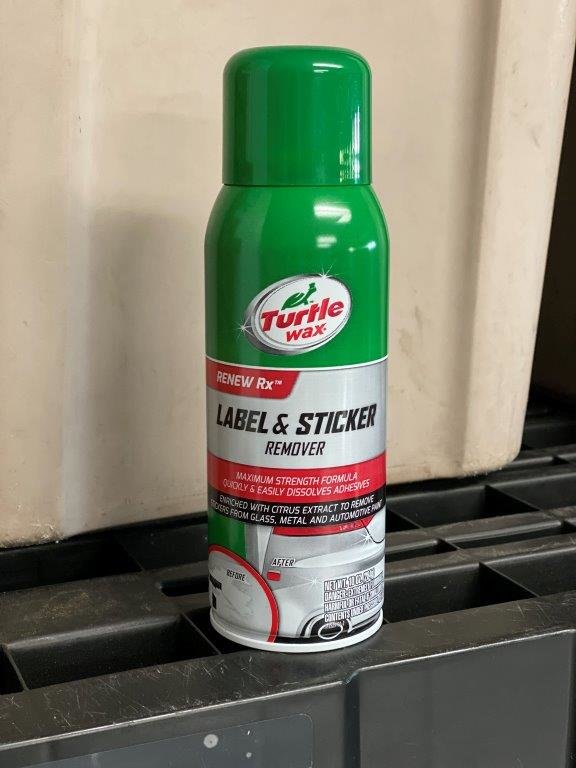

    @svermilyea Thank You! Wow, this is too bad. I've never had to do this much work to remove the original screen film. I wonder if Pioneer intended for this to stay on? Either way, thanks for responding!

    I messaged Pioneer over two weeks ago about the factory installed protector, and never got a response. I did notice that the factory protector was brittle and had a matte-ish finish, probably to help hide finger prints. Like I said, I only removed it because I couldn't take the chipped edge on mine. luckily, I found a replacement in the tempered glass one off ebay. I'm happy with the new one; no noticeable increase in glare, and a little clearer than the factory one.

    @svermilyea Cool. I believe I ordered mine based off of your ebay find. Makes me worry about pulling the screen apart while attempting to pull off the pioneer film. Mine is not peeling (yet). I wonder if I should attempt to clean the film and apply the glass over it, or just go for it and remove the pioneer film? Being so expensive, its a little scary, lol.

    If your screen protector is intact, I would just leave it. Put the tempered glass ones on the shelf for later.

    I now see what you are talking about. Lol. So my opinion would be, that the film that comes on the stereo is meant to STAY on the screen. I read your review and the other persons review and just took it as difficult. I STRONGLY BELIEVE that the film on the stereo is meant to stay on. DO NOT REMOVE THE FILM ON THE SCREEN!!! Lol put in bold so more people would see this. I also ordered the recommended size and had to slide it over because it was a little over halfway across the volume buttons that worked weirdly like this. I need to recheck my sizing and maybe order another set
    !!!!I WOULD ONLY INSTALL A GLASS SCREEN PROTECTOR IF THE PIONEER ONE IS DAMAGED OR PEELING!!! Caps for attention
