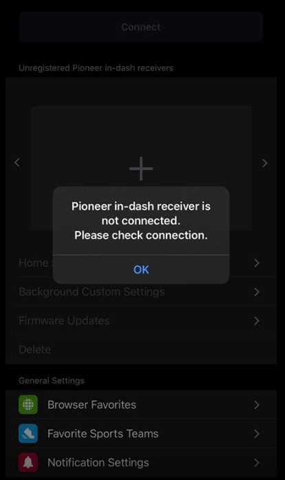

  10. Jul 31, 2020 at 3:49 PM
    #830
    BountyOR_VF2
    BountyOR_VF2 "If in doubt, flat out!"
    Feb 13, 2017
    #210511
    626
    NorCal Bay Area
    2017 WHITE TRD TCSB OR
    Thank you, it is working!
    But........... I'm so frustrated with the Pioneer apps. I do not understand why I can't have it connect with my unit.
    Apple Carplay working
    Apple Carplay Wifi working
    USB connection no problem
    IPOD connection working
    BT connection working
    PHONE connection working
    I even connected my phone with the unit by Wifi, and everything seems fine.....but just not able to have the App connecting.
    Can anyone give me some hints? Or what exactly needs to have BT or Wifi connected? Thanks

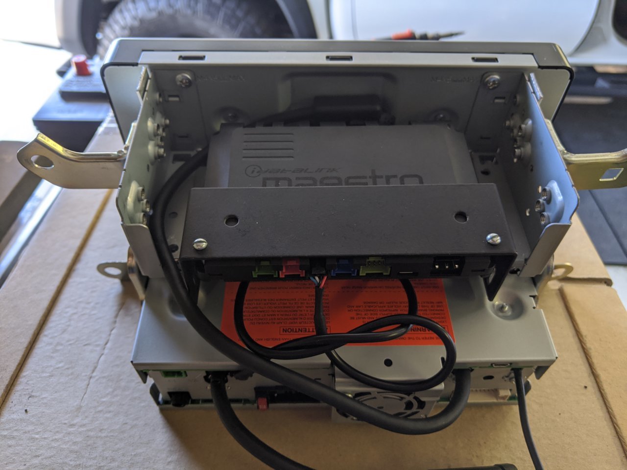

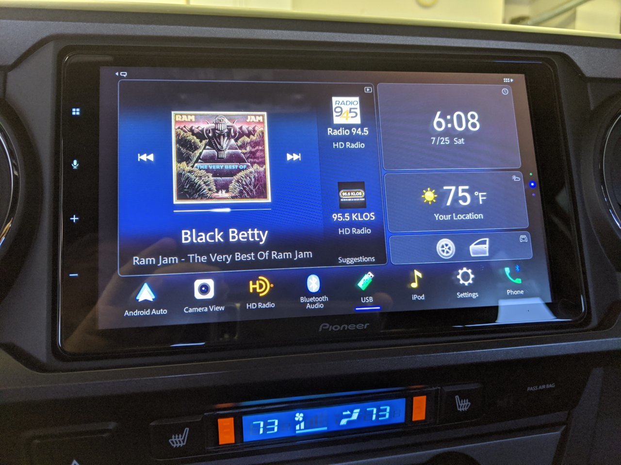

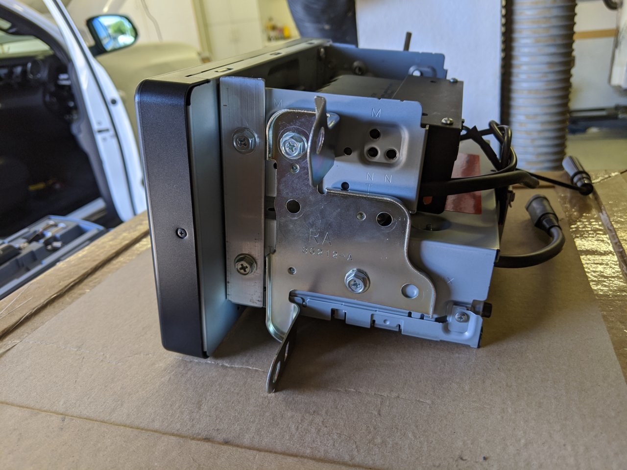

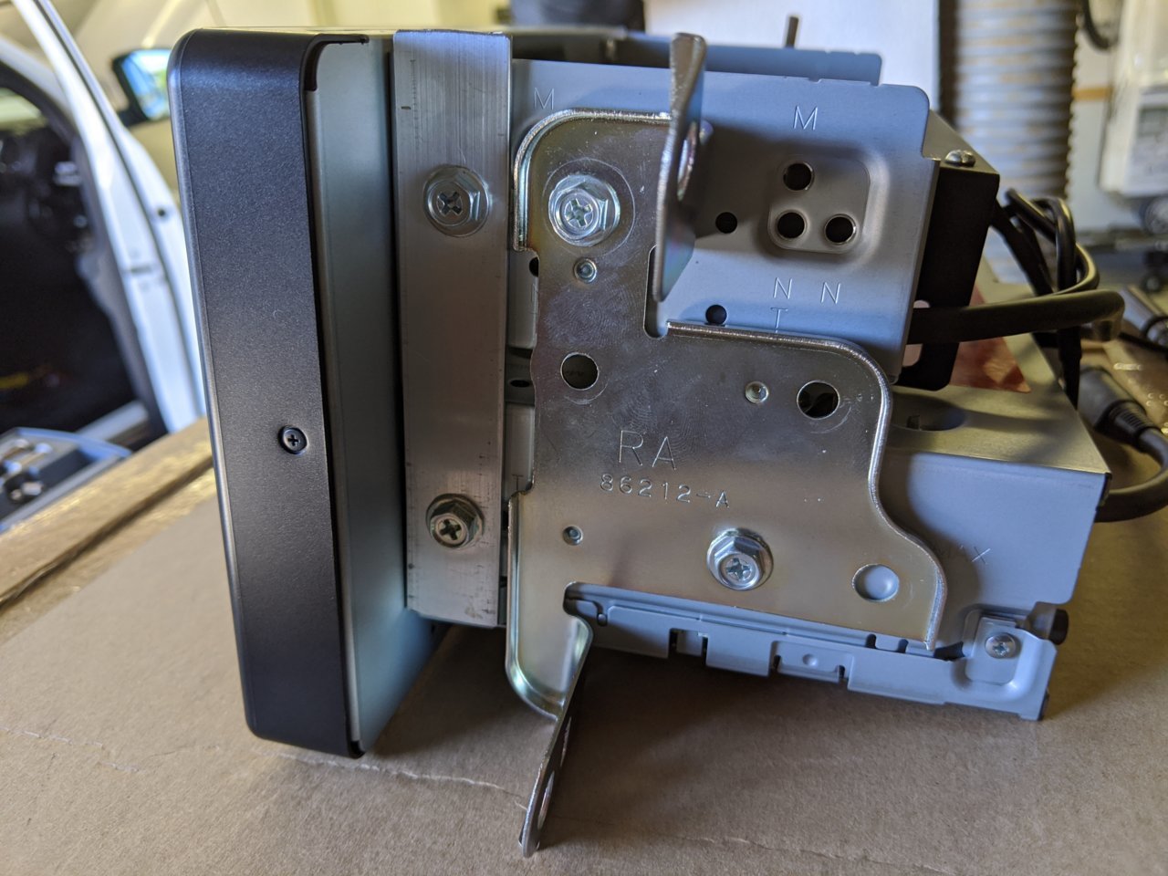

  19. Jul 31, 2020 at 7:46 PM
    #839
    fj4fun
    fj4fun Active Member
    Jan 6, 2019
    #278319
    29
    2019 Tacoma
    Hope this helps as an example how to install Pioneer DMH-WC6600NEX. Using Factory bracket and adding a piece of aluminum flat stock. For factory bracket only mod was to remove stamped dimples in bracket.
    The aluminum flat stock just drilled two holes 1 upper and 1 lower to mount as a bracket. This way allowed radio to sit flush with bezel.
    IMG_20200725_145149.jpg IMG_20200725_145138.jpg IMG_20200725_180850.jpg IMG_20200725_145145.jpg
    Ol' Sarge, CarverLB, japjoe7 and 2 others like this.
