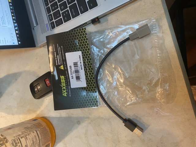

    Just finished install. The USB to stock adapter does not work on 2020 non jbl. Anybody know of alternative?

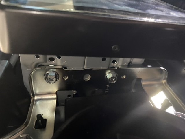

    I also modified oem bracket by drilling additional holes. It is pretty flush.

    I don't know what I did different mounting mine but it is flush and I didn't need a right angle usb adapter. I just used the one I posted earlier and I had plenty of room to let it go straight back and plug into the usb adaptor on the truck harness.

    I have a 2018 and I used that USB adapter. Wasn't aware that the 2020 was different, sorry.

    Idatalink offers a different adapter, pop in your vehicle info on their website for the correct one.

    If you have the WC6600 you should have plenty of room behind the unit. I think the people needing the right angle adapter went with the WT7600. I installed the WC6600 and mounted it a little farther back on the stock brackets, then used 3/8" washers to shim the unit to get the perfect flush fit.
