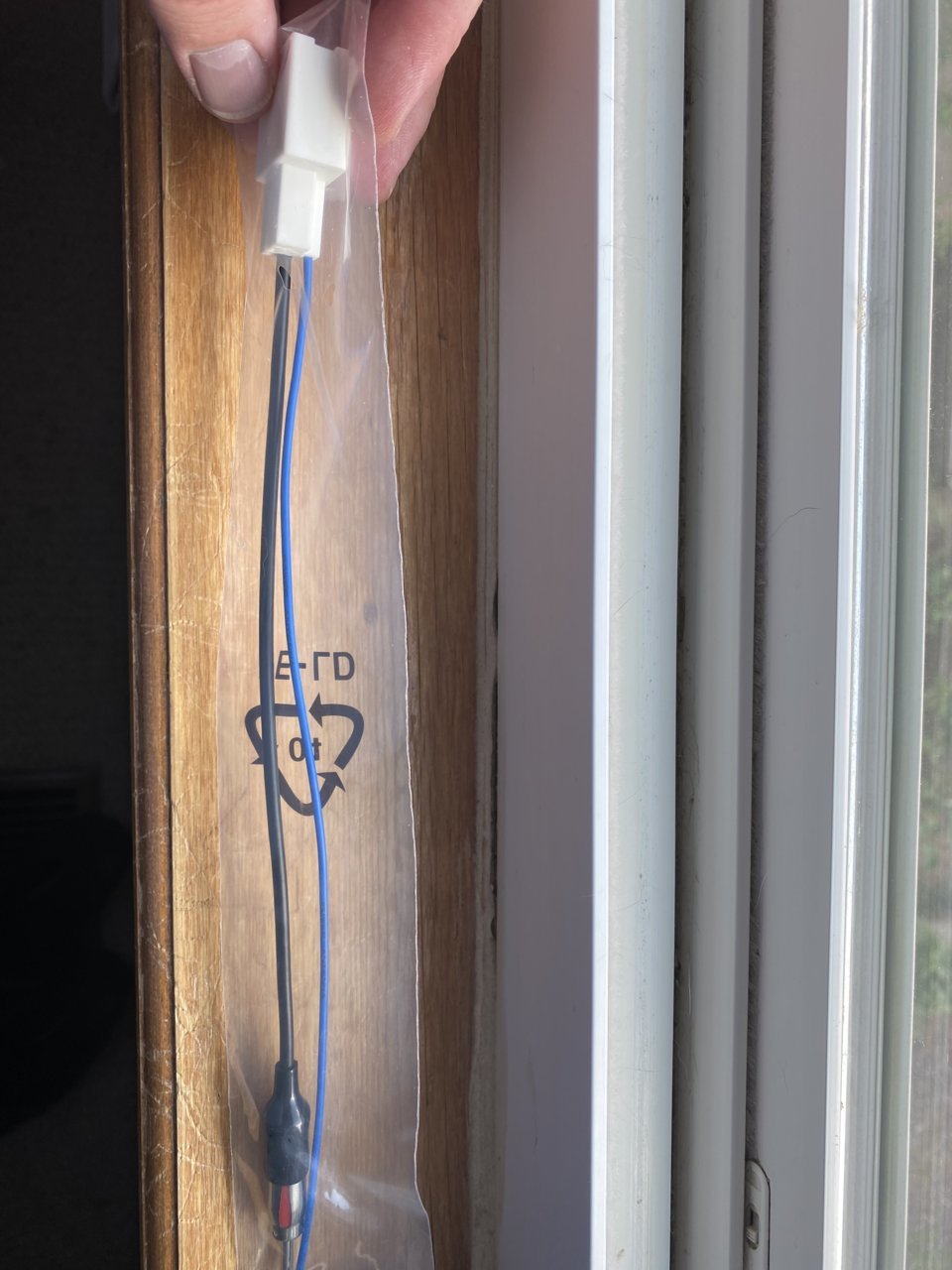

    THAT is why my radio won't tune. I am missing that wire. Nowhere to be found. Ugh.
    Yep, checked the box, where I threw all the things I didn't think I needed... that cable isn't in there. I found one on Amazon that looks like it should work.
    This connects to the grey cable from the truck, right? I know the blue wire needs to be spliced to the blue and blue/white wire on the regular harness.

    Yep you got it. Splice the blue wire into the blue and blue/white wire and plug it into the plug that fits it on the truck.

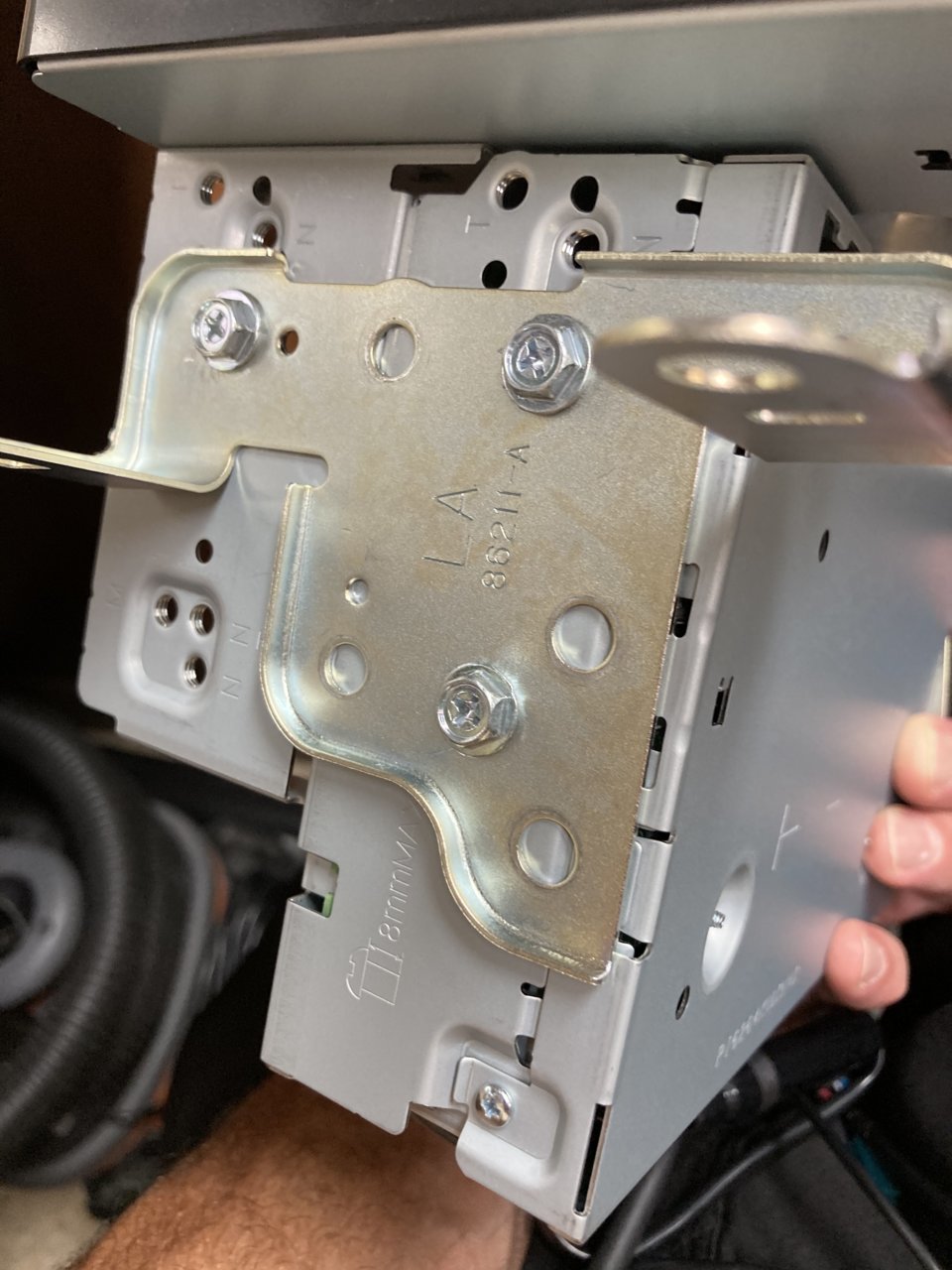

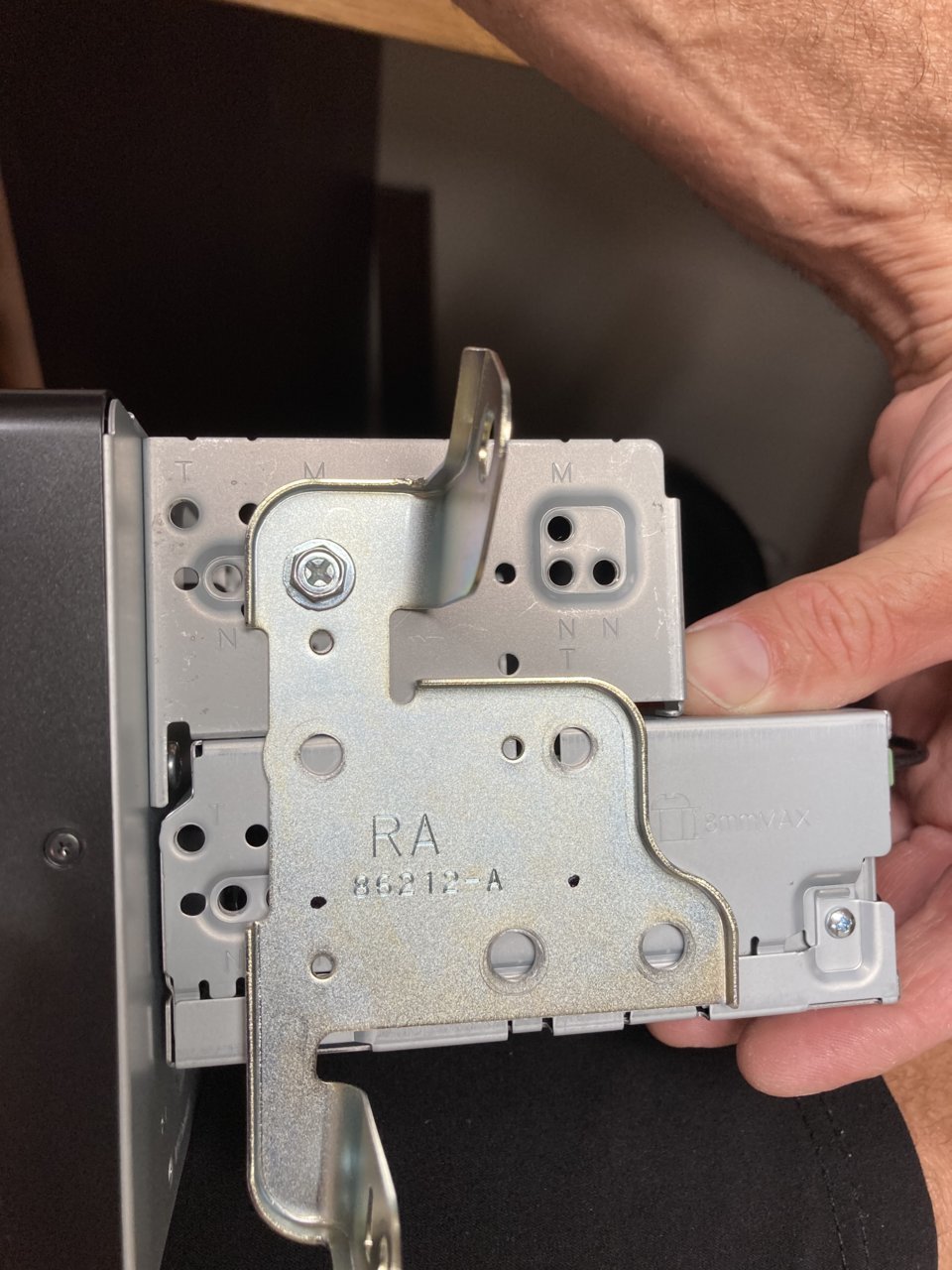

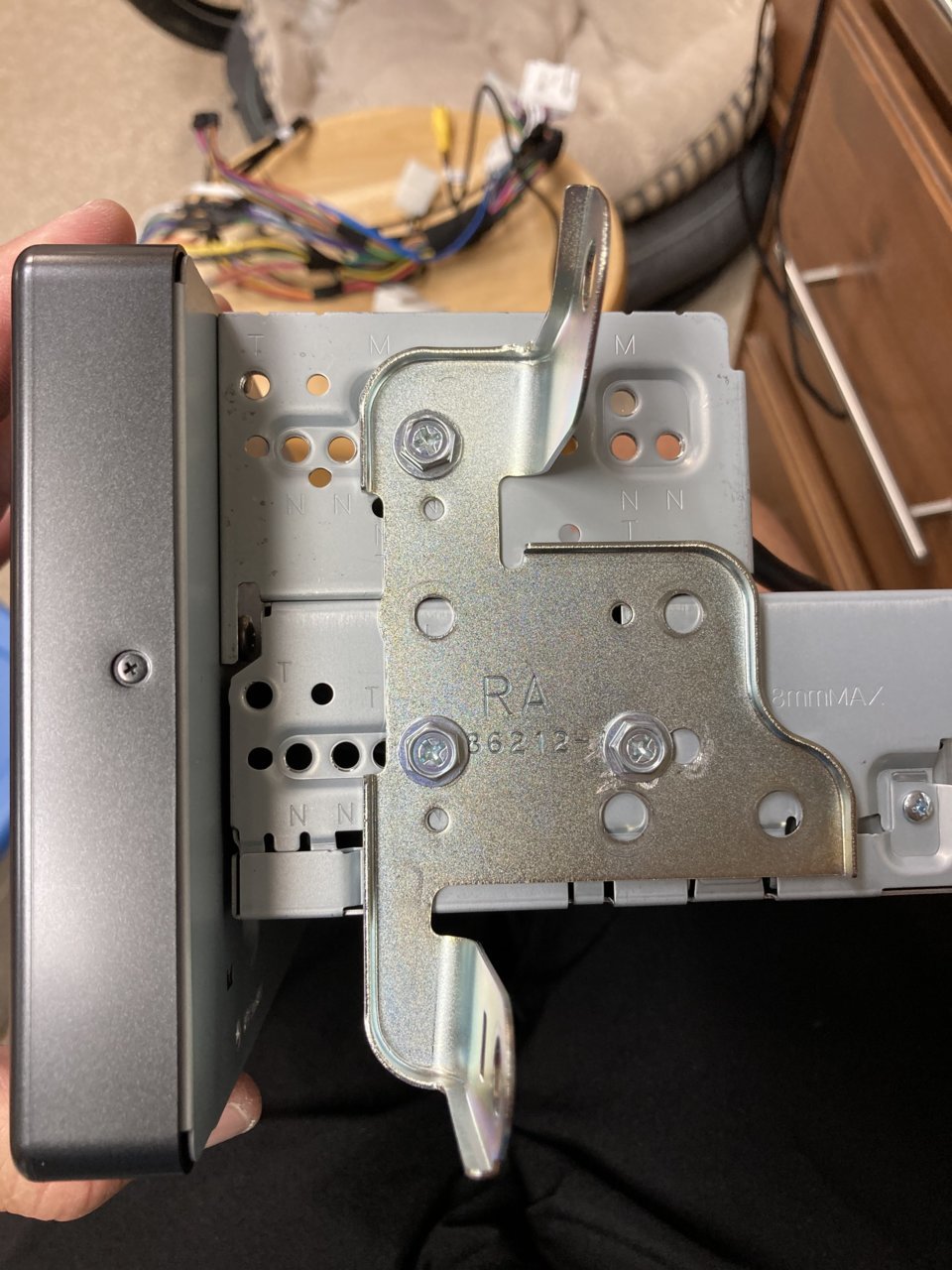

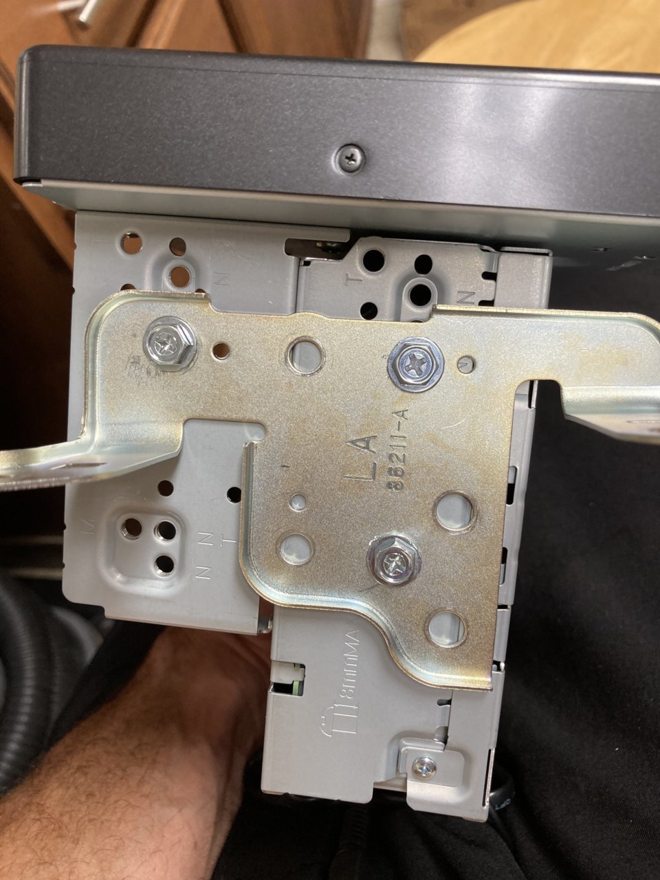

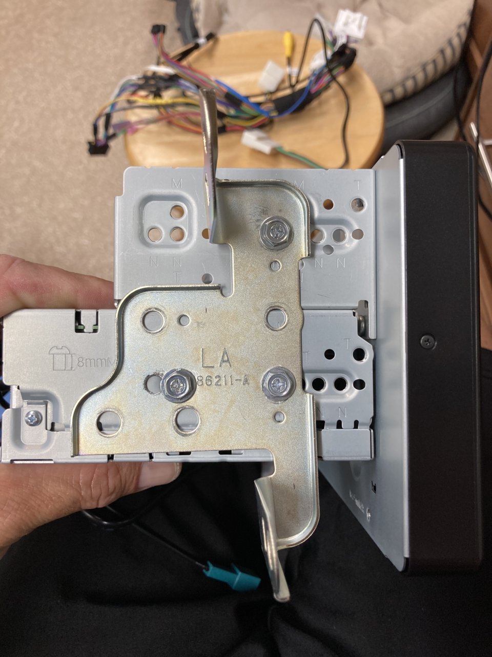

    I worked through the brackets last night. Used a 1/8” drill bit on the nubs and as pilot holes then enlarged to 7/16 for mounting. The brackets still work great with the etune which is a nice option to keep. I marked the mounting holes on the etune just in case I swap it back for a sale or something.
    I think everyone is aligning the fourth hole back on the screen brackets with the top factory hole and from there the rest is all about aligning the pivot so the screen lays flat. I drilled out the two bottom holes for the larger unit and left it attached to the screen brackets.
    EDIT: Just to be clear, these photos are when I mistakenly had the brackets on the 3rd hole from the front. I realized after a first test-install that they need to be on the 4th hold from the front and I wound up having to drill a 2nd hole for the rearmost screw which only has one spot vs the 4 which the top and bottom have on the front. The most important information in these photos is the rough angle of the bottom edge of the factory bracket, it's not quite parallel but more of a very slight angle. The good news is you can enlarge any hole you make with a larger bit if you need some wiggle room. The top hole is the factory one so you only really need to fine-tune the pivot or the angle the screen makes with the bezel and if you have the tops relatively snug and the bottoms looser you can press it into place, remove the trim, unbolt, and then make those side bolts/screws nice and tight and it should be golden.
    I'll do my best to get more photos tonight, it will show 2 holes b/c of this goof on my part, so do your best to be smarter than me :)
    AFA91636-6753-4E12-BF0D-45C496785158.jpg CD005DBE-AD35-4EDD-839D-2D0530931BB3.jpg 5C57FAA8-EDEA-421A-88A7-13E22B380AB7.jpg 2E5B85C7-F77B-441C-B53E-F5D23981A08F.jpg B3C92AB7-20B4-4857-A09A-ECB20EC8AEC3.jpg
    EDIT: As noted above, the photos at the top are my first attempt and it was too deep inside the dash. I moved the front screws to the 4th position in front and drilled new holes for the rear screws. Here are photos of how the brackets attach to achieve the flush mount look.
    For anyone starting this I would drill out the nubs, then attach the top holes to the 4th position, then line up the brackets like I show in the pictures below. Then mark and drill the lower front holes, mount them on 4th position to confirm (or drill bigger if slightly off). Last, mark and drill the lower rear holes which are probably the hardest to get just right. You can likely use the markings on the brackets assuming they are in the same spots for all of us.

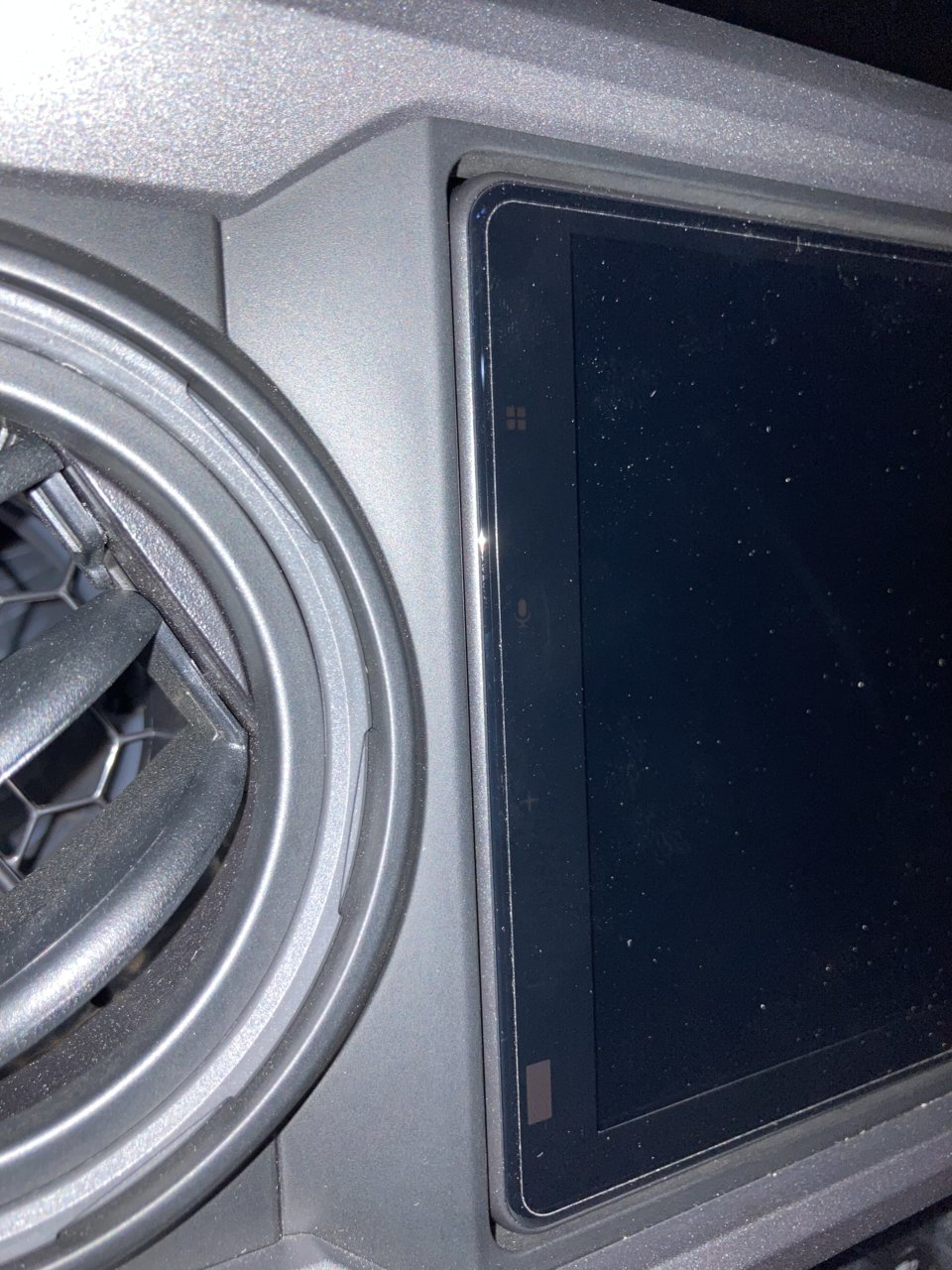

    I finally got to drive at night... the screen doesn't dim very much at all, and in the screen dimming menu, there's really no manual way to set brightness. That's silly.
    I also noticed that with Waze on dark mode, the screen seems to get dimmer when I turn my headlights OFF. Yeah, it's BRIGHTER with the headlights on!!
    ETA: I found where brightness can be adjusted. The manual states settings under the Picture Adjustment section of the settings will remember settings with both the headlights ON and OFF, so you can tweak both separately. I went and poked around there and found it. A little tweaking of the Brightness, Dimmer and Contrast should get me where I want to be.
