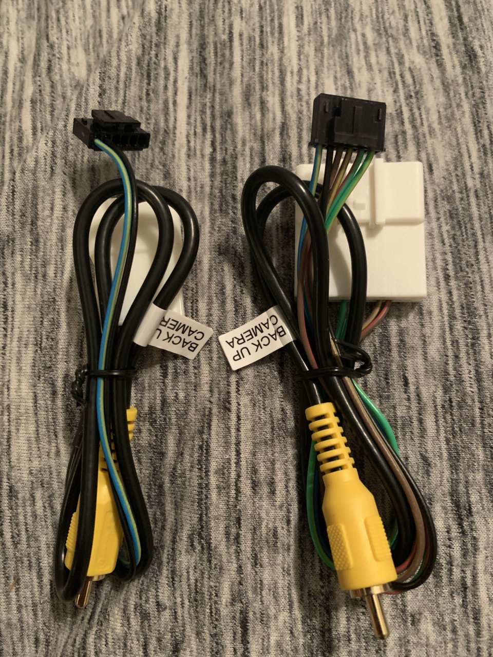

    Have everything on the harness soldered and ready to install tomorrow evening. Hopefully. The pack has two different rear camera harnesses. Which one do I use?
