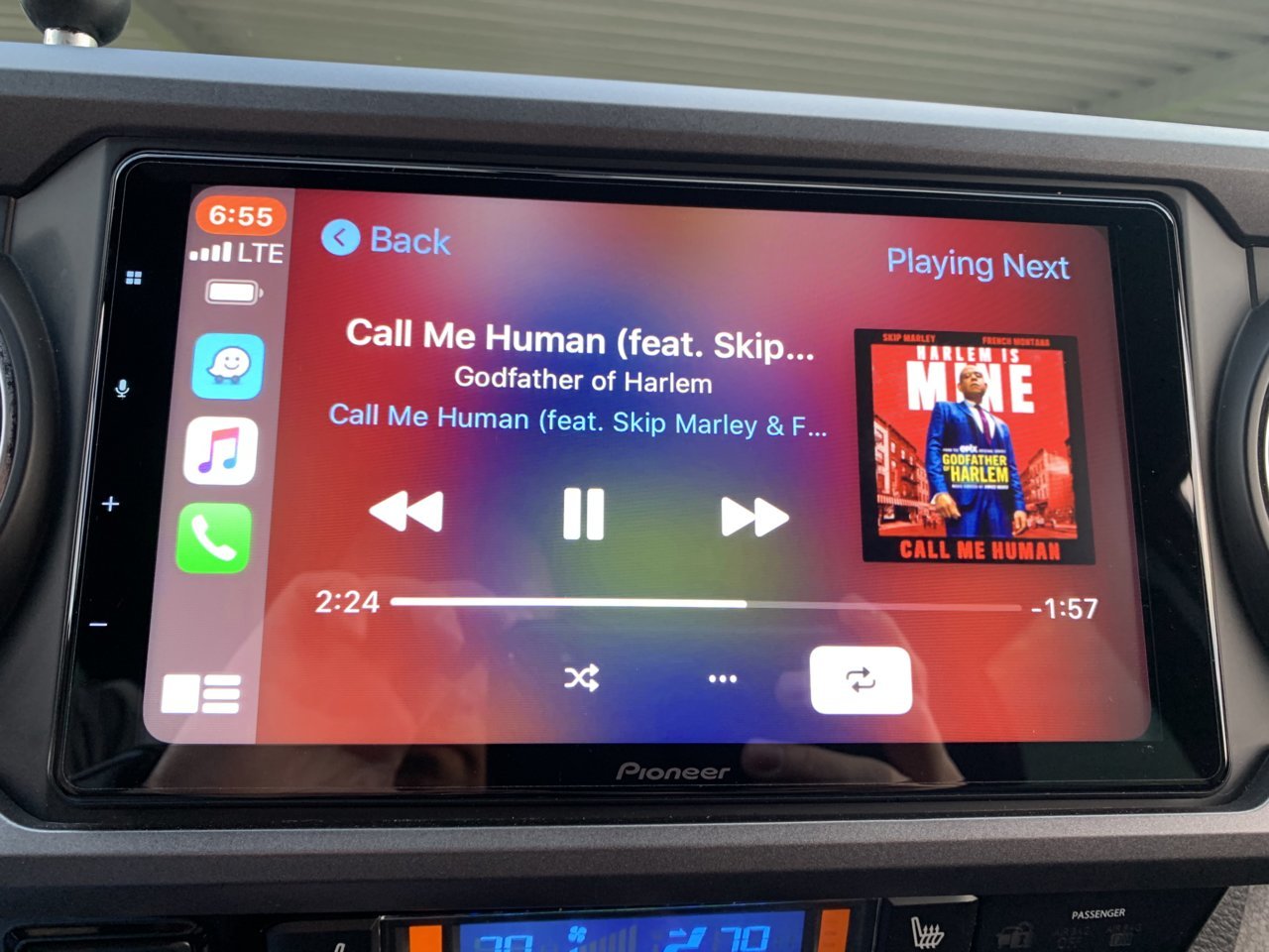

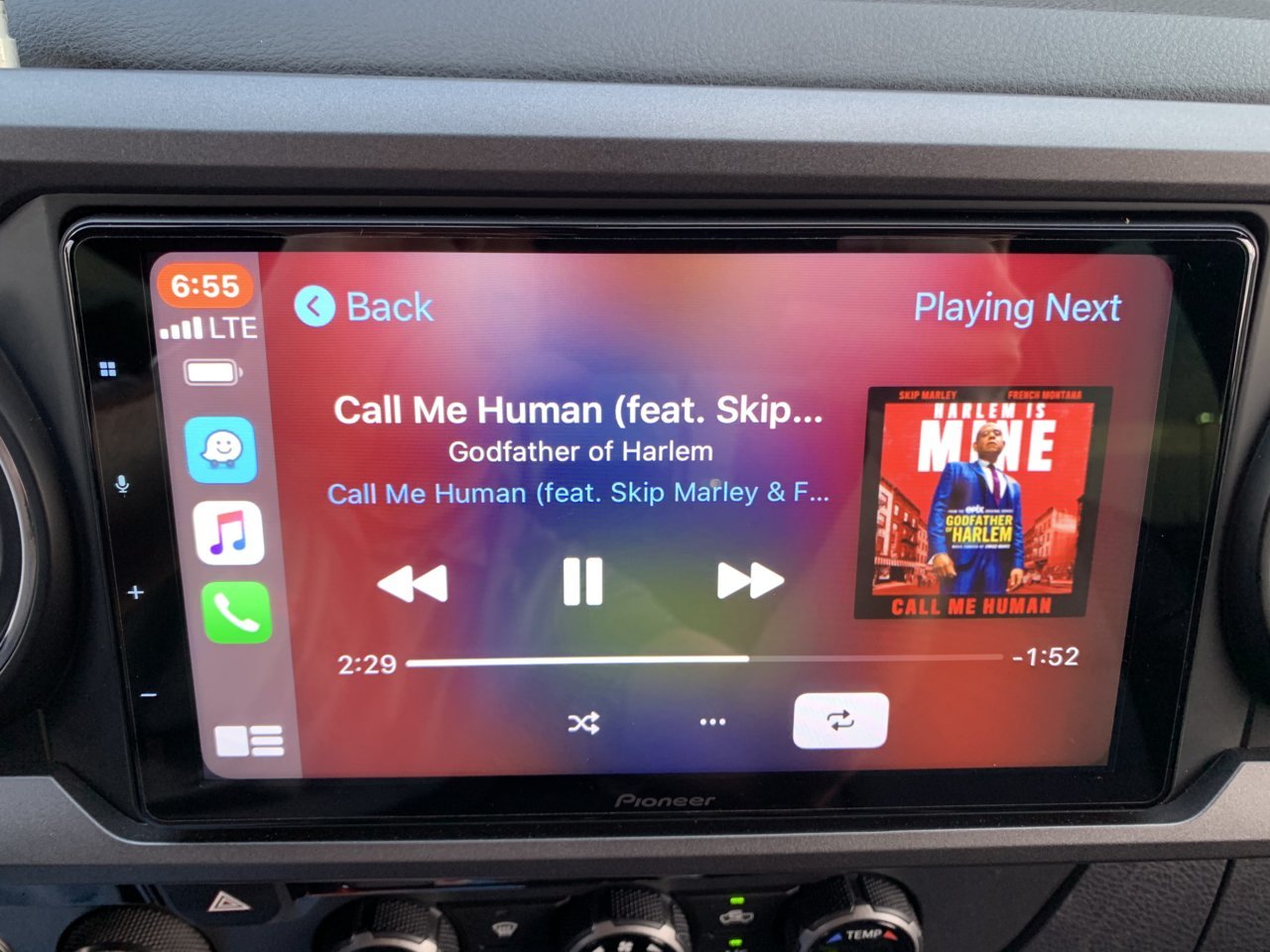

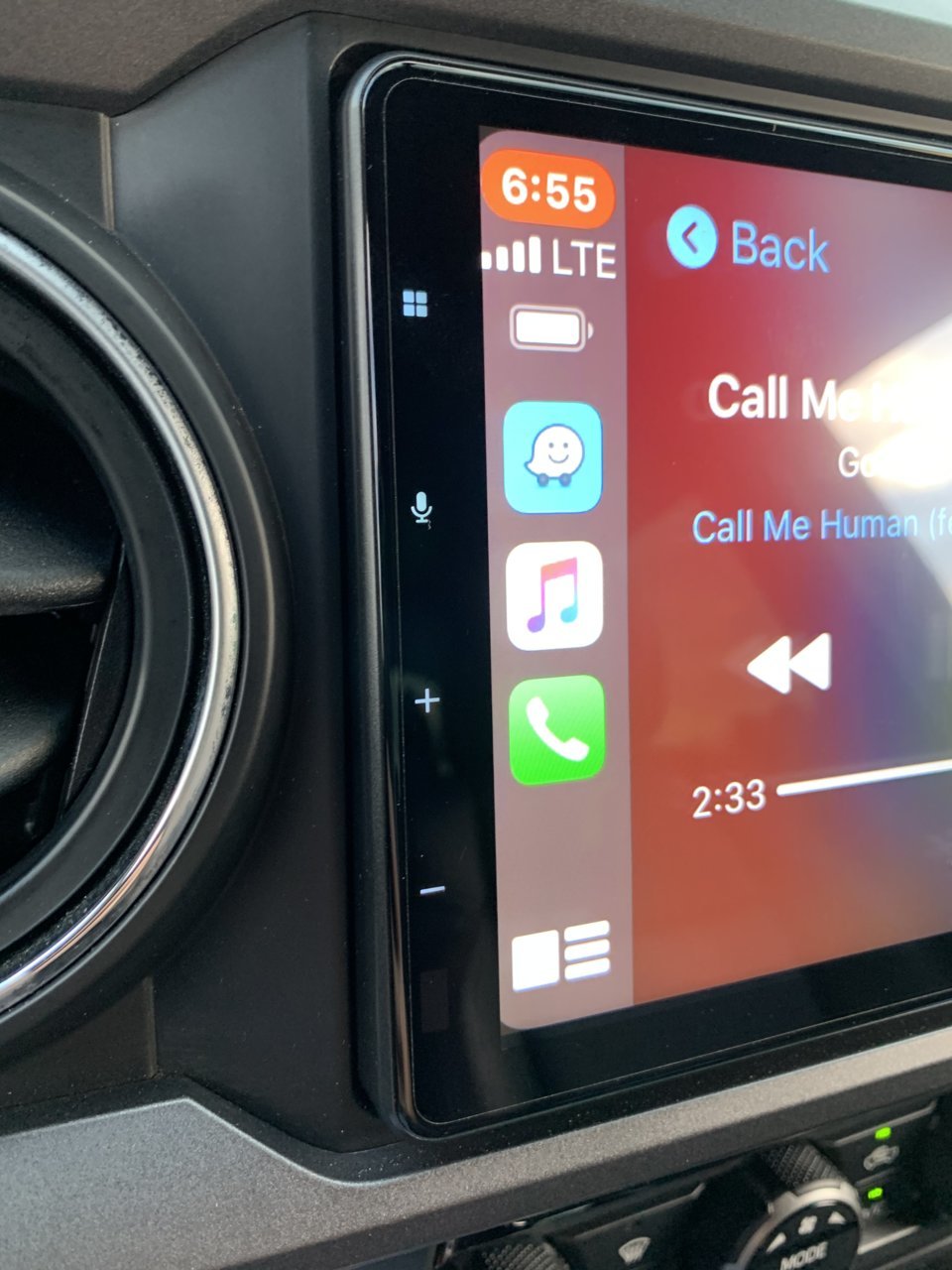

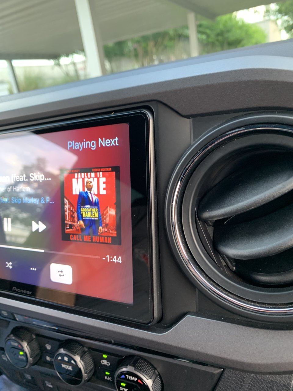

    Got mine in last night. The fit is great. Just gotta figure out all the settings since I didn’t have much time to mess with it.

    damn! that looks superrrrrr clean and sleek!

    Looks great man. are you able to push it any further back to flush it up?
    also how’s your feelings on it overall? Any tips on what was and wasn’t needed or what could be done for the next to make it easier?

    This is a modular unit so I’m sure I could figure out a way to flush mount but it would require some modifications. Also, my install was a bit hasty and this is the first radio I’ve done in probably 20 years. I’m not upset about how it’s sitting though. I have to mess with wire routing and mic this weekend so I’ll see about getting it a little more flush.
    So far I like it, but I haven’t spent much time with it yet though. I’ll know more in a few days.
    I’d suggest just buying through Crutchfield. You’ll get everything you need except the adapter for the GPS and satellite radio antenna. You’ll just have to get those separate.

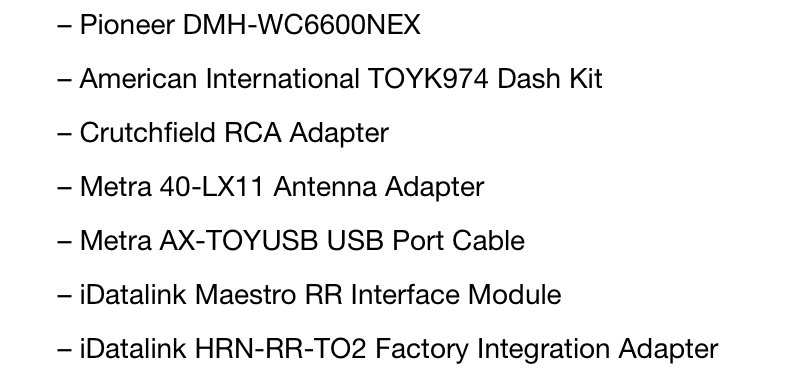

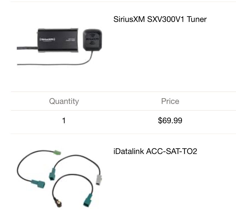

    Can you list everthing you ordered to make that fit please? SiriusXM adapter, mounting kit etc. Thanks for the info!

    Here you go.

    Thanks! btw were you able to unload the old unit or you going to keep it?

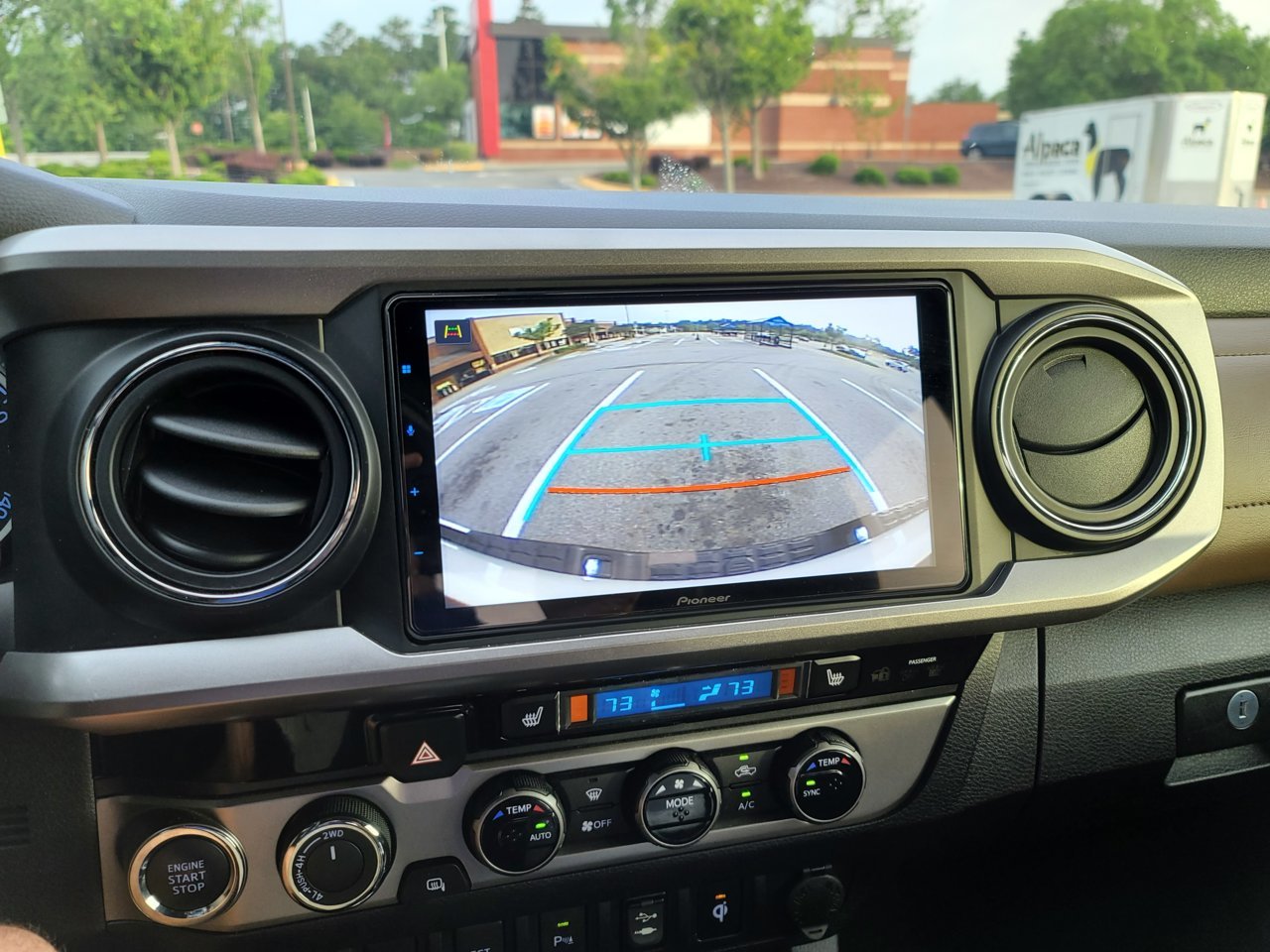

    to those who have this installed, can you upload a picture of what the reverse camera looks like on the screen? I almost pulled the trigger on the alpine halo awhile back but the camera/screen resolution was terrible. If this is close to factory then its gonna be getting installed asap as this is the easiest and cleanest setup I've seen so far!
