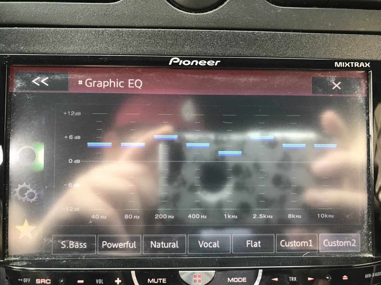

    Sorry for the blurry picture and it isn’t the new pioneer unit. But this is how I’ve always set my EQ for metal. I like to really feel the kick drum and low guitar notes. There are a few bands on the 6600 not pictured here, but just bump them up 2-4 db.

    Isn't it funny how everyone's listening experience is different? That would be way too much mid for me and not enough highs. My bass is set very low on my eq, almost zero for the first couple bars, and my subwoofer amplifier is tuned using its own lowpass crossover. This way I keep all of the bass out of the door speakers. Enables them to crank much louder without distortion.

    Ha! Indeed - mine is lower on the highs (-2, to -6), and a bass is at 0. No sub, no amp. Just the kicker speakers in the front (tweeters, too), rear and a buttload of sound insulation in all 4 doors.
