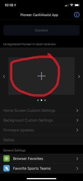

    Holy Moses - the directions, in general, are not amazing (from Pioneer, anyway). The stuff I've found here has been a godsend - so to give back, I'll briefly outline what I did to get the stupid CarAVAssist to work.
    1) Connect to the phone via Bluetooth.
    2) Go to the HOME SCREEN by touching the soft button in the top left corner of the 'screen' with the blocks on it.
    3) SWIPE RIGHT TO LEFT. If the display doesn't swipe right, try again. After swiping right, you will see 'Connectivity' and there will be 'CarAVAssist' (same icon as on the phone) on the 6600 screen.
    4) During this process, the 6600 will likely complain about being connected to CP/AA and say that it'll have to stop in order to transfer settings - this is A-OK.
    5) Go to the PHONE - start the CarAVAssist app.
    6) Click on the grey-ish box with a PLUS (+) sign in the middle.
    7) I'd probably just select the 'Connect from Pioneer in-dash receiver' and click 'next'
    8) It will ask "Connect to the Pioneer in-dash receiver?" - select 'ok'
    9) Et voila. It's connected.
    I thought this part was odd and even harder to follow than the above... to TRANSFER the settings to the 6600, you need to select on the 6600 in what direction to 'transfer' the settings. One goes from 6600 to phone, the other goes from phone to 6600. Go in select your sports teams (GO CUBS!), wallpaper(s), whatever, and transfer them to the 6600. It's a wonky interface and I'll probably only ever do this once as I don't really care to update a bunch.
    As a side note - I have wired my 6600 harness directly from the 28 pin connector for the parking brake and the VSS - and I still get the stupid warning that the speed sensor is disconnected. Maybe my wiring sucks, but I don't think so. Others in the thread indicate the same issue with direct wiring/hacking of the harness. Seems like a common problem - hopefully a firmware update will do the trick.
    So far 4/5 stars - I hate stupid error messages and I'm deducting 1 star until it is fixed. So there. Nah <sticks out tongue>.

    I could not get the caravassist to work at all, finally put the firmware update on a thumbdrive. Then the same day I was able to get it to work. I didn't know you had to hit the plus sign and "register" the radio when using the app....register is not the word I would have used......
