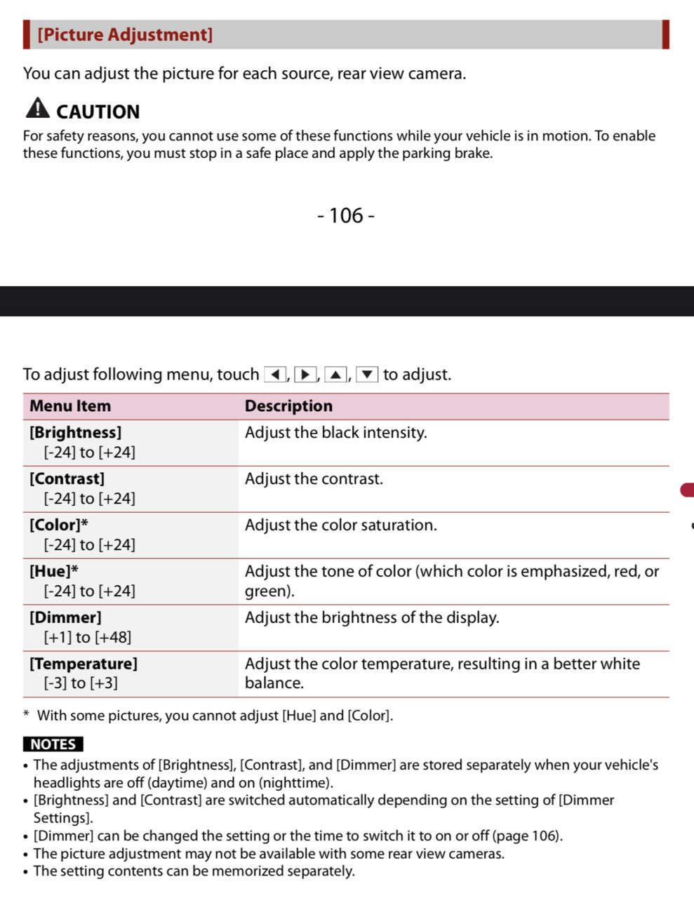

    Anyone had a issue where Apple Carplay is too bright at night regardless of the dinner setting

    Go to the picture adjustment page in settings and adjust the dimmer setting down.

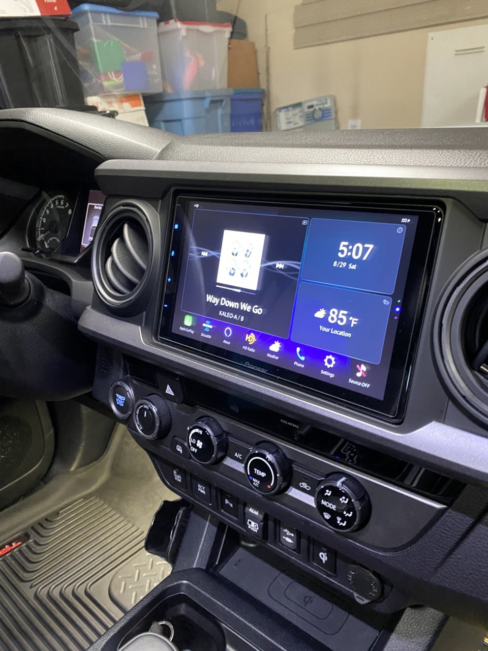

    Car Play windowed with two info windows

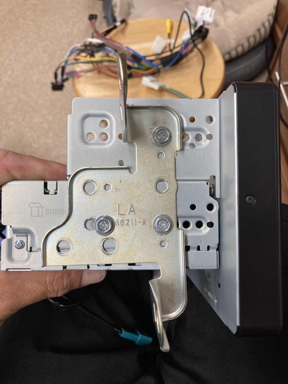

    OK, finally got mine in the dash for real tonight. Now I get to figure out how to register and use the thing, connect my phone, etc. I know a ton of answers in here I need to re-read. The microphone suggestions were great, though I still have to test that, once I get the phone paired. Can't even figure out the volume yet :)
    I do have one legit problem. The camera harness maestro 6-pin connector is too big. Probably because I have the RR2 instead of the RR. So I either need to hunt down a new one or solder that sucker up. Hopefully that's the reason my steering wheel controls didn't work for volume.
    Thanks for all the great help everyone.

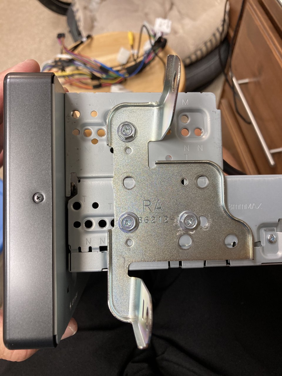

    Oh and also, photos of the brackets. Don’t be like me and drill the wrong hole the first time. Though who really cares if you do.

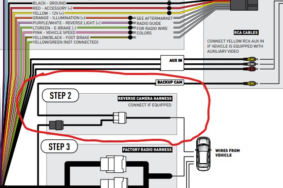

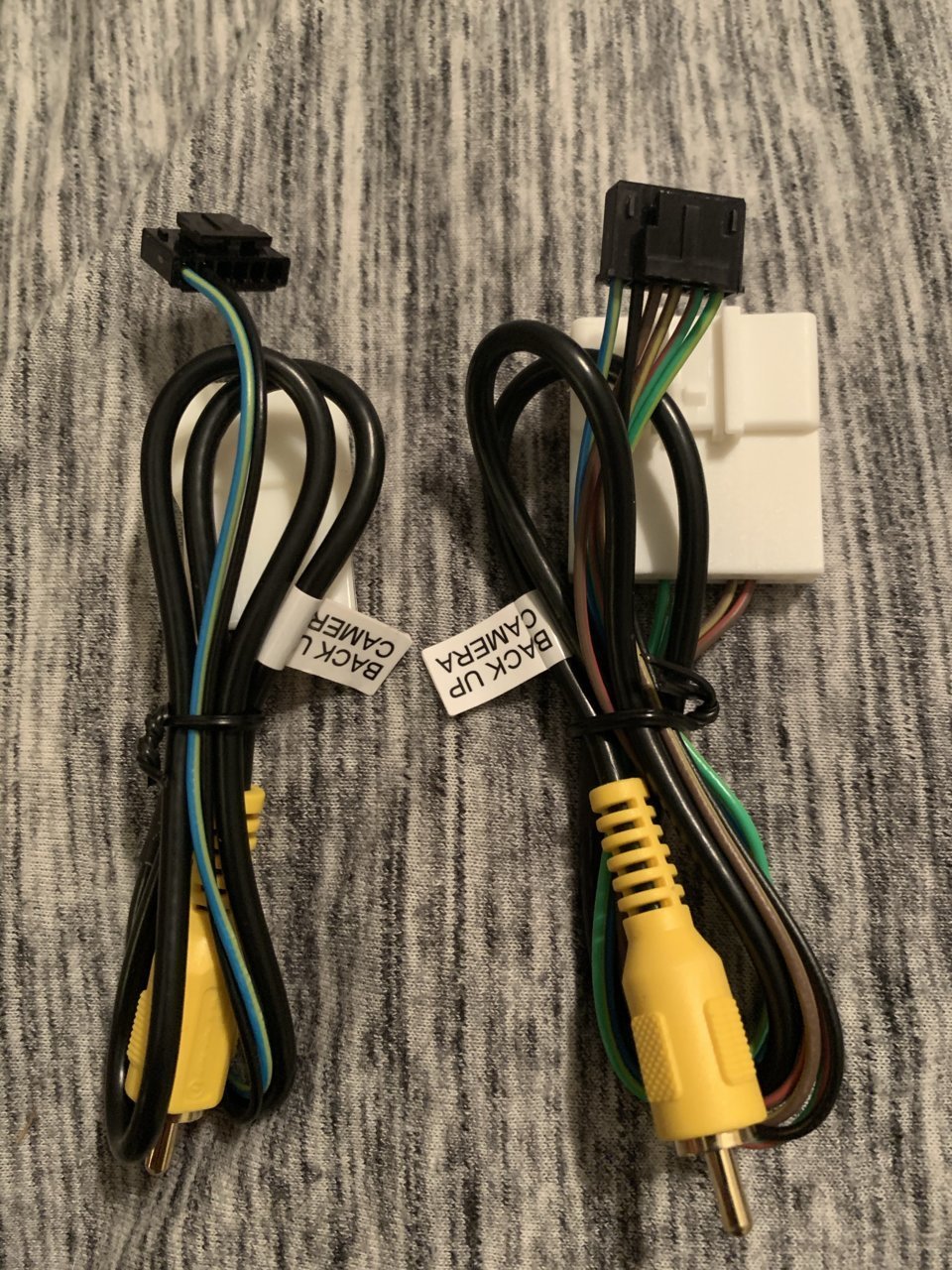

    well doesn’t that just tickle me. Here is a photo but not sure it’s clear. I assume I’m looking at the right plug because there is only one six pin one row plug.
  14. Sep 1, 2020 at 8:52 AM
    #1054
    TiHo
    TiHo Well-Known Member
    Aug 26, 2018
    #264160
    351
    2018 TRD Sport
    I used the one on the right in the top picture. The white end plugs into the truck harness, the rca plugs into rca coming out of Pioneer and the black end plugs into the TO2 harness. Nothing for the backup cam directly plugs into the Maestro.
