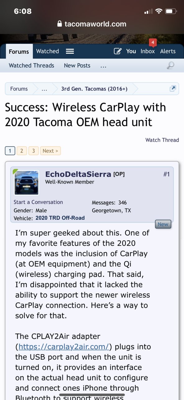

    @TacoTaco-BurittoTaco check out this post. I would definitely give this dongle a shot and see if it will work for u. This would make your head unit perfect.

    I just read a review on this wireless adapter and the connection dropped frequently for the reviewer. Worth reading some more reviews to see if it is a common complaint.

    These are the types of dongles they use in the android stereo world. I would buy one off of Amazon that has good reviews and is returnable. If it works good, then awesome, if not send it back. Definitely worth a shot!
