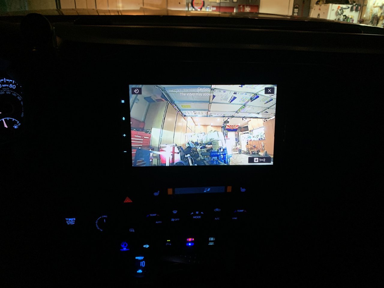

    I was the one who installed the firestick. Just to report back after reading all of these latest posts, it is still working well. Just watched netflix yesterday morning while waiting to be called for a table. You do need to use the Amazon remote as the touch screen doesn't correlate to the firestick. This will give you almost everything you would want. Only crappy thing about this deck compared to an android is that you can not install any apps. I started the install on this truck with a 7" touch screen pioneer, to an 9" android PX6, now to the 9" pioneer. After having the 9" capacitive touch screen and not wanting to deal with the finicky android unit, this pioneer was the only real option. Most expensive head unit I have ever purchased. Just added a front camera over the weekend with an oem style push switch for powering it. Super nice, especially when off roading and coming to a decline where i used to (HOPE) the road continued! LOL Now I will know for sure.
