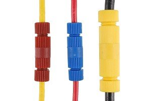

    Someone recommended Posi connectors for the wiring and since I'm lazy and like the easy way out (not soldering) I went with these. I can't speak to how well they work but I assume its pretty idiot proof and relatively secure.

    I spent way too much time soldering. Posi connectors would have made much more sense.

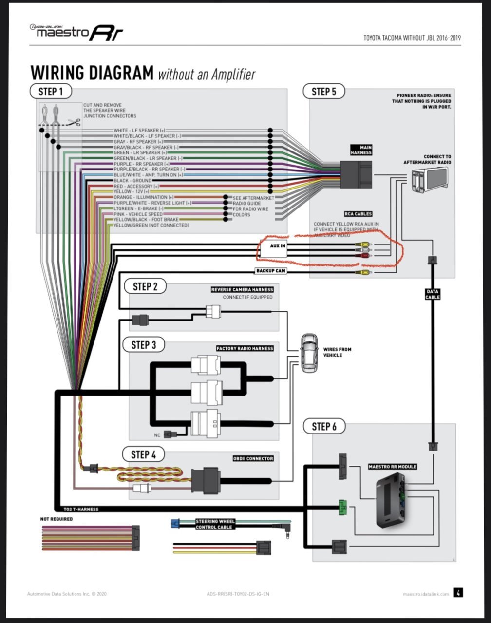

    If you want to use XM you will need a tuner along with the antenna adaptor you have listed. The RCA adaptor is to retain the OEM aux port.

    I used these posi connectors and they worked awesome.

    The area circled in red is where the RCA adapter goes. The single end plugs into the single black AUX In plug on the Pioneer side and the double end plugs into the TO2 Harness red and white rca AUX IN plugs. I taped the connections together using Tesa tape to make sure they wouldn’t come apart behind the HU. Added a pic of the TO2 harness with the rca connections circled in red.

    Thanks! I was looking for a 3.5mm jack. So there is zero use for any RCA adaptors since the maestro harness has RCA male and the Pioneer harness has RCA female.

    The TO2 harness has 2 RCA plugs, red and white, and the Pioneer has one. You have to go from 2 to 1 hence the adapter.

    Wow. I am staring at it now wondering how I missed it. It’s painfully obvious. Thanks and sorry to misinform.
    RCA female to 3.5 mm stereo mini jack _is_ needed to use factory AUX in. For anyone who has an audio source with a headphone jack. Pioneer is labeled as AUX IN using female 3.5mm and maestro is also labeled AUX in with rca male connectors.

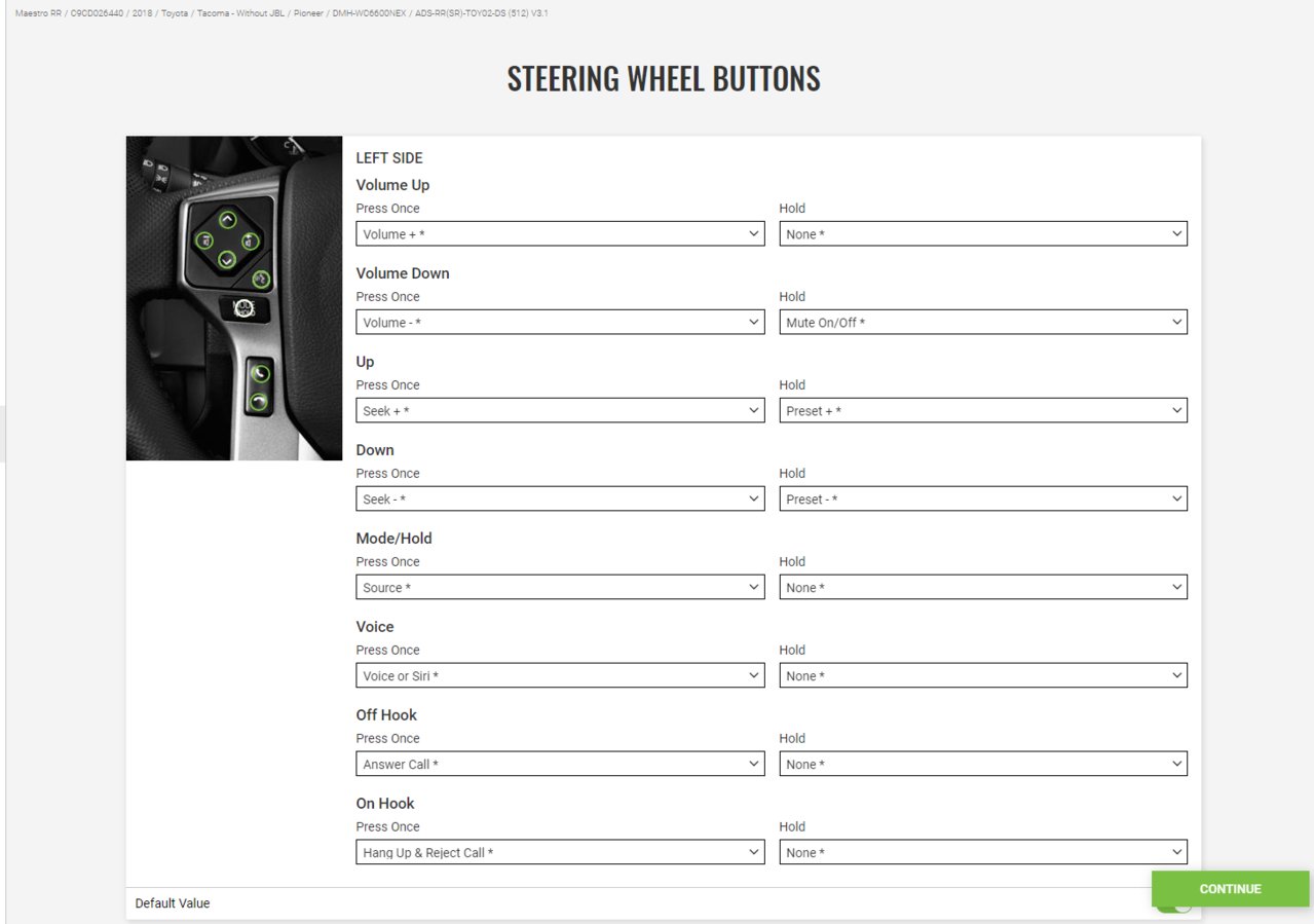

    So, not having owned an RR, this is what I whipped up on my own. I'm going to undo the front camera since you helped me figure out the Germes, making that no longer useful. Any other suggestions / recommendations for things I'm mapping oddly/dumbly?

    I wish I would have took a screenshot of what I mapped. The one thing that jumps out at me is the phone is backwards. Off Hook is actually answering the phone and On Hook is hanging up. Think of it as picking up the phone or taking it off the hook (old school phones lol) to answer,

    I would add mute to the hold button on volume down. The RR2 calls mute = Attenuate

    Sweet, I actually did that last night after I posted. But before I saw that I had answer and hang up swapped. So I still have one more flash in my future. I’ve definitely wanted a quick “be quiet” button when driving.
    I tried to configure menu for long press of mode but that doesn’t seem to do anything? What is your long press of mode set to?
    Also tried to set long press of volume up to trigger EQ and that doesn’t seem to do anything either.
    Maybe these work when on the home screen and not when in car play mode though.

    Settings from my RR. I matched these on my RR2

    Thanks. I intentionally did preset + and - the opposite of seek + and - after playing with it. Because it seemed like the up arrow should go up rather than down for preset selection. Maybe my brain is the backwards part there?
