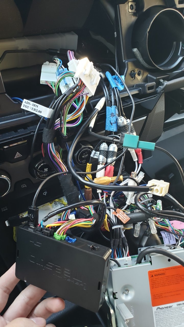

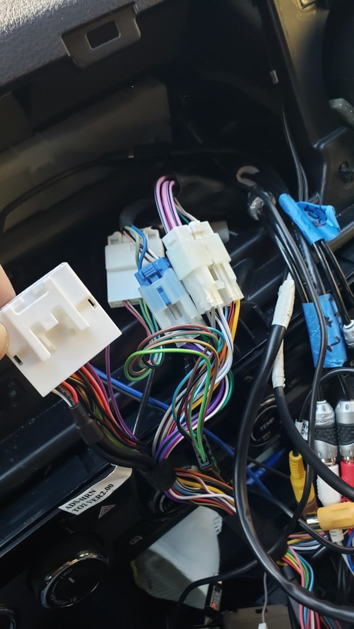

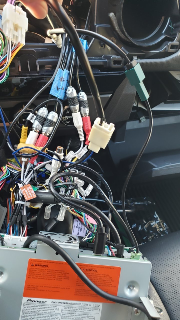

    So everything seems to work except my steering wheel controls. I've flashed the unit twice, once with custom controls I made and a 2nd time with the default controls it recommended. Anyone have an idea why my steering wheel controls aren't working?
    Here's a few pictures of the rats nest of wires.
