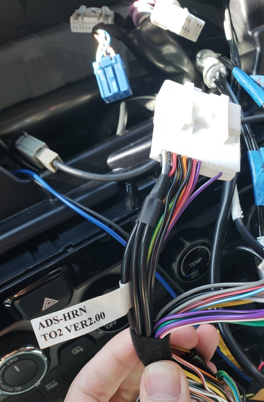

    So I called technical support for idatalink maestro. They told me the harness that says "ADS-HRN TO2 ver2.00" on it is supposed to be connected to a harness coming from my truck. He said I would have four large maestro harnesses connected to 4 harnesses coming out of my truck. I do not see a 4th large harness coming out of my truck. What am I missing here???

    Nevermind, found the 4th harness coming out of the truck buried deep down in the darkness of the dash. The steering wheel controls work now. Feel like a dope.

    Nah, don't feel like a dope. I've said it before, the instructions suck. Glad you got it working.

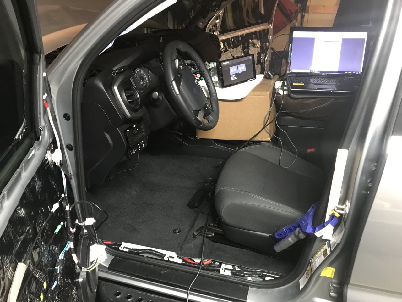

    690ADC3A-7273-40AA-9DD7-0021BFB52559.jpg I was able to get the transfer button on the app to engage, but the software won’t transfer. :frusty:
