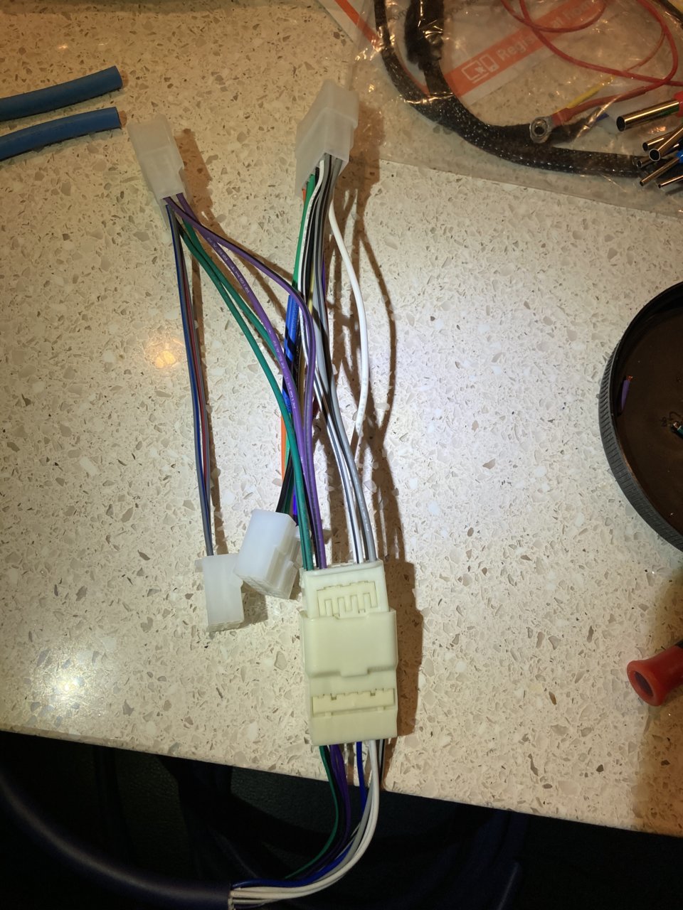

    I keep reading people saying you need to splice your rca cables to the pioneer harness. This may be a dumb question but which rca cables need to be splice? And to which wires in the pioneer harness do they need to be spliced to?

    The wiring of the maestro T01 harness call for you to cut the T01 L/R Front speaker RCA connectors and wire them into the Pioneer harness.
