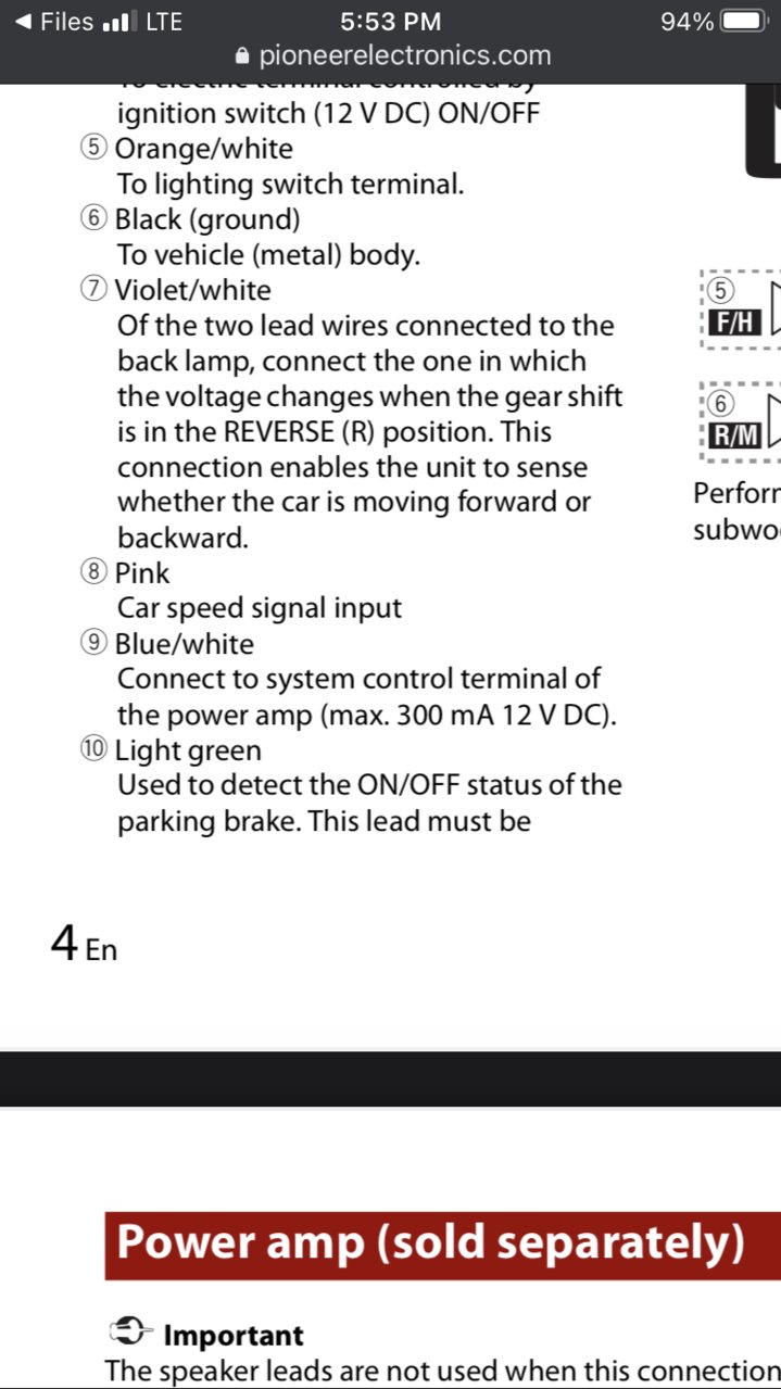

    yes. This is the headunit amp turnon wire. It will carry upto 10 amps of turn on with your head unit.

    Woah, spec’d at 10 amps? Nuts. I thought it was lower.
    EDIT, you are the man but would you mind citing a source on that one? I just dug this up (on my phone in the minivan so hard to read big pdf’s but this matches what I remember.)

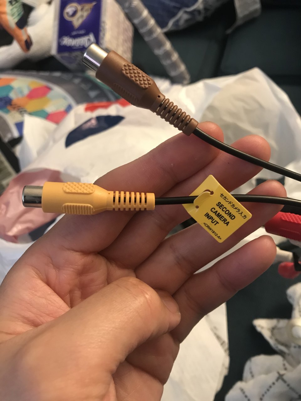

    This is frustrating, what am I doing wrong ?So I tapped into the amp wire and plugged it into the labeled secondary camera. But cannot get the front camera to pull up. The camera worked this morning so I doubt the camera is bad. Any help would be greatly appreciated.

    There are two power wires for that camera more or less. Make sure they're spliced in correctly. Since you're pulling power off the remote turn on you can just splice both power wires into that.

    Ohhhh that’s right, I totally forgot about the other wire...I’ll give it a try tomorrow. I tucked it away so well I forgot about it. Thanks

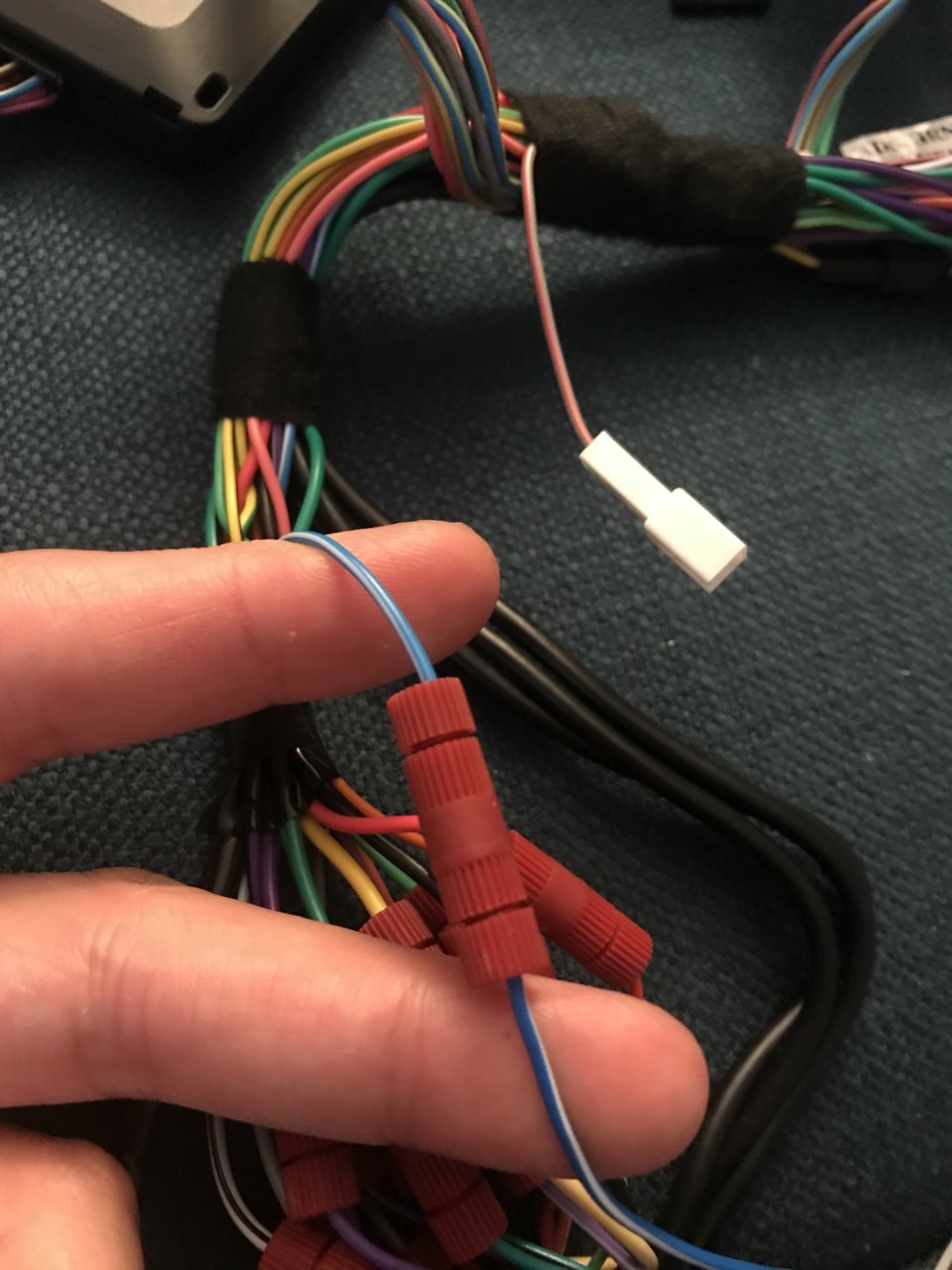

    You keep the T harnesses for the Germes to the OEM harnesses which exist. But one will not. It’s a square connector which plugs in just to tap power for the Germes when the head unit is on. You cut that guy off and tap the red to the blue / white remote out and the black to ground.
    I did mine using bullets so I could return to stock head unit in the future if I wanted to. Which is really rather silly because I can’t ever see doing that. This piece is wrapped in very sticky foam so the hardest part is removing enough of that stuff to crimp a connection.

    You are correct about the AMP wire (300mv). I use that signal for a number of devices. I hooked mine up to a relay and a buss block with a 10amp fuse on the vehicle power side. This way, I know I will not be over driving the AMP On signal line.
