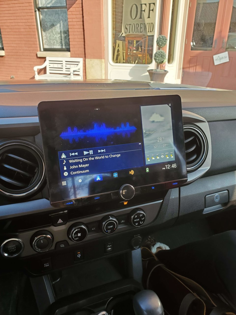

    My wife knew I have been researching head units on crutchfield and decided to splurge and got me this monstrosity for Christmas. It's bigger than I expected, but it grows on you. Installation was a breeze if you take your time. The thing sounds and looks great!
    NIU_Huskies likes this.

    That's real nice. Does she have a sister?? I have it sitting in my cart, but I'm not ready to pull the trigger yet.

    Does it have phone mirroring or an HDMI in? I can't remember when I was researching. I also really like the volume knob. And I want say it controlled other things as well.

    It has wireless mirroring and an HDMI port. While I am not using the HDMI, it's pretty cool: It is actually recessed in the back of the unit with a plate that locks in in place (so there is no worries of it coming loose).
    The wireless android auto has been working flawlessly, as well.
