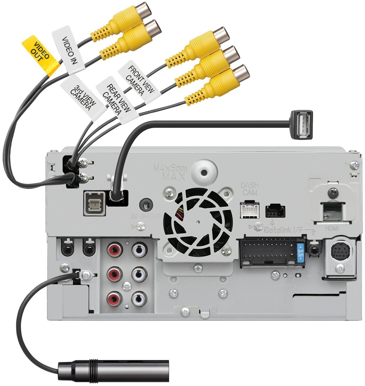

    can you elaborate on the plate that holds the HDMI in place? I have an HDMI on mine run to my center console, but I don’t remember a plate.

    If you look t the right (on the backside of the head unit), you can see a single phillips head screw holding the plate in place. Once you remove this, the HDMI plugs in, into the recessed area, and you replace the plate. It holds the HDMI plug into place securely.
