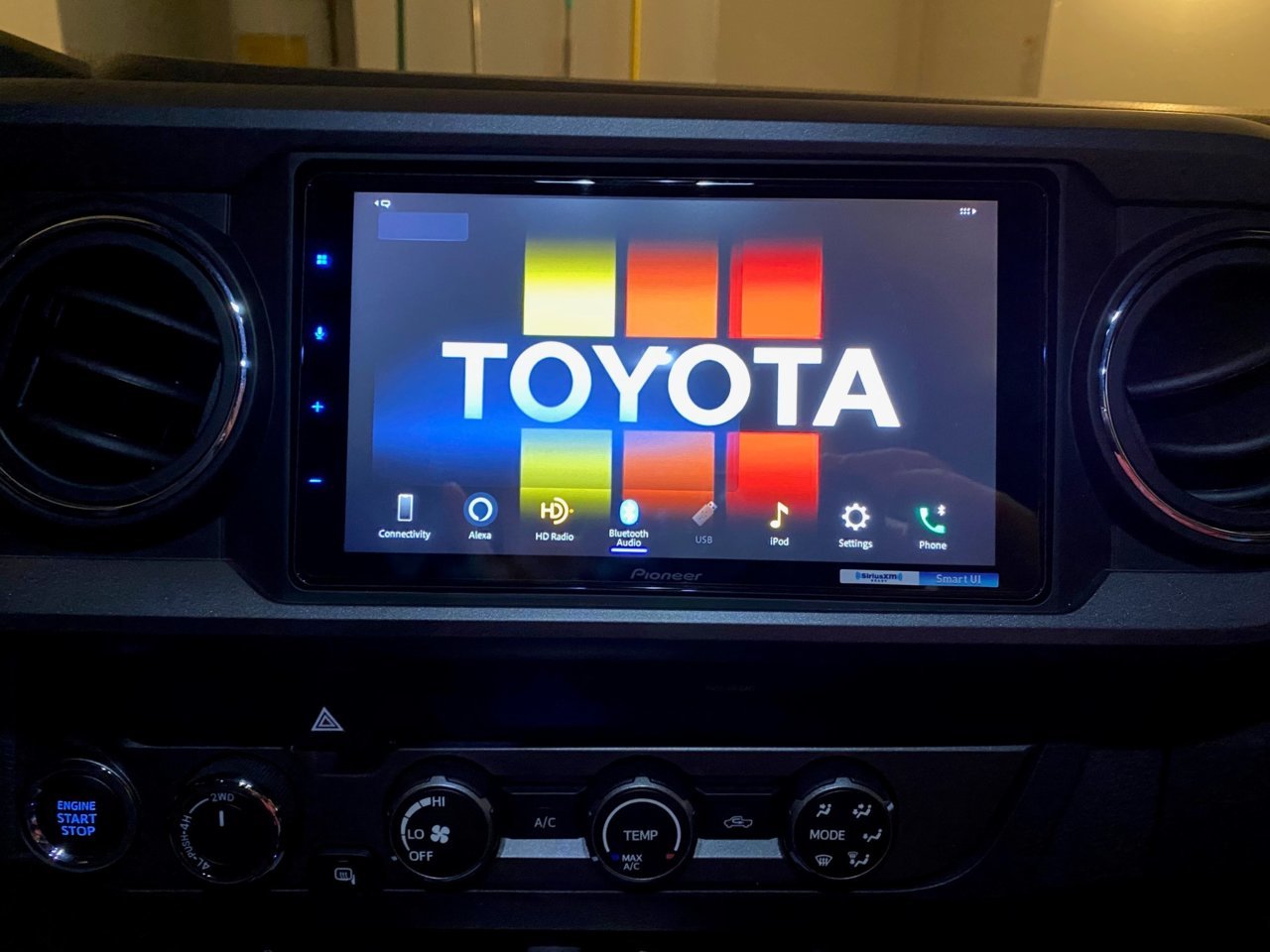

    This thread is the epitome of this community. People doing work and sharing their experiences with others so the same mistakes are not replicated. The information here is unparalleled and definitely head and shoulders above any other forum.
    @PreRunnerSeth - thanks for being the first to get this thing kicked off. This head unit was made for this truck and has added so much value to my daily commute. Great work on this bro!
    @Ch78 - the consolidated parts list is CLUTCH. Went off that list exactly and it was perfect!
    @CoAlpha - completely knocked off your vintage Toyota wallpaper
    @svermilyea - the step by step on how to connect carAVassist was super helpful, I spent hours trying to get that up and running!
    My Buying Experience:
    If you have an AMEX platinum, I recommend adding the Best Buy promotion to your card. That gives you $50 back on purchases $50 or more up to 2 times. You can also use your points to pay and the exchange rate is pretty good.
    6600 head unit $773.99 open box, got additional $50 off from AMEX and used $300 in points. Also includes free install. They installed everything including Maestro, GPS, camera, mic, satellite for FREE. They also throw in the Sirius SXV300V1 adapter for free when you buy the head unit from them.
    Maestro RR from Ebay - cost $102 after tax and shipping
    iDatalink Factory integration adapter $59.99 from Best Buy - $50 AMEX promotion (did as separate transaction from head unit) = $10.72
    Then bought everything else on Amazon using Mastercard CC points
    All installed and out the door, my out of pocket was about $600.
    I know this is a very unique way of doing it based on whether you have these offers and CC points available, but wanted to share this with you guys in case anyone wants to replicate it. Thank you to all who have contributed here!

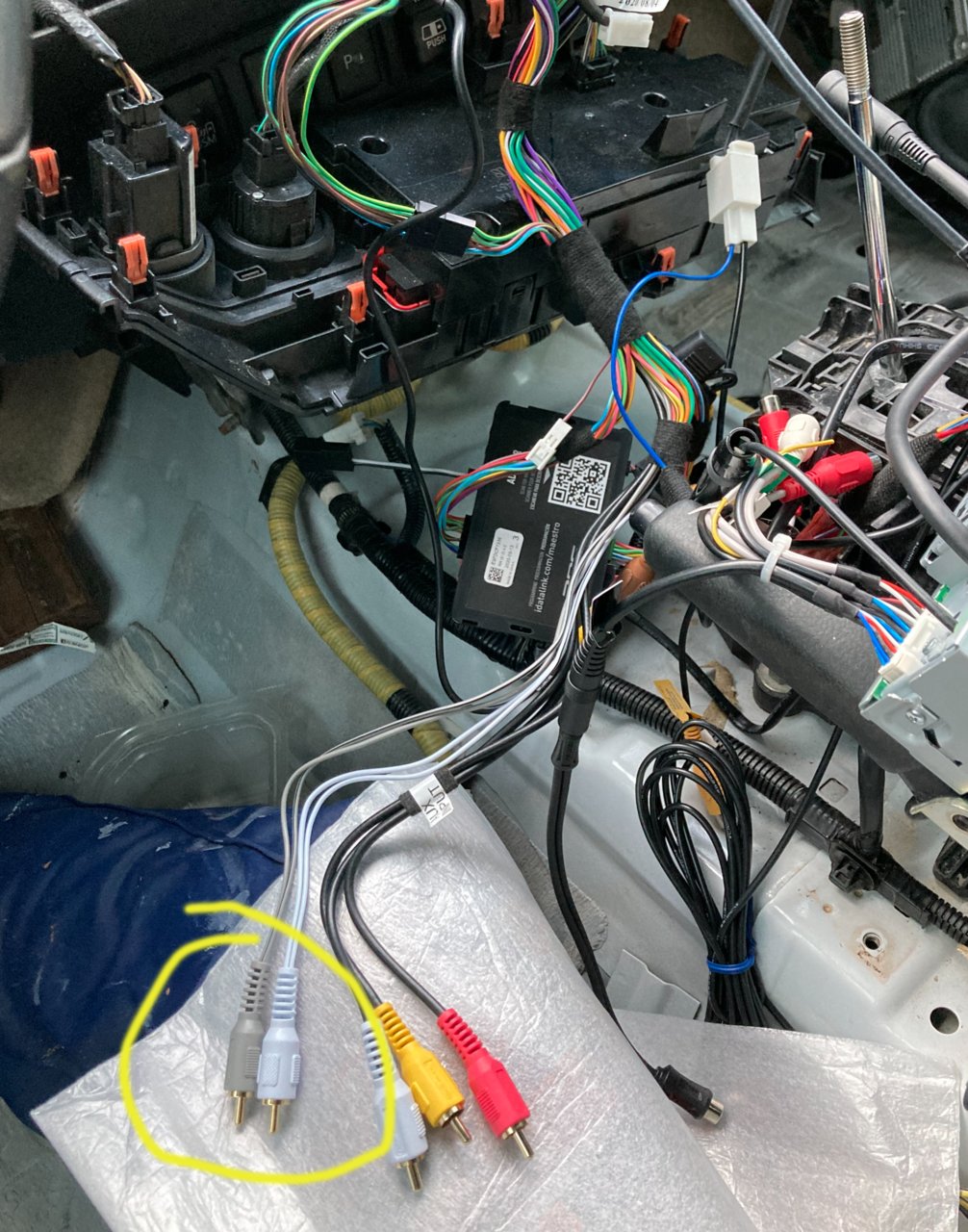

    also anyone knows what this gray and white cords are for? i circled them in yellow. trying to make right connections and getting lost a bit.
    also the way i understand it speakers have to be wired manually to rca white/red connectors coming from pioneerScreen Shot 2021-02-14 at 5.14.18 PM.jpg ?

    They’re the lines for your speakers,has to be cut, stripped and connected to the maestro Toyota harness, if you’re using maestro.
    Check the installation manual/ diagram

    Had Crutchfield prewire the kit
    So not sure what to connect these to

    If my memory serves me right, the maestro and the maestro harness (assuming crutchfield used the maestro harness kit) for your pu model the harness is color coded to match each wire of the pioneer harness. It’s pretty straight forward.

    I resisted commenting on this however here goes:
    1. Premium Entune or JBL Entune from the factory?
    2. Assuming Premium Entune, as previously stated by @Caliasada Taco, the wiring is almost completely color matched. If it is Premium Entune, the gray RCAs should have been cut and patched into the pioneer harness. If it is JBL Entune, then you have other situations to be addressed.

    I just plugged the gray and white into the front speakers from the pioneer harness on the back of the stereo. I bought the prewired harness from Crutchfield. I have the JBL Entune system.
