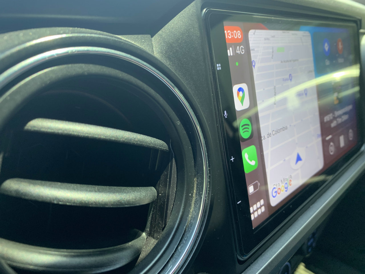

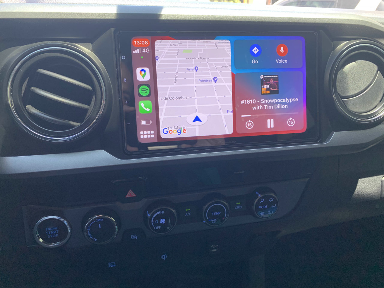

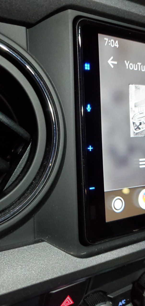

    Hello
    This is my first post, and I decided to do it here in order to thank all the people in this thread who have contributed with info regarding this headunit.
    This is my second Tacoma - is a 2016 double cab TRD Sport - my first Tacoma is a TRD SR5 Access Cab from 2007.
    Long story short, I did not like the OEM system on my Taco, so I searched and was decided to get the Alpine Halo 9, until I saw this post, and also read all the bad reviews on the Alpine.
    I went straight to Crutchfield, and they helped me get everything I needed. Then downloaded all the info and installation guide, gave it to my local technician and he did the magic.
    Btw I´m writing from South America.

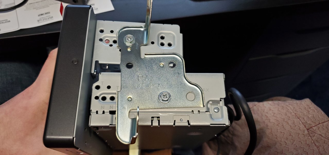

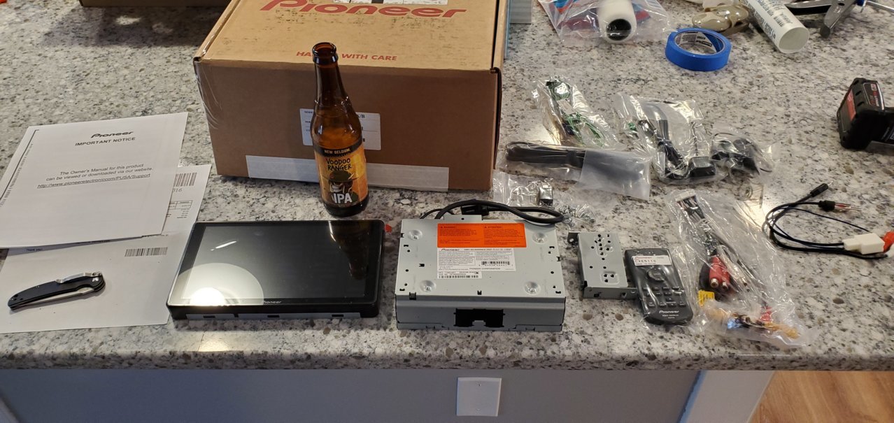

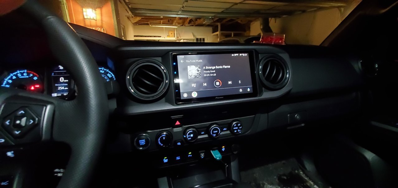

    Install turned out pretty good. Gotta go back during daylight and route microphone and GPS. Think I have a wrong cable for factory USB integration too. Not sure what I need rca female to 3.5mm male cable for yet.
    This is how I put the brackets on. I should probably get a third screw somewhere but we will see how it ends up. Some velcro on bottom touch screen to stop vibration.
    Lots of wires. Took me a good hour to actually understand how everything worked together. I've never installed with the Maestro thingy before. I just used butt connectors for joining wires.
    It was getting late and I didn't want to miss dinner so no pictures of actually installing. Pretty straightforward though.
    This is how it looked without messing with fitment at all. Pretty decent.
