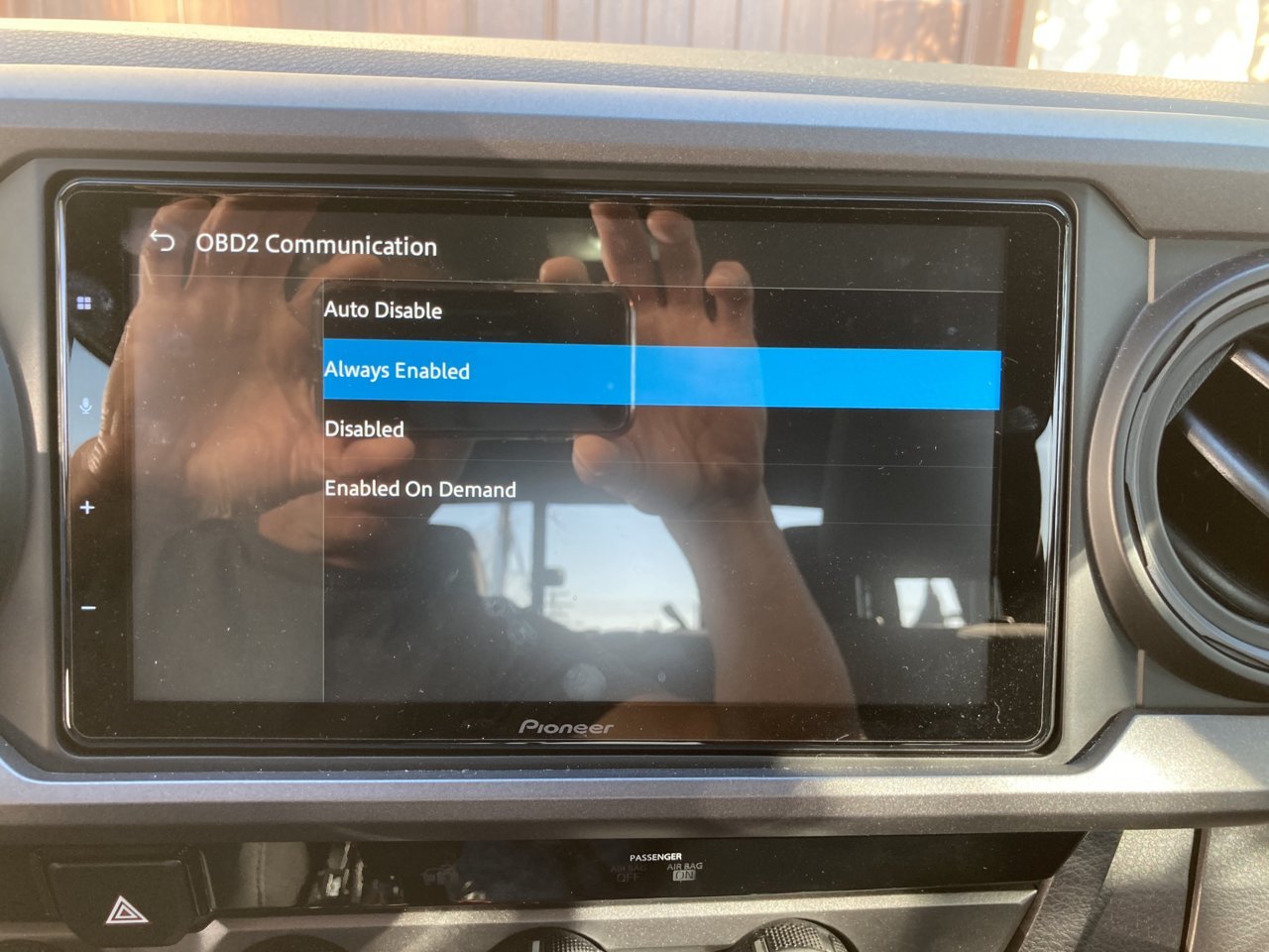

    Head unit successfully installed (shout out to @daveeasa for all of his help with my speaker noise and front camera issue). Also, thank you to everyone on this thread as it was beyond helpful in preparing for the purchase and install.
    So far the HU is awesome and have been learning the functions and configurations. I do have a few questions. I did read back through the thread looking for like issues so my apologies if I missed something already mentioned.
    *Each time I fire up the truck and unit the wifi will not connect. I have to disable/enable the personal hotspot on the phone then select the phone on the wifi screen on the HU. I did see where someone else was having the issue but it seemed like it was more of a deal where he hadn't connected to the radio for some time. Example this morning I grabbed a coffee came back out and had to go through the process.

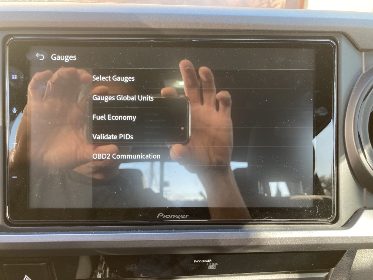

    *My Vehicle only the top two options are available (gauge and vehicle) the bottom two are greyed out
    *System\Oem settings most sub settings unavailable

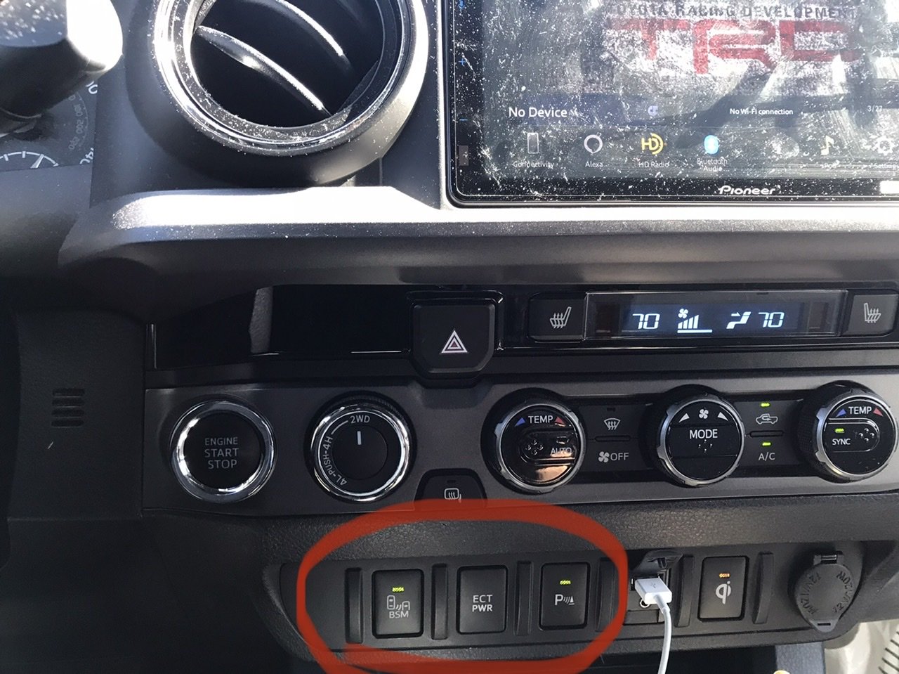

    *No beeping when in reverse as cars are approaching from sides and or I'm getting close to an object directly behind (I think this is parking assist but not sure)
    If this is normal and features that don't come along with the HU and Maestro I'm good just want to make sure that's the case and not something I missed during setup and installation.
  5. Mar 27, 2021 at 10:04 AM
    #1485
    daveeasa
    daveeasa FBC Harness Solutions
    May 14, 2020
    #328079
    7,465
    David
    PNW
    2016 Tacoma OR DCSB 6MT, 2005 RC 5MT PreRunner, 2002 Tundra SR5 RCLB 4x4
    Check to make sure odb comms enabled. And also delete your phone and re pair it to rule out trouble there.
    F1B9EBE5-95DF-4394-8878-B6B471882196.jpg 7BAC3FFC-3249-4CE5-9E26-B67EA2A40BB7.jpg
    always enabled or auto disable should work. Also you want to make sure it’s disabled or auto disabled before using tech stream to flash ECU or program stuff. See the ECU thread for the details.

    If your taco is equipped with rear sensors then the beeping should work like factory with the pioneer head unit and maestro RR or Rr2.
    I might be wrong but the back up sensor operates on its own even without the head unit, minus the reverse camera video. Maybe check if your bSm and parking assist button are on
  8. Mar 27, 2021 at 1:27 PM
    #1488
    horntac1
    horntac1 Well-Known Member
    May 5, 2019
    #292309
    295
    Comms are enabled as I am receiving some of the data components just missing a lot of them. I have also completely disabled wifi on the truck and phone then reconfigured.
    iPhone has latest updates. Matter of fact it installed one the past week.
    Where would these buttons be located? On the truck, HU or Maestro?

  10. Mar 27, 2021 at 7:10 PM
    #1490
    horntac1
    May 5, 2019
    #292309
    295
    Ah yes that button ;) Yes it is on. I did turn it on and off as sometimes I need to do that because it will just stop sensing cars next to me. Unfortunately no dice.

    I have a question specifically about the gauges. I don't have readings for transmission temp, and other gauges. They're just greyed out. The OBDII plug is plugged in to the truck and the harness according to the wiring diagram for the maestro. Not sure what else to do.
