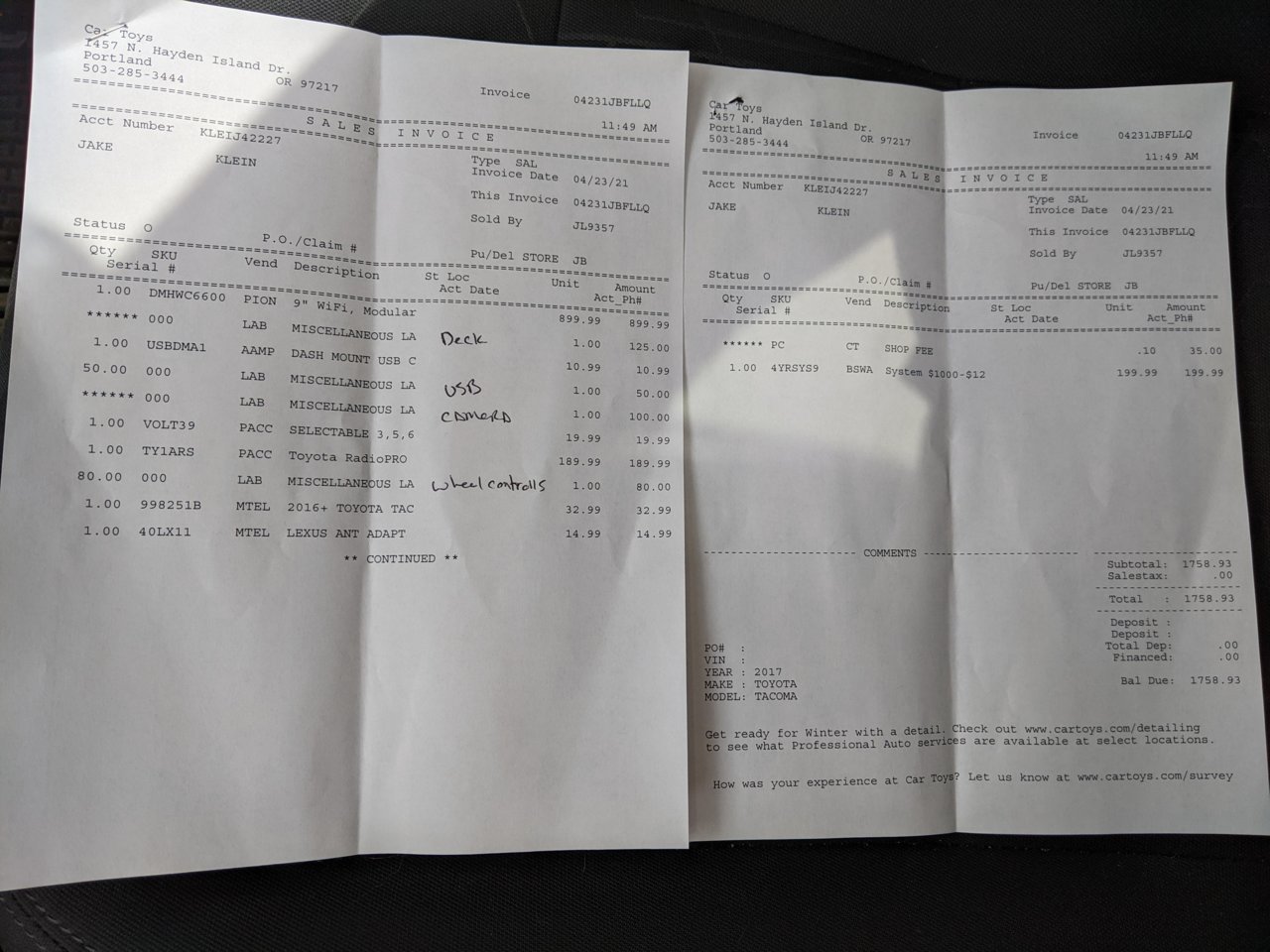

    Does this seem like a good deal? I feel like they padded the invoice with unnecessary extras, but maybe someone with experience of buying one at a stereo shop and having them install it can chime in.

    Cool stuff
    Stay away from that

    2019 TRD OR 4x4 DBSB A/T
    There is a list of what is needed on one of these threads. Use that and only that.

    3in leveling lift (Coilovers and AAL) 285/65R18 tires 18" Fuel wheel/tire package Pro Grill, Morimoto XB LED Headlights, DD SS3 Pro Fogs Body Armor Front and Rear Bumpers Pioneer WC6600 head unit w/ OEM Audio + Reference 500 System with dedicated sub amp Meso signal lights, gas hole, led interior lights, ECT relocate, Chrome delete kits Meso Overhead Molle Rack, Seat Risers, Katzkin Leather seats (self installed...it was a fucking bitch) VFTuned .....KDMax Pro!
    Your parts should run you no more than $1250 shipped. Your shopping list is in post #335
    I corrected the parts list post: #335 The dash mount kit is optional if you are willing to modify your existing radio mounts (not difficult).
