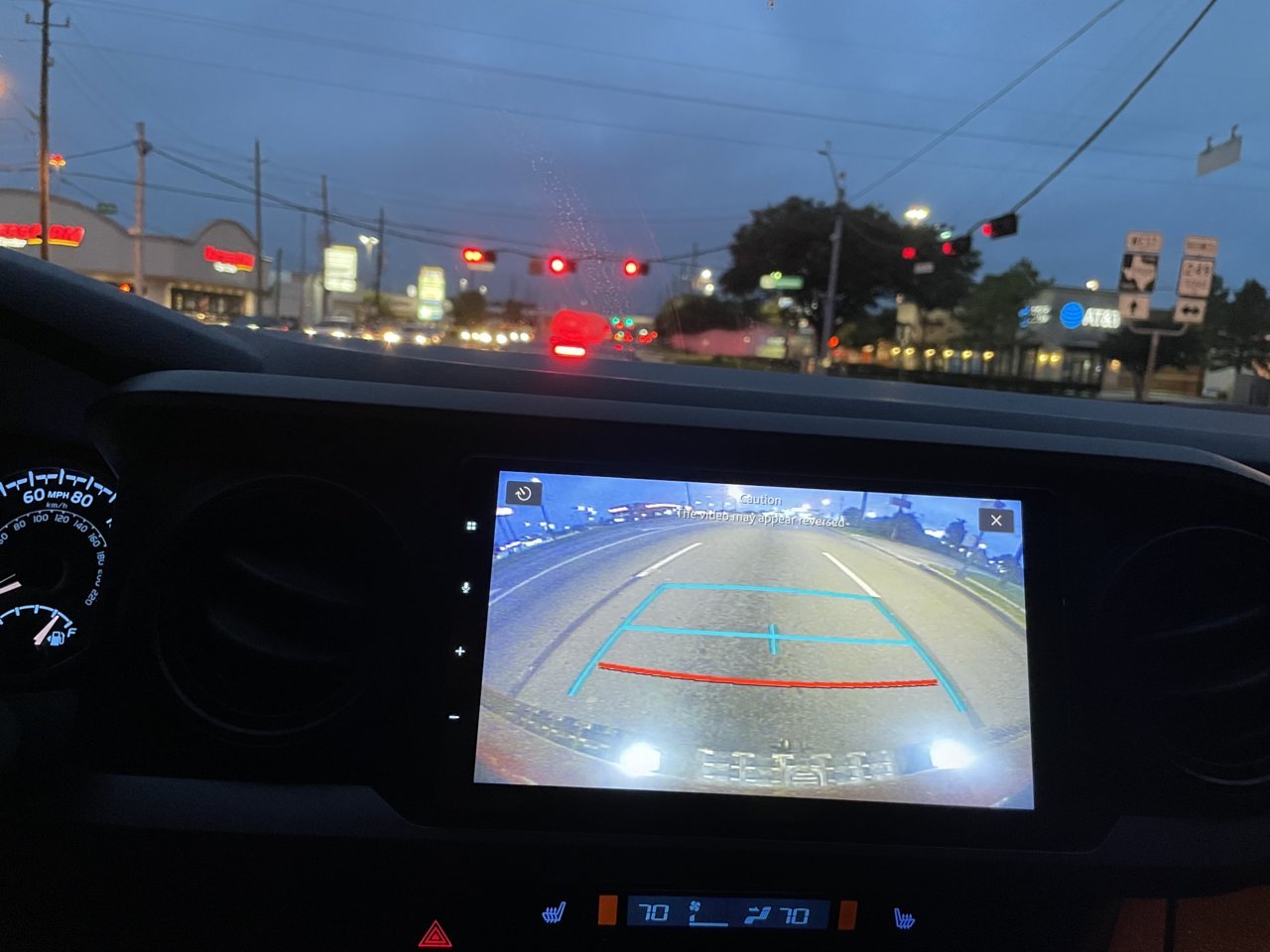

    Which unit do you have? If it’s any of the NEX HU’s you’ll be able to see the rear camera as long as you every thing hooked up correctly.

    I think the feature being discussed is the ability to show the rear camera while not in reverse?

    Yes, I want to be able to turn the rear camera on to check my trailer connections when I’m driving. It’s also handy to know whether I’m far enough into my garage to clear the door while still allowing me to use my workbench.

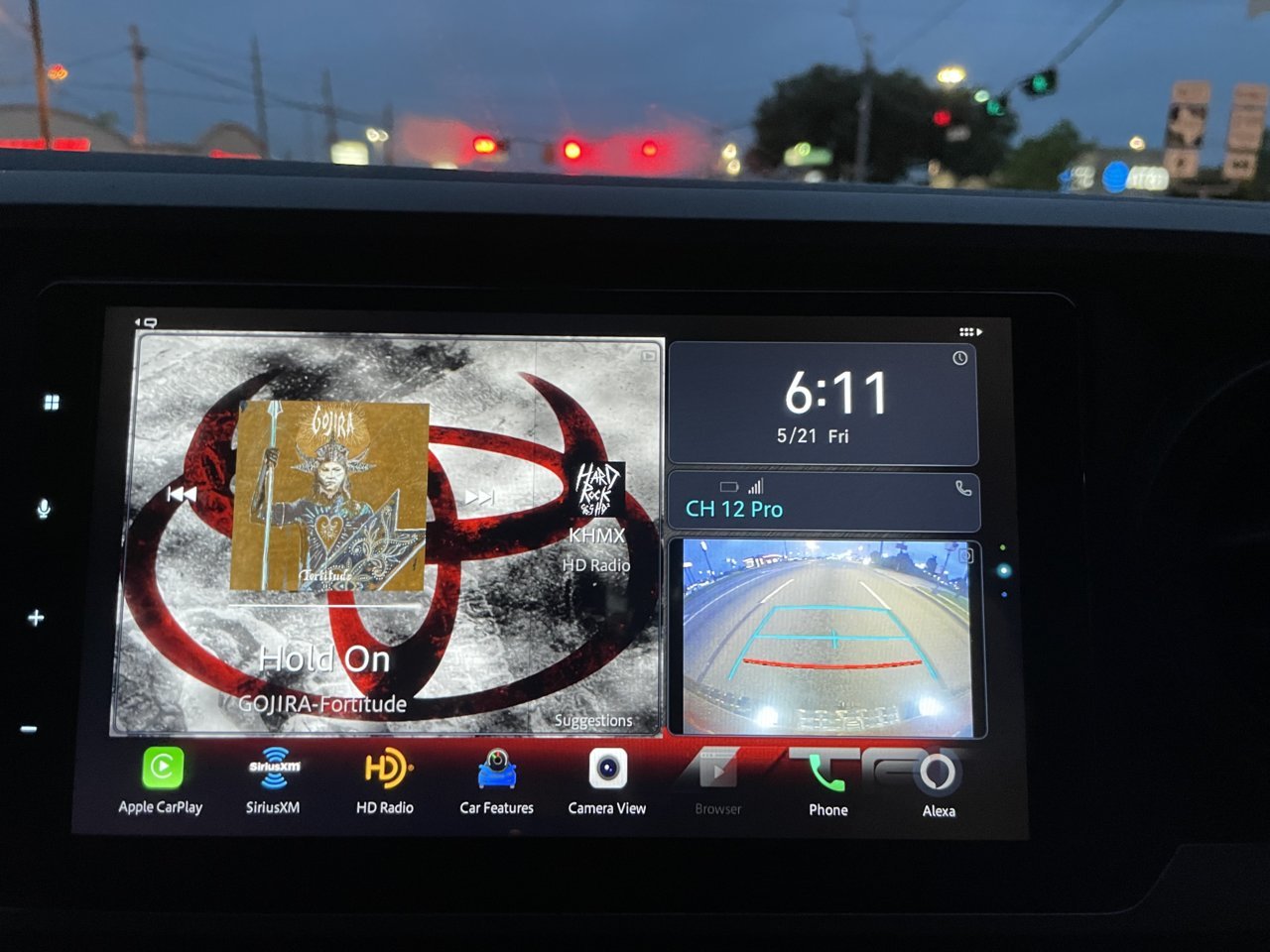

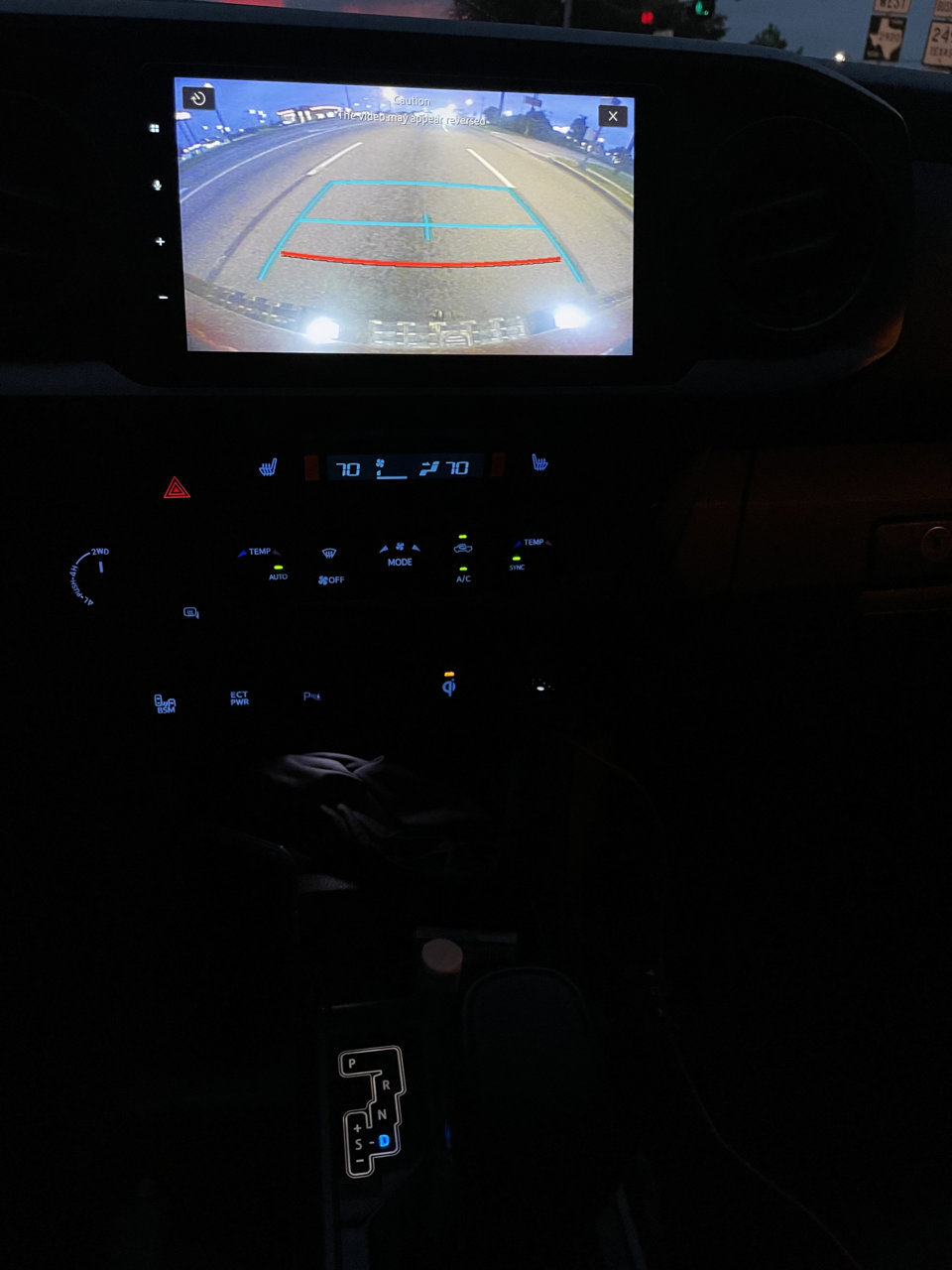

    Right, like this? You can see I’m in Drive in the last pic.

    That’s awesome! Didn’t realize that was a feature in the widgets.

    yeah, with it in the widgets I can just press it and it pops up to full screen. Click the x on the top right and it’s back minimized.
