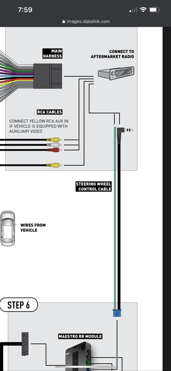

    I saw someone say the steering wheel control harness is not used in this application? Any confirmation? B4A228FF-CD26-42F5-9A28-BDC302EB52D8.jpg

    Doesn’t look like it.

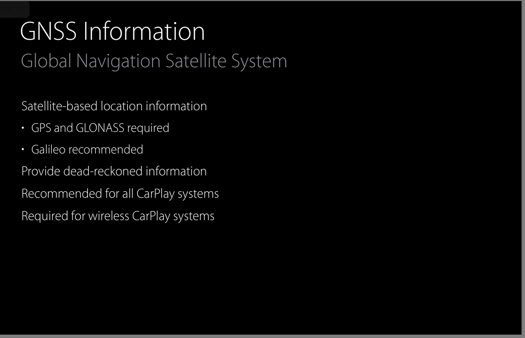

    I finally was able to get everything installed! This is an awesome unit, and im excited to check out more of the features. I am having an issue that I can't seem to resolve and I'm looking for some input from y'all.
    Issue: Cannot use wireless Apple CarPlay. I get an error that says something along the lines of "the GPS cable must be connected to use wireless CarPlay". Its essentially the VSS error that folks receive but calling out GPS rather than VSS.
    I can use wired CarPlay, but if I disconnect it will not work.
    Steps taken to resolve: I have updated to the latest firmware. I receive the error before and after the software bypass. I have triple checked all connections. I have attempted with the t02 adapter, and with the pioneer provided gps antenna both receive the same error. I currently have the unit wired with the maestro and the anytime backup camera harness.
    Any suggestions would be awesome! Thank you!

    Trying to help even though I have Android auto. So when you plug in your phone to your head unit, I'm guessing it switches to using your phones gps. I know you said that you triple checked connections, but did you try swapping the GPS connector with the sat radio connector?
