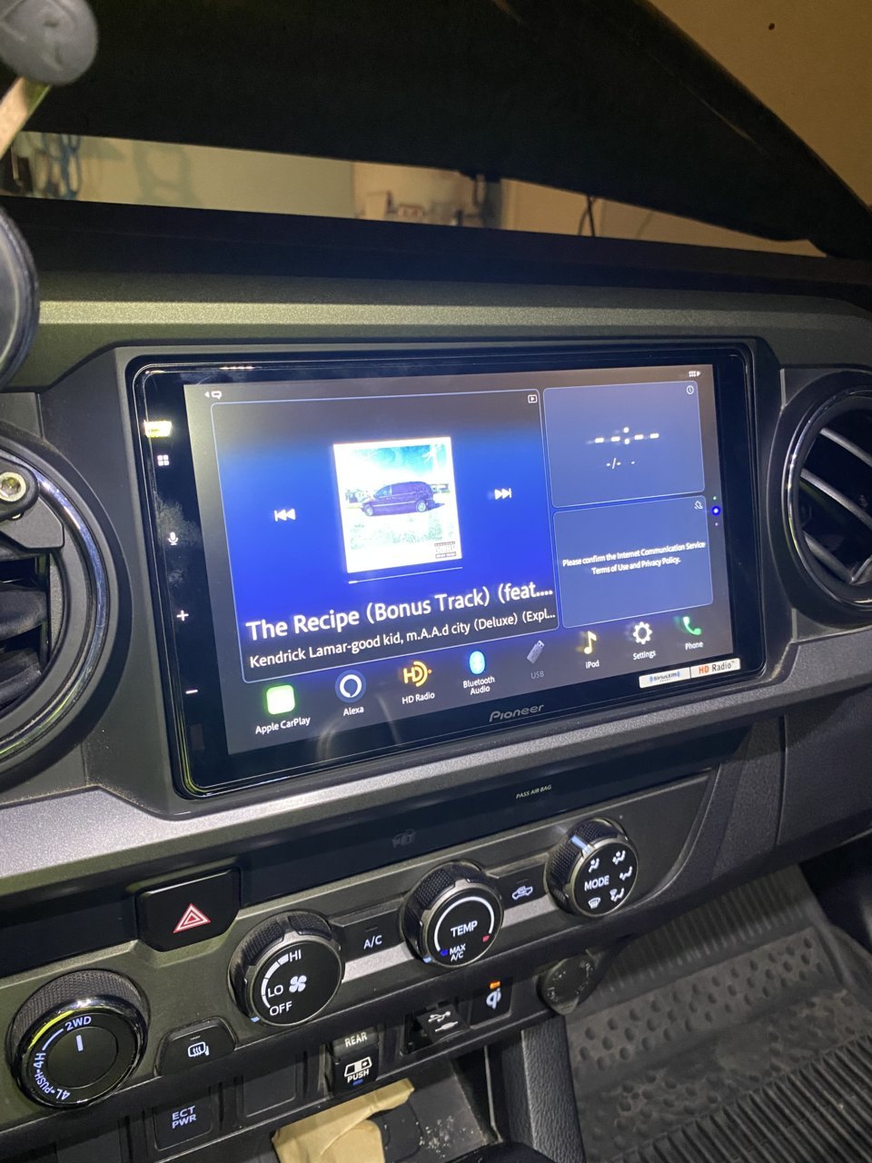

    7C9757DF-E195-41AB-9BD2-ADE461E86233.jpg Was able to get my headunit installed today. Still have a few things to work out. I can here video but I’m not see it so need to see what’s going on with that, need to get mic installed, front camera finished up, usb connected and get Navi antenna in a permanent spot.
