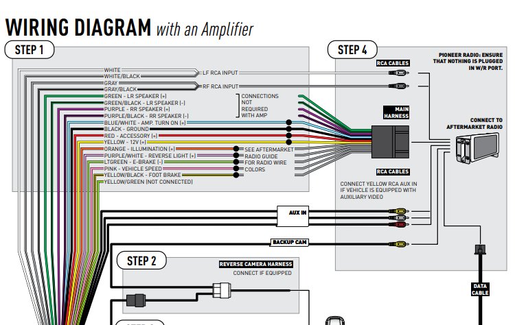

    Hey, did anyone take a picture of the wiring they did? I am a little confused about where LF RCA INPUT and RF RCA INPUT are supposed to go. I have a 2019 TRD Pro with JBL.
