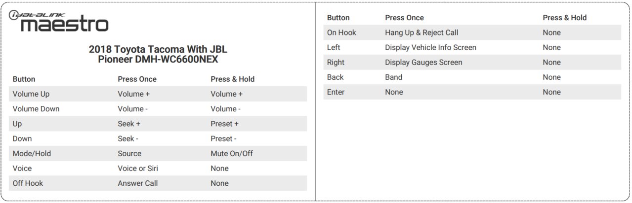

    I finally have this thing in the dash!
    I would like to publicly thank @daveeasa and @svermilyea for all of their guidance in getting my Germes camera setup working. Very much appreciated.
    I haven't had much time to go through the settings, but I did notice this... when I am on a call and I press UP or DWN (not volume up/down) it hangs up. Using Android, and tested this with Android Auto as well just through the Pioneer interface. It hangs up in both of those instances. Has anyone else noticed something like that?
    Here is my wallet card:
    daveeasa likes this.
