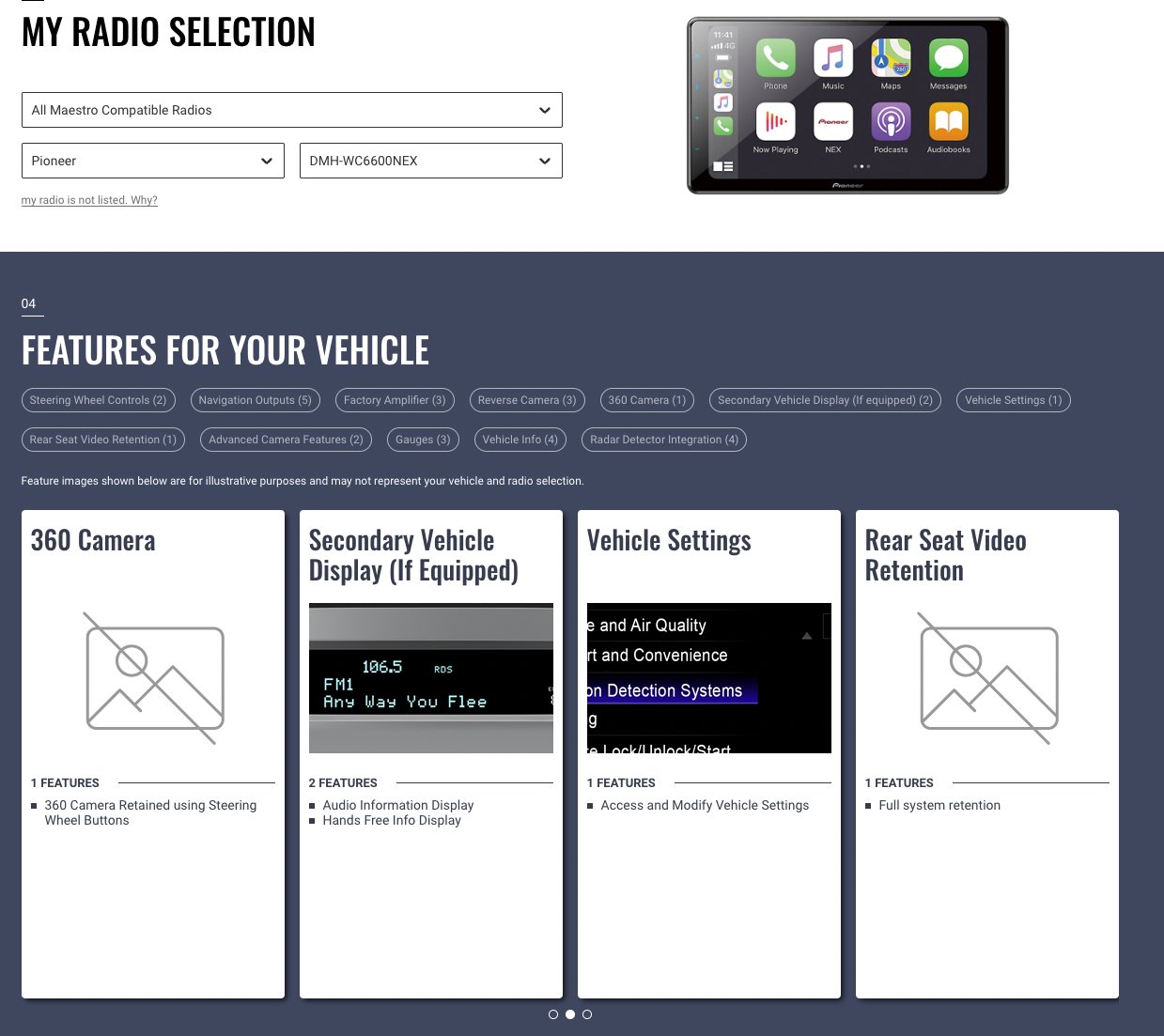

    Pulled this from iDataLink's website. Looks like they recently made some software updates. The site will allow you to select your vehicle (JBL or non) and then select the head unit to view available features.
    Hope this helps. (source)

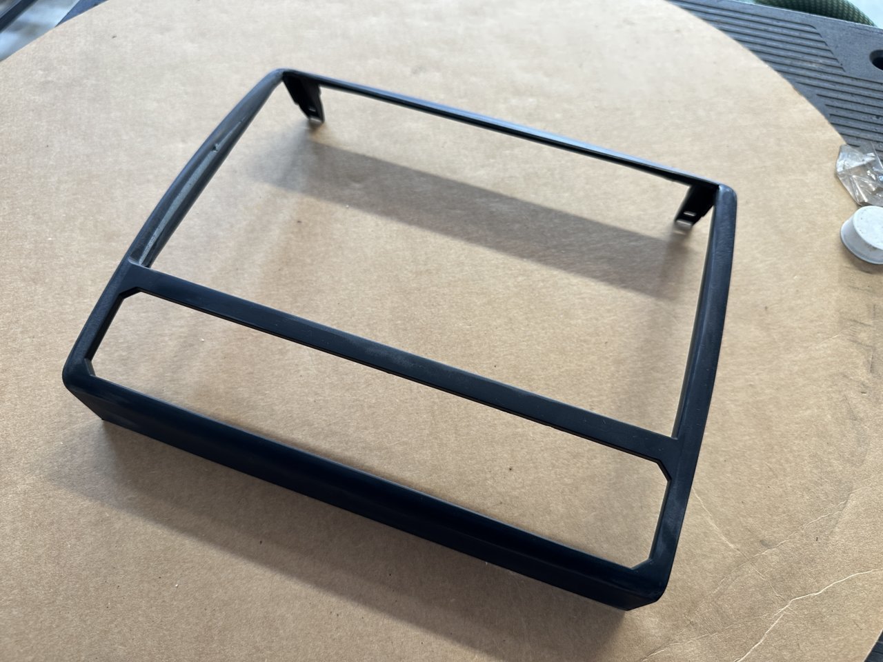

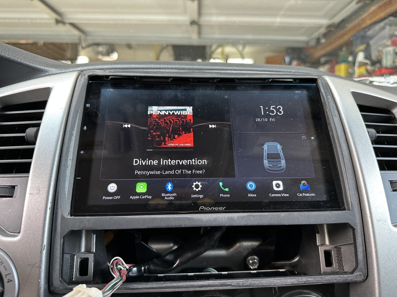

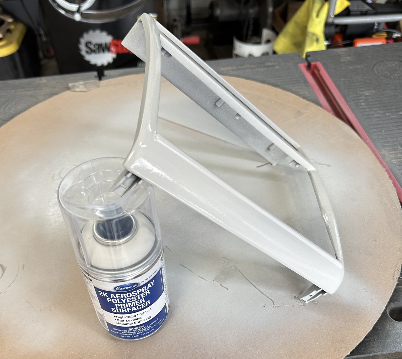

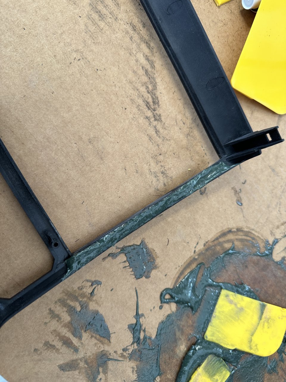

    I just finished the bezel for mine on my 2nd Gen. I used the kit for the 5500 and cut the opening larger for the 9in screen. One problem was that the left side buttons were hard to press because of how close they were to the inner edge of the bezel. I re-contoured the edge to give better access.

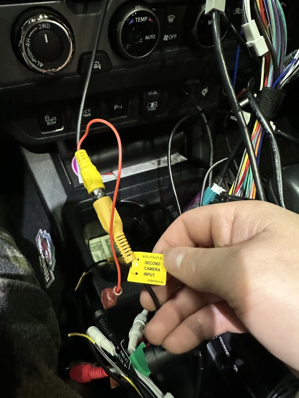

    Hey guys just installed dmh-wc6600nex only issues I’m having
    1.front camera won’t activate. I had the germes lab installed before but removed it. So all I had was the rca male with a positive pigtail. I tried tapping into the to2 harness red accessory with no luck.
    t
    2. OEM reverse camera looks horrible on 6600nex. Any tips on making the picture clearer.

    Replace the Germes and power it from either poutlet1 or the blue remote output wire and a factory ground. Works great w this unit, just need to cut and source power since no nav T to steal it.

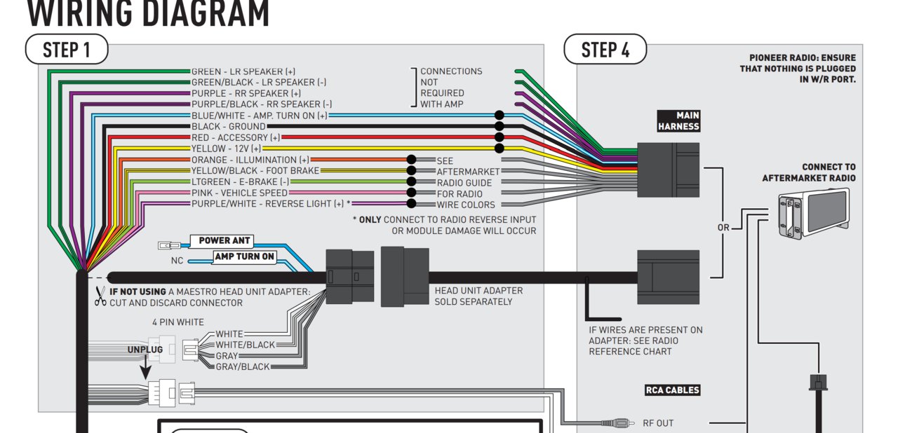

    any way you can tell me the best wire to tap on the diagram. wire diagram.jpg

    If you are only powering the front camera, you can use the AMP TURNON (blue with white stripe) on the T02 harness to power the GERMS unit.
    If you are bypassing the GeERMS unit (not using it), you power the camera from the same AMP TURNON wire, but you will also have to go into the head unit settings and enable a second camera. Every time you want to use that camera, you will need to enable it from the head unit camera shortcut.

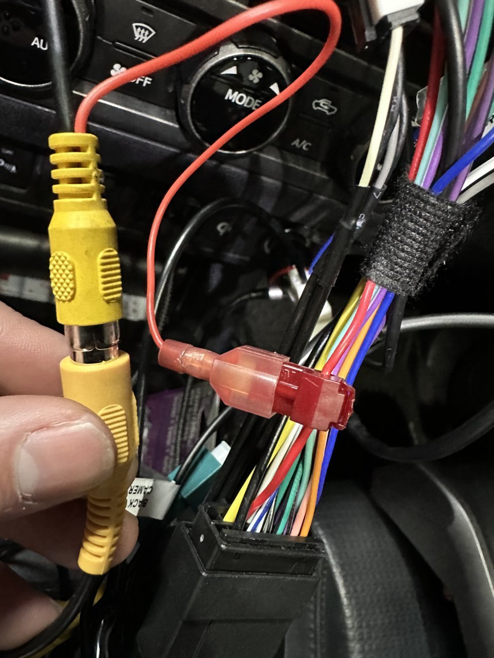

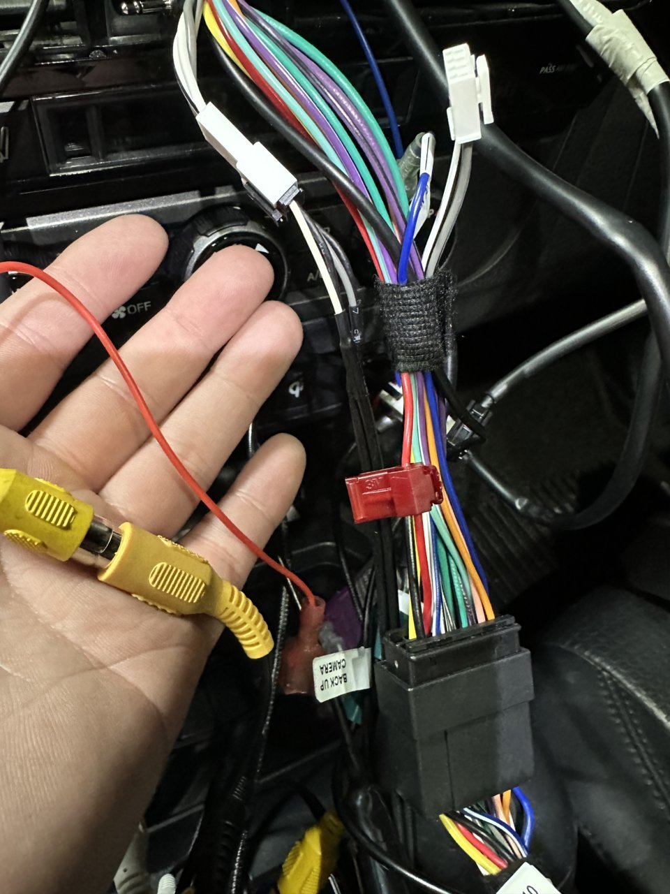

    Thanks guys I got it. Was just a grounded wire that needed to be connected. I guess the germes didn’t need to be connected when I installed it years ago. I actually tapped the red accessory wire. But now front camera won’t trigger with the assign hold on call button. May just reflash and try a different front camera activation. Rear camera hold on hang up button works just not front.
