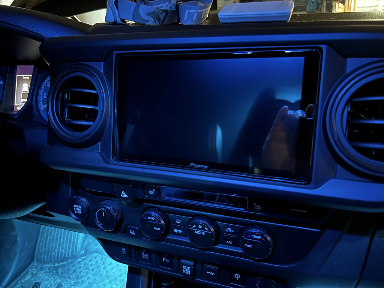

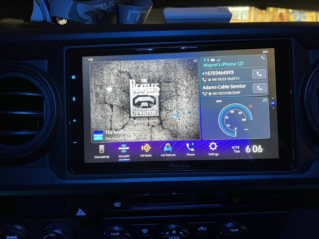

    Yep got the rear, front and side cameras working.
    Ans she is installed.

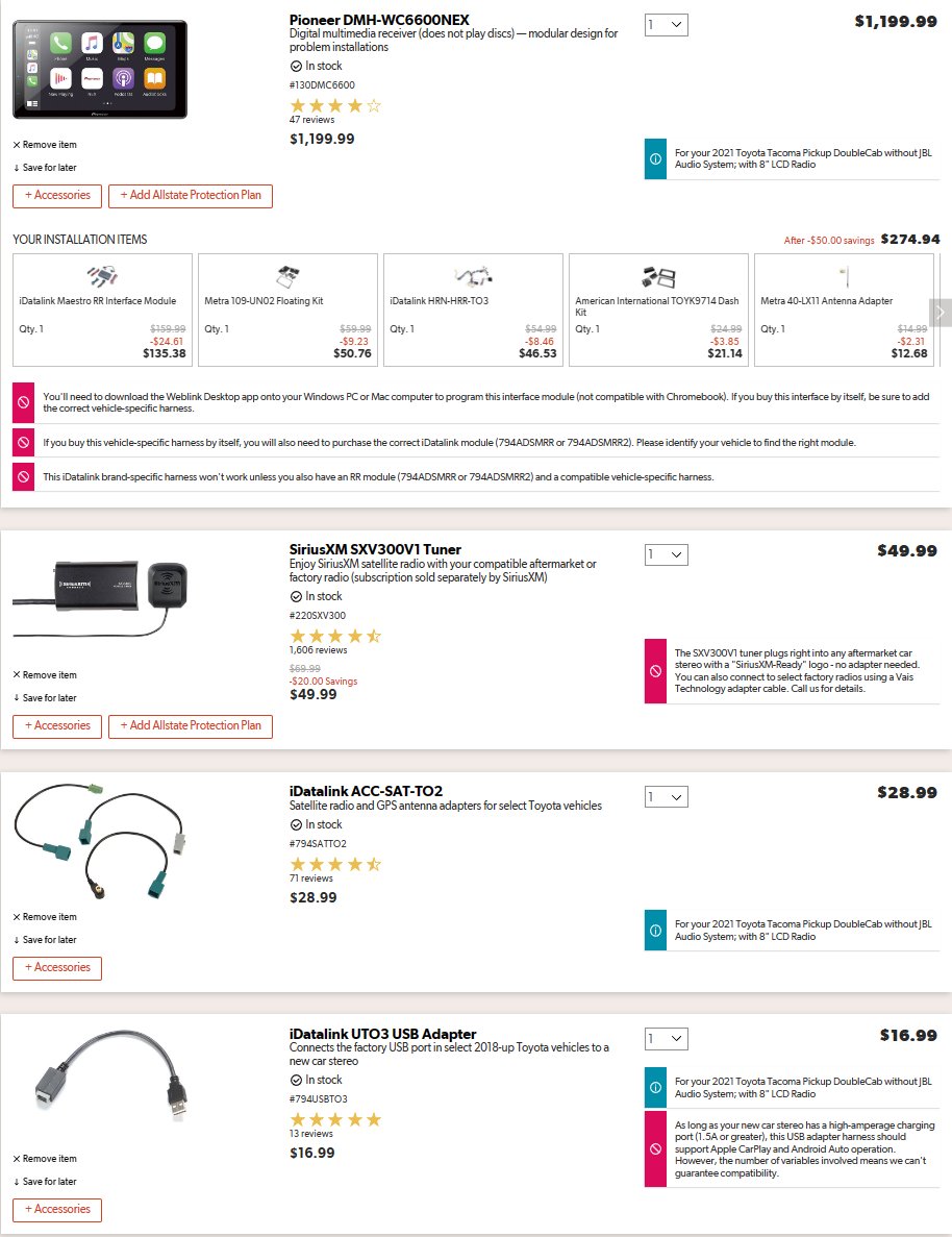

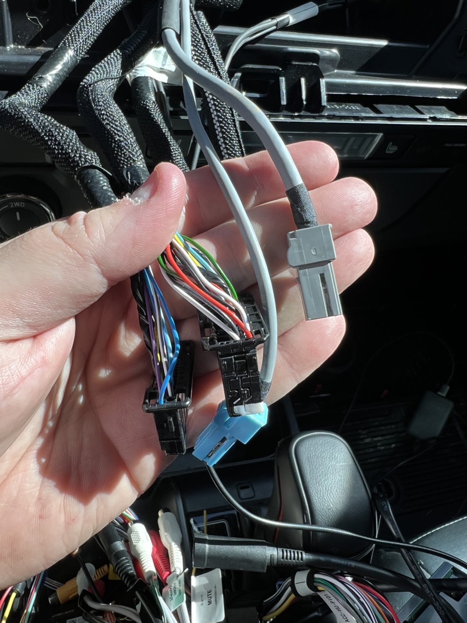

    So I started the install today and after what I thought was a good connection on everything... I have the dreaded connectors left over.
    I assume the grey is for the USB (and AX-TOYUSB doesn't fit but anyway) but the rest look.. important. EDIT: So I've narrowed 3 of the 4 down: the long thin black connector goes to the factory nav as does the light blue connector. I'm not sure what these actually connect to -- compass perhaps -- but my functionality seems fine. The light grey connector is the USB. I'm not sure what the last longer black connector is. Oh, one of these is probably HomeLink? I never considered that I might lose HomeLink.
    Any idea what I've missed?

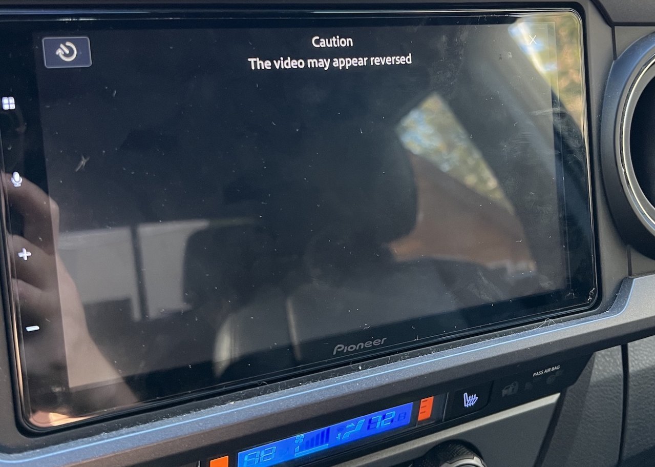

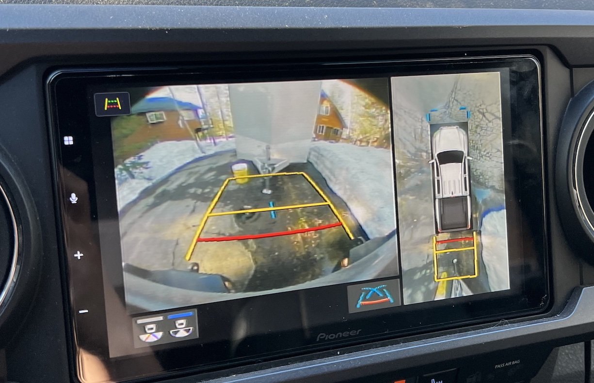

    My 360 camera is also acting weird. When I hit "camera view" it shows black:
    But when I'm in reverse it shows the reverse camera and the 360 view:
    The manual explicitly says "Camera controls (with vehicle in reverse)" for the 360 camera... does it really only let you use the front camera and 360 if the vehicle is in reverse?

    Yea that USB adapter seems to be for older Tacoma's. I ran into the same issue. So I ordered the iDatalink UTO3 ACC-USB-TO3 from Crutchfield and it worked perfectly.
    cowfootball[QUOTED] likes this.

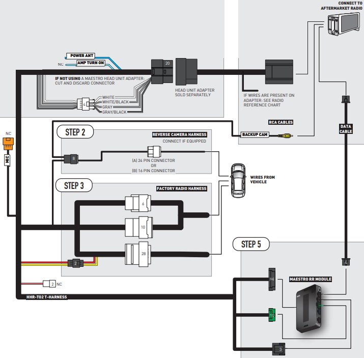

    Anyone know what the black 28 pin connector is? I don’t see a place to connect it on the maestro unit.
    What about the single wire blue connector?
